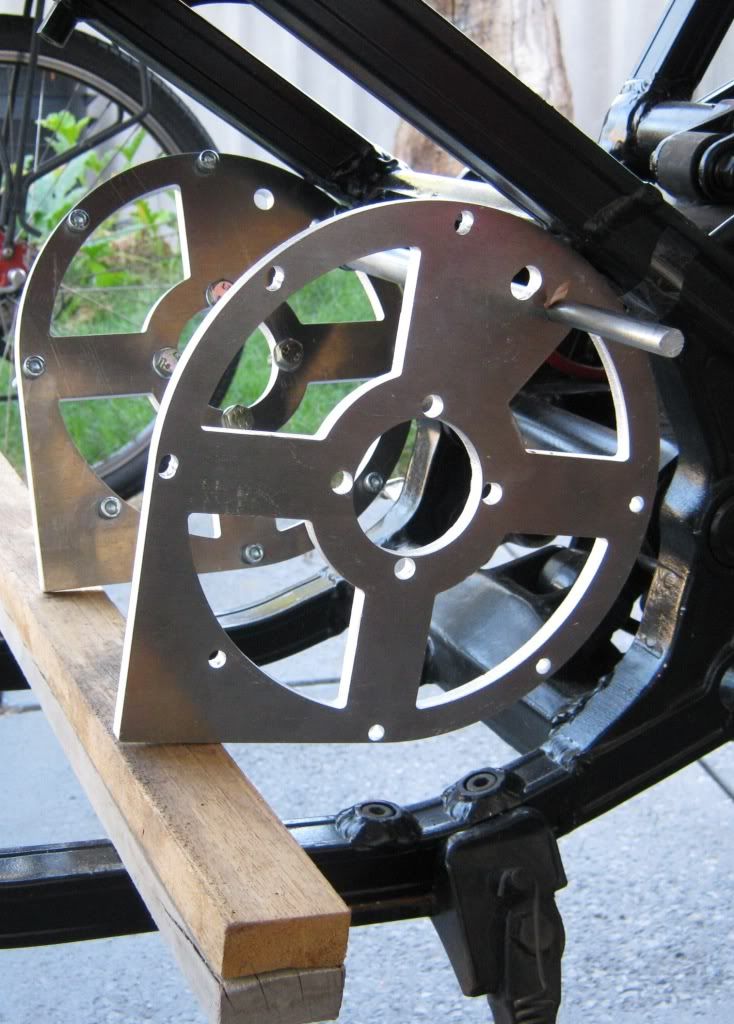

Postby jonescg » Sat Feb 13, 2010 5:53 am
Cheers for the fairings link mate ;) I worked out the RGV race glass from Tyga will fit with minimal dicking around. Still need to get the glass tank made up to make it look the goods.
So I got both motor mounts made up by Action (awesome shop that it is) and got to keep one of their duds. The holes didn't align properly so hey cut another for free.
I worked out if I drill another 10 mm hole just down a bit from the existing hole, I can fit them inside the frame a bit, and this leaves room to stack batteries right up close to the sprocket (not too close though :shock: ). The 10 mm rod with a tubulas sleeve works well to hold everything in place. I'm looking to get a high tensile bolt of 260 mm length to do the same - I don't think mild steel rod will cut it.
I also decided I can still use the 30x30 ally tube, but not across the frame, rather a hanging U shape to support the weight of low-slung batteries. And I can still use the 20 mm crash bars I'm getting made up. Gotta protect my investment :)

Postby jonescg » Mon Feb 15, 2010 1:34 am
It may look just like the last photo I posted, but you will notice the motor mount is now firmly attached to the original frame mounts with some nuts at either side.
I bought a die and threaded some mild steel rod, sleeved it with some steel tubing and put the dud plate as well as the good one on to see how she looks - and I think it's a winner! I haven't driled the new hole for the RHS mount as I will wait until I have both plates and I can accurately do them at the same time. I'll just get Goodwill to fill the original hole in (it was always going to be a bit of guess work).
In future I will try to get my hands on an M10 high tensile bolt about 265 mm long - should be a bit stronger than mild steel I would hope. But now all that remains is to get the plates welded together with 16 mm solid ally rod, and to mount the battery saddle in place:
This way I can use the crash bars I got made up, and still leave room for a battery at the lowest point on the bike.
Can't wait to get things moving... Might as well order another sprocket - should be here by June :D

Postby jonescg » Sun Feb 21, 2010 5:02 am
The motors go to the outside of the frame, shafts point inwards. These two motor plates will be welded together with 189 mm lengths of aluminium tube, leaving room for the sprocket and chain, of course ;)

Postby spdas » Sun Feb 21, 2010 2:18 pm
Aloha, I guess I had a DUH moment. Weird, as I must of looked at your mount pix for 15 minutes late last night and didn't figure the motors to be on the outside. "Tunnel vision"
