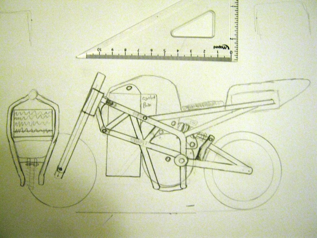

Hey everyone,
I have another update on this build thread! Yay!
After much head scratching and pondering, I have decided I won't be using the K5 GSXR1000 as a donor chassis. Apart from the fact that it's an awesome ICE bike as it is, there are some serious issues with how I will fit everything into it. The K5 GSXR1000 was shrink in almost every way compared to the K4, and even more than the later, K7s. Why I didn't notice this, I don't know. But the reality is, it ain't going to fit, and if I did try to make it fit, I would be left disappointed with the compromises.
So I have decided to get a custom frame built :shock: :o
It's not as expensive as you might think - roughly the same as what the donor bike cost me. Granted, I will need to attach brakes, forks and shocks to it, but in the grand scheme of thins I will be happier knowing that the bike does fit everything and satisfies true race bike geometry.
Some important considerations - the Evo AFM140 motor is big, but narrow. Therefore it needs to sit inside the swingarm such that the chain won't be reaching too far to the drive sprocket. This means getting a custom swingarm made - or does it?
Exhibit one - A Ducati supersport 800/900 swingarm:
This swingarm allows for the shock to be placed above the motor. It also has a H-shape able to accommodate the rather large Evo motor. I want to run a 160 or a 170 rear tyre such that there is plenty of chain clearance and the motor can remain centrally located (not off to one side, upsetting the balance of the bike). A 180 tyre wouldn't allow this.
On the custom frame front, I have been in discussions with Framecrafters in Illinois. Randy and Karsten have been developing custom race bikes for a long time, and have made some amazing machines. Their speciality is Chro-Moly trellis frames, although they have made some Moto3 bikes using CNC's aluminium parts. I was thinking something like this could work for Voltron II:
The trick is to ensure there is enough room for a 220 mm by 320 mm battery box which can drop in from the top, while at the same time making sure the thing isn't too fat for the rider above. It will taper at the base where the motor will have a series of attachment points.
In this earlier sketch I considered using a CNC'd aluminium motor cradle which accommodates four large supports around the diameter of the motor on 8 mm aluminium plates. By allowing the motor to be suspended in the frame from these instead of the 16 M10 holes provided, it makes it a little easier for the frame builder to mount the motor after a somewhat generic trellis frame has been made.
I think the trellis frame is a winner, but supporting the motor will be the tough part.
Now, you might be thinking how am I going to get a frame built on the other side of the world and still have everything line up when I get it? Well I can provide Randy with a CAD file of the motor and he can get it cut from cheap plate ally or something, and weld a mock motor up. Since the threaded holes will all be in the same spots, it should be straightforward to build the frame around it.
Oh, and it goes without saying, I need to sell the Gixxer to pay for this. So if you know anyone who is keen on a track bike, already set up - let me know!

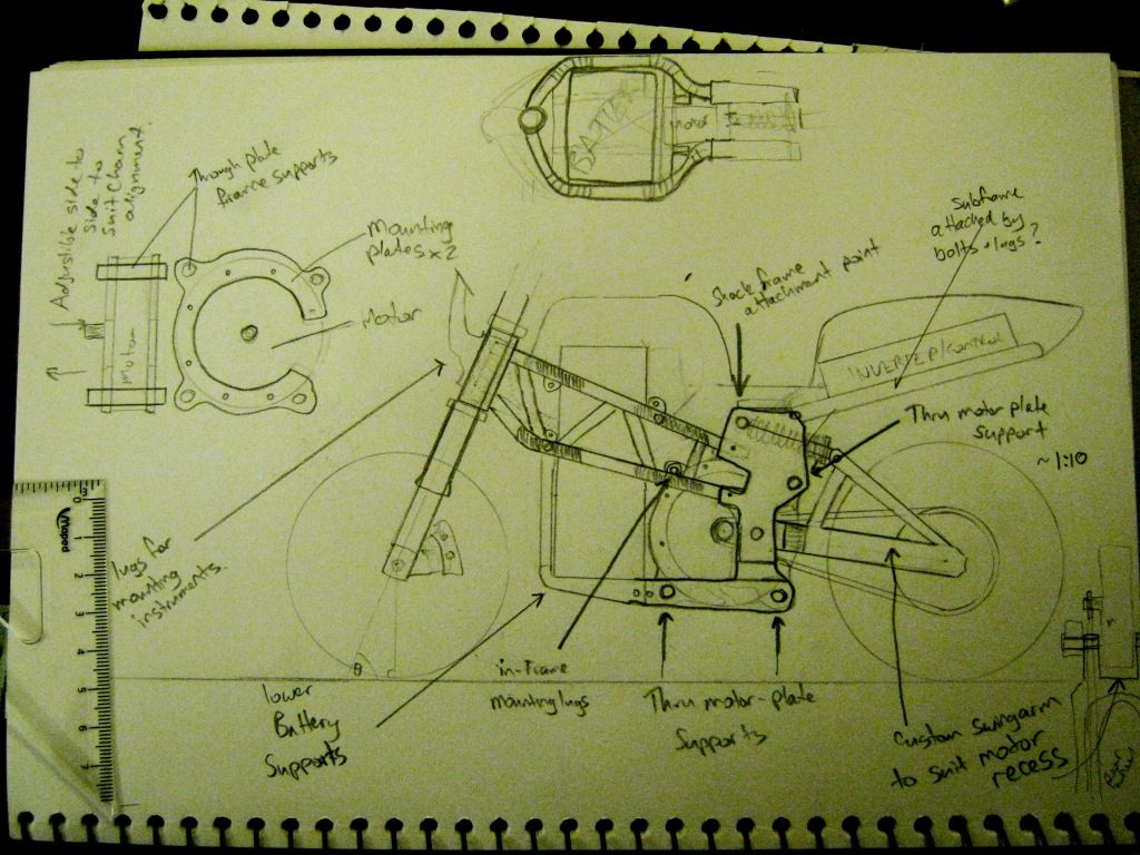

Thanks for the tip, Paul. I have decided to stick with Randy and Karsten at Framecrafters. Their prices are very competitive and their work is stunning.
So I have made a 50% deposit on the custom frame! It's still going to involve lots of input and thought from Framecrafters and myself, particularly the swingarm attachment and the motor attachment.
Just my latest scribblings...
Hope to have the Gixxer sold tomorrow morning; looking promising :)

Postby Nuts&Volts » Sat Aug 04, 2012 11:09 am
Awesome stuff! Only question is, will the bike still roll with the motor removed and is the install of the motor less than an hours work? That is if you are still thinking you want to dual purpose the motor....
If I were you I would leave a bit of extra space for adding more batteries or a little bit different size pack in case you need to upgrade or change in the future. Looks like you are already going somewhat swappable pack similar' to RIpperton's.
Last thing is maybe start looking are standard racing bodywork so that you could pick up a set instead of custom fitting something. IE you can work the body mounting points into the frame you have.
Maybe this will be the next step for our university team in a year or two... Looking forward to seeing this play out.
Oh and that wheelbase seems very big...its going to negatively effect turning abilities.

Postby jonescg » Sat Aug 04, 2012 10:08 pm
Nuts&Volts wrote:Awesome stuff! Only question is, will the bike still roll with the motor removed and is the install of the motor less than an hours work? That is if you are still thinking you want to dual purpose the motor....
That's kind of what I'm getting at with the bit outriggers on the perimeter of the motor. This reduces the number of holes you need to line up from 16 to 4, and allows for better placement in the frame. Theoretically I should be able to jack the motor up to take it's weight, undo the 4 x M14 bolts and lower it down.
Nuts&Volts wrote:If I were you I would leave a bit of extra space for adding more batteries or a little bit different size pack in case you need to upgrade or change in the future. Looks like you are already going somewhat swappable pack similar' to RIpperton's.
Yep, Danny's batteries were an inspiration. However I will be making mine conveniently removable, as opposed to 'swappable'. Voltron I gave me the shits (amongst many other reasons) cause I had to unbolt every single termination and remove the sub-packs just to get at the motor bolts. If you need to work on the bike you can simply unbolt the pack and hoist it all out in one go. I think the pack size is good; its dimensions can go higher without ill-effect, but I'm relying on the fact that cells will increase in energy density as funds and time permits, so keeping the same ~80 kg unit is preferable. Currently settled on a 168s,3p pack, giving about 10 kWh. Oh, and it's going into a crashproof, waterproof Delrin box. Unlike Danny's which would dissolve or self-immolate if it ever got wet or damaged.
Nuts&Volts wrote:Last thing is maybe start looking are standard racing bodywork so that you could pick up a set instead of custom fitting something. IE you can work the body mounting points into the frame you have.
We should be able to fit standard 1000 cc race glass to it, and Randy will add lugs and bolts where needed. The bike is longer than I'd like it to be, but they will determine the ideal wheelbase from the rake and trail. It needs to be a bit long because the swingarm, motor, motor cooling outlets (need ~25 mm clearance) and the battery pack all add up in length quite quickly.
Farfle, I did look at mounting the motor in the swingarm, but a 380 mm diameter motor is huge! I reckon if they traded diameter for width you might have a better arrangement, but this will work for now. The swingarm pivots need to be double-shear on both sides, meaning more precious room is being taken up, and allowing for chain clearance is a big consideration too. I'm going to be running 14:41 or thereabouts, so the chain entry and exit angles aren't too crazy.
All very exciting!

OK I think I have settled on a trellis frame and battery cradle I am happy with. A friend on Trev's forum (mcnews.com.au) who races a lot and has done lots of modifications to frames reminded me that subframes are disposable and I shouldn't mount the shock anywhere near it. So in heeding this advice, I have come up with a simple motor mount, trellis fame and shock mount.
Open in a new tab to see it fully. I have highlighted the bits I want FrameCrafters to build for me.
The overall length of the bike is a bit longer than I'd like, but I think I may have been a bit generous with the front wheel clearance. I can easily claim another 25 mm there. The battery cradle is important, not because it provides rigidity (I believe the frame as it's drawn should be plenty rigid) but should the bike crash there will be considerable force exerted on the battery pack in the forwards and downwards direction. The cradle can bolt in like that of an RGV.
The other thing to note is the Ducati SS900 swingarm is a bit short at the pivot end. This means a longer than desired runout from the pivot point to the drive sprocket. As long as the wheelbase isn't being extended, this shouldn't affect the handling of the bike in turns.
