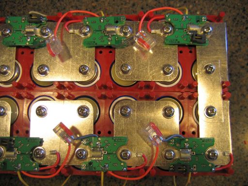

I almost finished my new battery pack.
110 series 8 parallel. Headway "P" 8Ah cells.
A carbon fibre-lexan-aluminum housing is waiting for the cells in the car.
What do you guys think, is this the most powerful EV battery ever...?

It sure looks impressive, but can you give the final Spec. (Voltage/Ah) and overall Size of this System for those of us who may not have followed your journey to date? Also what kind of BMS / LVC you are using?
Thanks,
DH
8P110S
64Ah of the "P" cells, which we've seen can handle 25C discharge.
23.2kwhrs, and capable of around 600kw discharge. The "P" cells really have some punch.

Nice.
But, sorry to see you shoehorning those prismatic cell boards in there.
Cell boards that would have worked better are the large cylindrical, ...
or maybe even the small cylindrical:

Holy crap, all those cells in parallel and there's no fusing to isolate one cell from it's brethren in the event of separator failure or other internal defect :shock:
Perfect if you live in kaboomistan.
Err, I mean hey that's a really cool battery pack there fella.

Performance is the main goal in this project. How should I fuse every cell when I need to get 200-300 Amps from EVERY cell in parallel
We have made the copper bus bars longer on the top to fit in the BMS boards without soldering but it turned out that they where still too short so we had to solder. No big deal...
How likely is a separator failure or an internal defect that causes a short inside the pack? The risk clearly increases with cell count, but have there been any incidents of this type of failure with Headway or other cylindrical cells? Having taken apart a Lifebatt cell I'm just trying to picture how that would happen.
What would you recommend as the minimum fusing requirements? Would that be a fuse between each paralleled group of cells, or as you seem to imply a fuse between every cell? I'd really appreciate advice as I'm busy rebuilding a (much smaller) pack from cylindrical cells right now.

On comparing Tesla:
Each cell includes a PTC, and vent switch mechanism. Cell to bus connections are properly scaled as a third element. Cells are mechanically supported at the ends, with low viscosity glycol functioning as a damping mechanism that closely matches the electrolyte frequency, as well as it's coolant function. Obviously none of these are visible in the image shown.
No need to go further on a comparison.
Headway cells (or others) were never intended to be structurally suspended by their end caps. The heavy copper bars vibrate at a mechanically lower natural frequency than the cells themselves. That vibration will be coupled into the jellyroll. The cell cylinder is supported at the center. The assembly is a cantilever, and will resonate.
Lets assume you put it into a big stiff box. That resolves the external flexure, not the interconnect vibration or cell-level protection elements.
Yes, Headway themselves have used solid material plates to interconnect their cells. It's a chinese company, making shoebox batteries for ebikes.
You have put a lot of money into batteries, and I can see you are a quick study. I highly recommend you hire a good EE/ME with an automotive background to help with the next pack design. Stop looking for affirmation from members here on the E/S. They'll just smile as your efforts burst into flames as group entertainment.
