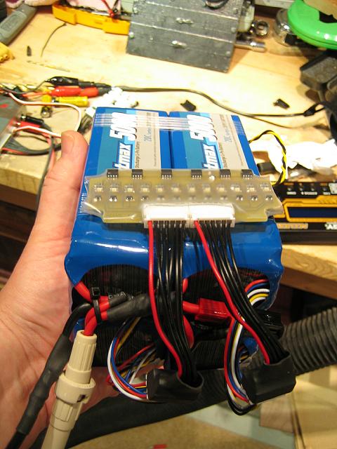

Postby Knuckles » Tue Jun 01, 2010 5:18 pm
All New Micro LVC for Turnigy 6S!
Just plug in to the JST balancing leads of a 6S LiPo and connect it to your ebrake circuit.

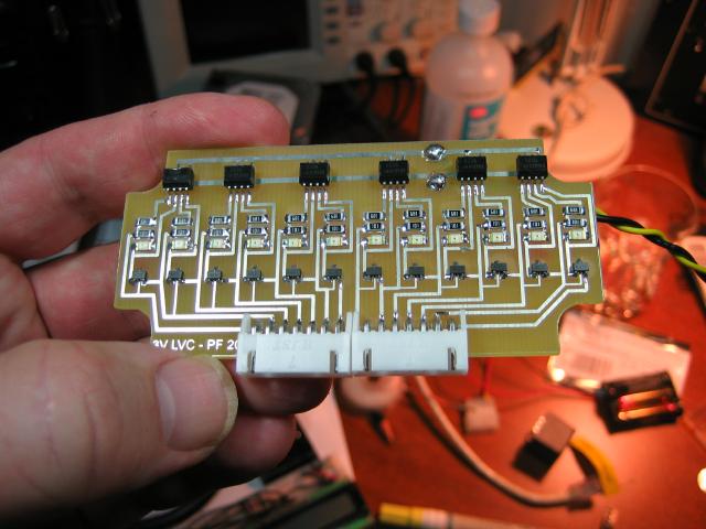

Postby geoff57 » Tue Jul 20, 2010 8:05 pm
hi
Knuckles started this thread as a result of me telling him that I was thinking of doing a SMD version of Garys LVC/HVC boards.
I have since compleated the artwork on that board and then got thrown a curve ball when I find out that Gary is going to start playing with the HVC settings, by this time i had been talking to some people outside of the forum and found that the part of Garys circuit that is most wanted is the LVC circuit. The parallel balance board can be made with a piece of stripboard if needed and you can choose how many packs you put in parallel.
I then desided to go down a difrent route for now at least and make the micro LVC or thumbnail LVC a reality, I had previously got a LVC board from Gary and so used it as the blueprint for the circuit design, if it worked for him it should work for me, once the circuit design was drawn on paper I started to draw the circuit board in the computer. after I had a working model in the computer it was time to compress it as much as I could Size was important to me for this project.
Once all the copper had been placed where it had to go I started on the top and bottom text, not needed but it adds that little extra to a PCB so I thought I should put it in.
I then got the computer to export all the files that any PCB factory would need.
Now comes the hard part I am getting the boards made in china, my contact Keywin Who supplys a lot of the infineon controllers has a PCB factory handy and we are working together to get the first batch made as soon as we just need to find out what if anything is missing from the list of files I sent.
Now we come to the good part the what it looks like.
The board will be 38mm by 25 mm
it will have a 90 degree JST connector on the input and one on the output along the 25mm side
there will be a pair of 2 way jst sm connector pigtails for the LVC trip output simmilar to how gary does his setup
there will be no parts to put together as all that needs to be added to the board is the 2 connectors and the 2 pigtails both of which I am going to get keywin to do once things are underway, he will do 5 cell and 6 cell from the start other sizes will be offered as kits the more people that want a size the more chance that cell size can be made up not in just kit form, there is pcb board under the connector housing to add strength.
as for price I cannot say yet I am still waiting to hear back from the factory as to the cost of the first run and the cost of future runs using the same templates as the templates are the bit that costs the money.

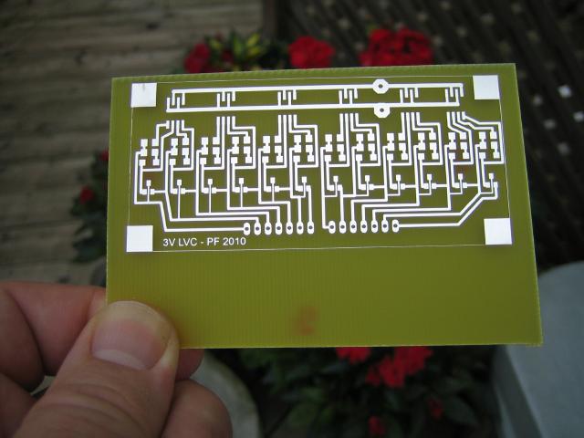

I have a few pictures of the PCB design for you to look at below
first the circuit board much like you get from Gary
top and bottom tracks.jpg (55.56 KiB) Viewed 1057 times

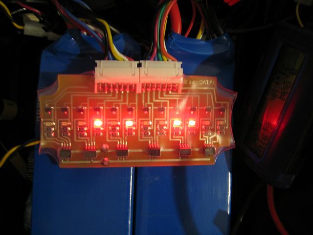

finaly the botom overlay for this I had to put it on the board in mirror format so it would come out correct i have reversed the image for you so you can read it
bottom overlay.jpg (35.26 KiB) Viewed 1055 times

Sheesh. I just can't keep up with this place. Really. I just started playing with LiPo this summer, after wading in (deep) to all that's been posted here on ES. I finally gave up and just started playing.
I hit the same poser that everybody else does - what do you do for a BMS? Then, realizing that the chargers I'm using look after the ugliest task, I was taken by the elegance of Gary's solution for pulling the e-brake low when any cell hit 3V. Brilliant - I placed my order with Digi-Key right away, and went to work on a board - I wanted it to look after a 12 cell pack. Meanwhile Knuckles started this thread (synronicity!).
Here's the board:
It had to meet two special criteria - it had to fit in a small Hammond box, and I really felt I could make it SINGLE SIDED. And I did.
For giggles, I added an extra resistor and an LED to each channel. Funny thing to do - when any cell is over 3V, the draw of the circuit is in the micro-amp range. When you get down to the LVC, not only is the opto-isolator activated, but the LED glows. The draw is 9ma. Obviously something you wouldn't leave plugged into the pack at this point, but I thought it would be useful to see WHICH cell is pulling the e-brake. In a perfect world, when you're finally "dead", you'd look at the board and see 12 LEDs alight. In reality, I'm sure there's ultimately gonna be one cell that goes first - and it would be nice to be able to glance and see if it's always the same one. Dunno if this is gonna be useful or not. We'll find out.
Populated, it looks like this:
After doing a quick Dremel job to round out the corners for the Hammond box (my drill press snapped its belt while I was building this), I realized that the box was probably overkill. So I stuck the whole affair inside a piece of clear heat shrink tubing and just stuck it to the pack with Velcro. (It would have been tidier if I hadn't taken out the corners, and if I hadn't hit the tubing with the heat again after cutting out the connector hole).
Will post about the usefulness of those LEDs when I can get out for a good run. We've been living with torrential rain for the last few days. No fun.

hi Philf
been a long time since I have come across a post from you glad to see you are still working with SMD work.
good work was it a home etching or did you get someone to etch it for you, the LED's are a nice touch but the only time the LVC kicks in generally under load and when the load is not on the LVC kicks out so you probably will not be able to tell which cell has gone low when you come to look at the LVC more than likely all the LED's will be off, the Idea is good but the method of doing it I don't think will work, for it to work the voltage of a cell would have to still be below 3V once the bike had stopped that would make the under load voltage dangerously low so not the way to go. If you want to try this Idea to recognise which cell has gone low and I can see some logic in it what is needed is a way to lock the LED's that go on so they stay on until the LVC can be checked when the bike is still I am sure it could be done with transistors I should know what sort of a circuit to do but on a sunday I am only half awake I will come up with something later.
With the LVC I have done size was important it was to cover only one pack per board(you could of course add packs in parallel) the boards are to be put inside cases so cell low LED indicators were not important though I do think it is a idea to think about for future projects, for now I will rely on when the bike is home and the battery pack is ready for charging the cells are checked with a cellog8 or similar device or if you are charging with a R/C charger you can use the cell voltage monitor that comes with it. We must also think in terms of the fact that since the turnigy packs and zippy packs are not easy to take apart I have tried finding a bad cell is not that useful but finding a bad pack would be as this is the only thing that can be changed for those that have made 6S packs from 3S packs a single LED on each board would not be a good idea but as there are not that many that have taken that route a single LED should be enough that will identify the pack or group of parallel packs the worse pack can then be identified by separating and reading the pack voltages or you could fit a LVC with LED indicator to each pack for a few rides that should find the guilty one.
Thank you philf I will be leaving this version as it is but I will be doing a future version that can identify if a pack has a cell that keeps going low first or I may go for cell detection I am not sure for LiPo only pack detection is needed but for LiFePo4 say with A123 cells cell detection would be useful, but I am not going to be doing the LiPo4 version yet.

I thought about the LED on my boards as well, the increased forward voltage will stop the cell discharging to 1.2V through the optocoupler, but rather down to the Vf of the LED and the Vf of the optocoupler. This is a good thing.
The cells that are down will probably only stay down under load, so you would need to latch with an SCR - as soon as you remove the load, it will probably clear depending on how quickly the cells recover.
The failure mode of the TC54's is of some convern as well - they fail shorted, so will drain the cell to the VF of the opto LED.
Also - quick question - what are you using for tinning your boards? I've been trying to find something cheap that works well, TINNIT is not available in Aus, so I've almost resorted to making my own with Stannous Chloride 5 grams/litre, Sulphuric Acid (66 Be - 96%) 10 ml/litre and Thiourea 50 grams/litre.

But! I gotta say it... Like geoff57, I didn't think there would be much to see when the board tripped. Was I wrong! The cells did rise back to above 3V again, but stayed low long enough (well over a minute) for me to grab this shot on the first exhaustion.
I confess, this was after an artificial depletion through my "load bank" (a scaleable array of 500w halogen tubes)...
So, I charged up and took the pack for a real ride and... Alison had to take my picture being all excited (yeah, that's what I look like when I'm excited) after I chased through the house still holding the pack with an LED lit (there were two when I started looking for her).
I'm frankly stunned that it works so well.
