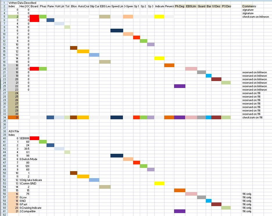

Data Structure
This is work in-progress. I have identified the following relationships between the ASV file and the data as written to the controller. More effort is required here because the patterns are not obvious, though we may be able to draw some early conclusions.
Infineon/EB806 example
Link to full image here.
As you can see ~ I am still working on sorting out the relationships. It is time-consuming and tedious. I would greatly appreciate some help here should anyone like to take this on. Here's what I've gather so far:
  • There is a relationship between Index 2 of the Written Data and any parameter; my thinking is that this is a checksum.
  • Also there are non-linear progressions on Phase Current sequences, as well as differences between Board Types. I simply don't have enough data to create a pattern though.
That's what I know so far; I should be able to return to this later this evening.

Here is the revised Data Structure et al…
Briefly, the differences are:
  • Infineon writes 24 sequential bytes of data, beginning with two signature bytes, with the 3rd byte as the checksum, and the last six held in reserve, whilst the ASV is 16 rows in length.
  • 116 writes 32 sequential bytes of data, beginning with two signature bytes, though using the last byte as the checksum, with the last seven of eight held in reserve, and having an ASV that is 22 rows in length.
Toss in a little bit of color-coding for differentiation, and we can better appreciate this cryptic information :roll:

The part that is difficult for me to kanoodle is when
  • We change boards, what is changing and why
  • We change values where there are more than three choices
My initial investigation suggests that there is some jumping around and non-linear progressions in the data written. I can’t define a pattern until I see all the data for all the params.
Fortunately I have just finished doing the basic mapping; well… a quasi-mapping. It’s kinda like mapping DNA: I got through part of one controller, then switched over to the other controller and wrapped it up. In the process I discovered that though the two controllers look and act very similar, they are more like cousins than brothers. But they all belong to the same genus so we’re cool… we’re chillin’… in the groove man… 8)
They have signature bytes in the beginning, separate checksum bytes, data values, and reserved bytes; it’s very simple and pretty much the way I would have done it.
So the plan Stan is to start twiddling with the variables; what is exactly the progression for one board and does it apply to the next? Once we figure that out then we can write our own configurations with our own home-rolled interface :mrgreen:

Item 3: Automate as in "create a test harness". I have zero-experience in that regard, however I have seen my SDETs wire these things up where they can iterate through each value of every combobox, submit, trap the result (if we use a serial monitor) and record it in whatever format for consumption downstream.
I have the values for the Booleans and tri-states; no issues there.
The problem is when we select Phase Current for example. Method:
  • Select value 30, submit, capture written data – particularly at the offsets that I have mapped out. Next…
  • Select value 35, rinse repeat all the way to value 160.
  • Reset.
  • Begin anew with Rated Current.
I have not gone through a whole series with one combobox, however this would be a perfect case for a test harness. I just don’t have any experience, and really – that’s what we need to bludgeon through all these comboboxes.
The second part of your statement with regards to XML is actually a preview of where I certainly would like to go as a configurable interface, but that’s cart-before-the-horse. First we have to figure out how the current apps are generating the content from our input because I believe it is not linear.
Example: Speed Limit
  1. I set the value to 30, submit, captured “26”.
  2. Set for 31, captured “28”
  3. Set for 32, captured “29”.
This tells me that there is a progression, possibly a curve, sine-function ~ who knows; can’t predict without more intelligence. I don’t wish to do this manually. A test harness would be perfect. Throw the data into Excel, fit a curve, get the formula; boom – done. Next…
