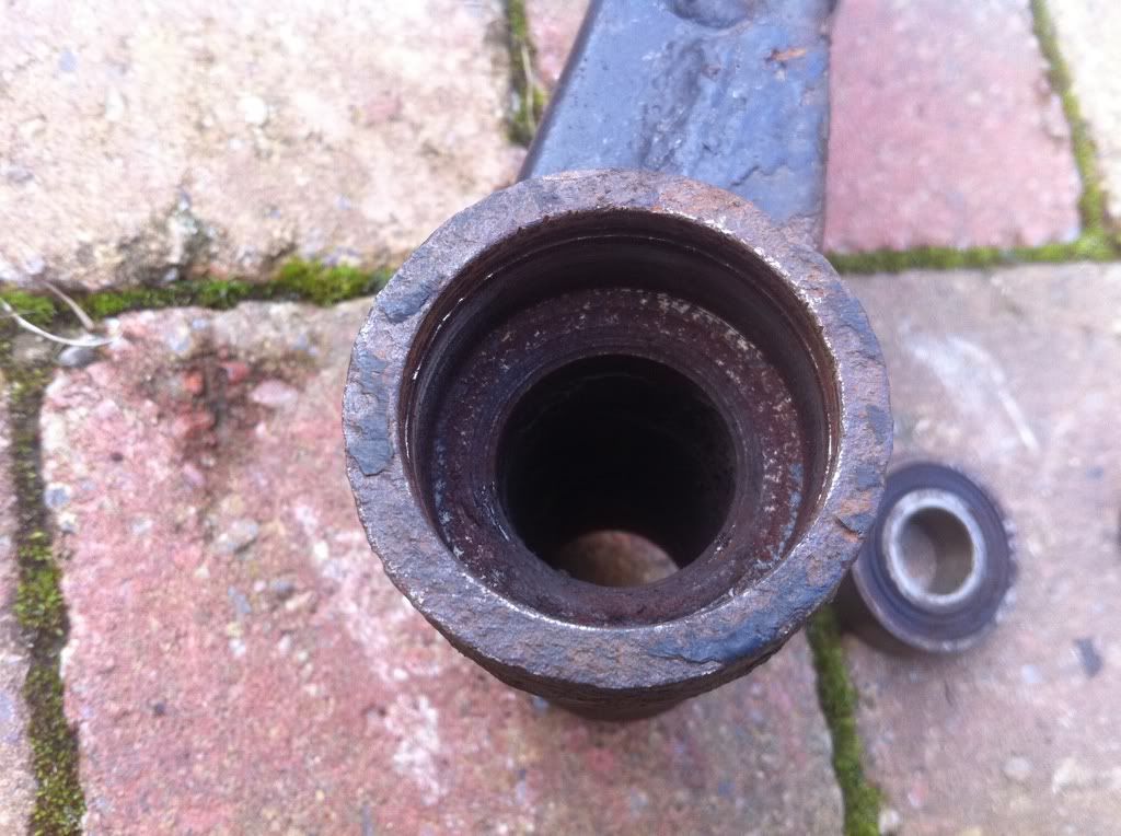

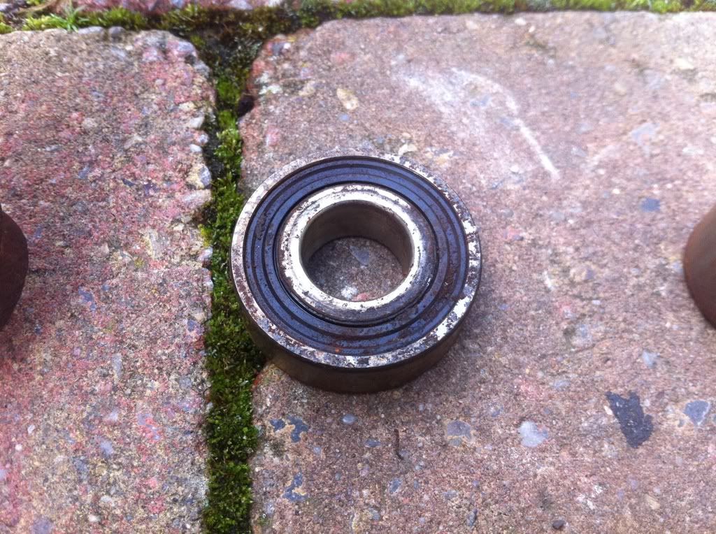

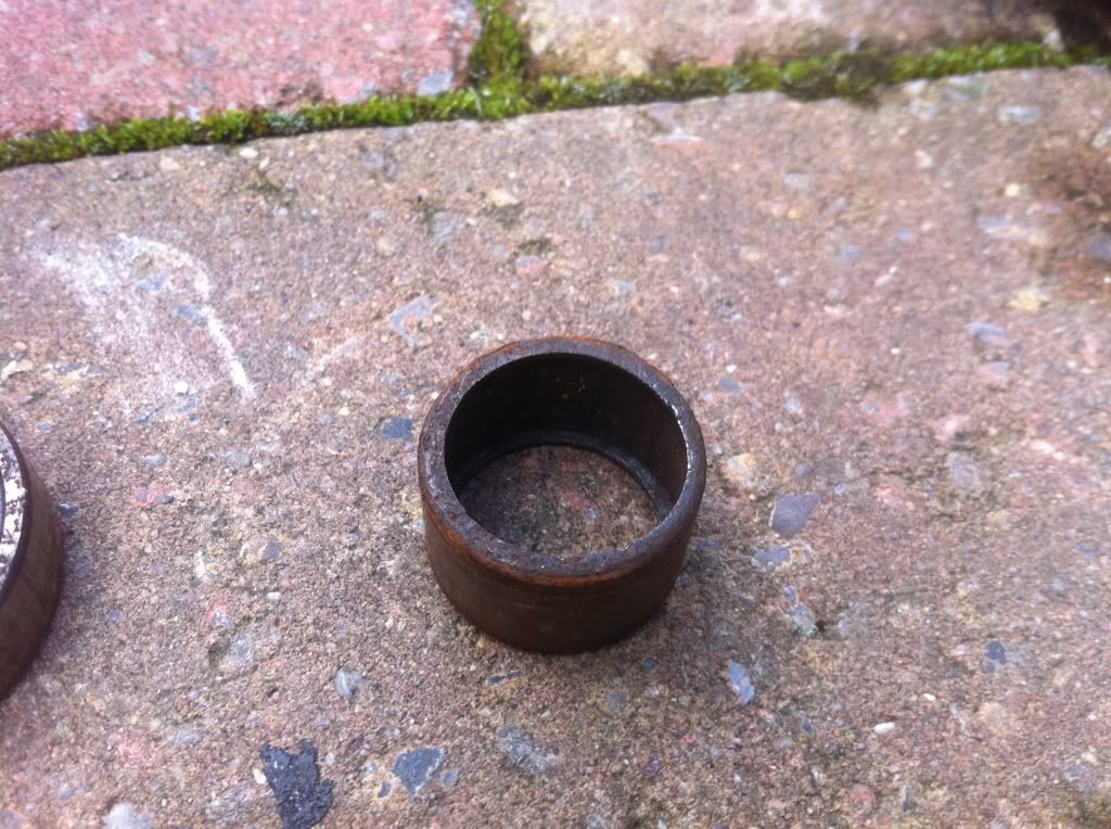

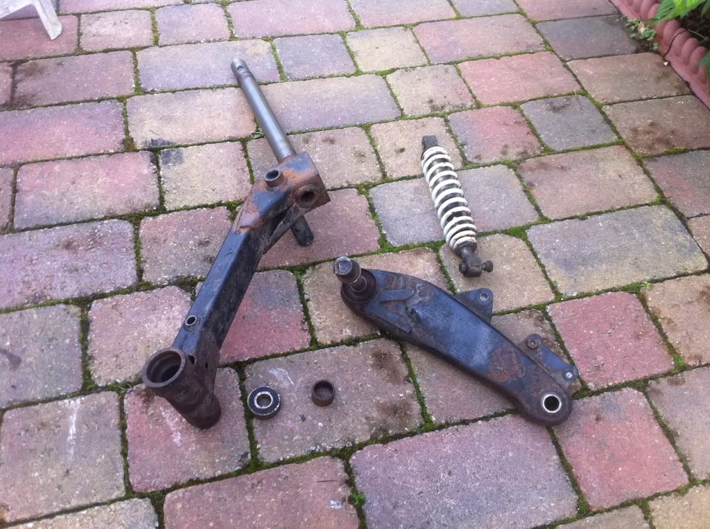

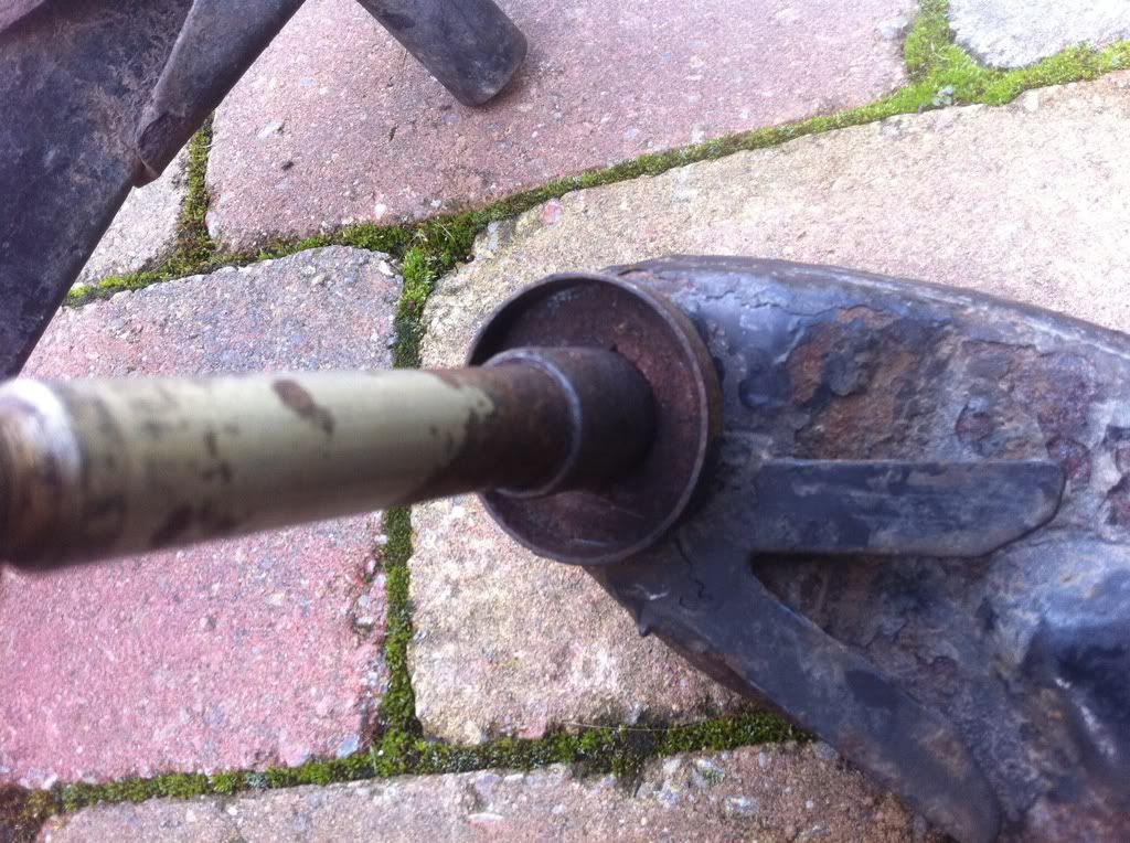

Postby Goped ESR750 » Mon Oct 31, 2011 6:39 am
Completely stripped the front swing the weekend to prepare it for the tapered rollers. The bottom race of the loose bearings is part of a large block welded on and I am going to have to put the whole stem in the lathe to skim it parallel, will need a huge lathe, and have to make up a tool just to do it. That should not take long, the bearing cups will probably take longer.
Few problems with the front swing arm. Both bearings in the pivot and completely gone, did not actually have much of the needle rollers left, and some of the one I did I was able to snap it two in my hand. I can't get the bolt to come out of the swing arm. Going to try and press that out today. I think I am going to screw the washer up, but its very worn anyway by the look of it. It is supposed to run on the needle rollers but because on half of them where not in there seems to have worn down the washer instead.
I need to save the bolt though, I have been looking for replacement bearings. One of them is standard, but the needle roller is a very thin bearing something which I can't seem to source a replacement for. I think it must be a Peugeot specific part, they charge £53 for the replacement. I think I am going to have to bite the bullet on that one and replace it, the washer is only cheap. Bolt is £46 as well so if I can save that I would be happy.
The swing arm itself has got rust on the inside from a little hole at the base. I was thinking of drilling out and filling it back up with weld once I cleaned it, however I managed to source one that looks like its good condition on ebay for £5 so I gone for that instead. It is yet to arrive but it looks far better than what I got. If not, I am sure I can make good out the pair of them. Depends how well the bolt presses out of the arm though, could ruin it by doing that anyway.
Front suspension spring is little heavy for what I need I think. Seeing as I am loosing a lot of weight, looking to maybe replace with adjustable pit bike shock or something similar. The pitch is 265mm
Few pictures of where I am at.

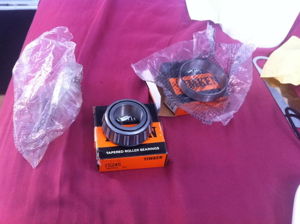

Postby Goped ESR750 » Mon Oct 31, 2011 6:29 pm
Made bearings cups today. Did lovely little job. Pressed the races in, took it home. Was not until I tried offering the bearing to the race did I realise I made bit of an error. Not having used taper rollers before. I did not realise you need space behind the race for the bearing sit on the taper. I need to put the cups back in the lathe a cut a recess behind race. I am not sure if I really got enough material available though. I the wall thickness is about 5mm at the moment. I figure I could loose a few mm, but really by the look of it, I am thinking the bearing might need a full 5mm behind it. My races are press fitted into bearing cups, so going to try amend current cups. Might be the case of making a new set though. Should be great fun getting the races back out with damaging them too.

Postby Goped ESR750 » Mon Oct 31, 2011 8:14 pm
Been doing a little research on the bearings I bought. Managed to find the bearing diagram. I was trying to search how far the bearing protrudes from inner race, I was able to work this out for my bearing using the diagram.
http://cad.timken.com/image?cid=4845&plpver=10&categid=1048&prodid=1050&imgname=Tapered-Roller-Bearings---TS--Tapered-Single--2.JPG
On my bearing:
B= 20.63
T= 19.05
So it sticks out 1.58 mm... This is good news. I will shave two mm of the back of the bearing race, leaving me with at least a 3mm wall on the back stepped to 5mm everywhere else, except the wall inside the frame, which is about 2mm. I don't even need to clock it in, will just take a over cut as it is a clearance hole. Handy as I was making good progress and I hate having to make things twice.
Goped ESR750
Posts: 89
Joined: Wed Sep 22, 2010 10:52 am
Re: Super sized stand-up Scooter project. Build thread
Postby Goped ESR750 » Tue Nov 01, 2011 12:25 pm
Reworked the bearing cups giving a 2mm recess behind the race. Bearings now fit perfectly. Am very happy with the cups. These will now be powder coated black. Few pictures below.

But WHAT is this thing? with the rubber? the back axle goes through the square area? a kind of schematic sketch on paper would have helped me figure out what is happening at the back of that scooter!
how many inches of suspension are happening at the back? depends if you off road, but for general purpose, maybe 2-3 inches makes a more controlled and comfy ride if there are bumps. What would have sprung to my mind is a pivot with a coil or leaf suspension, maybe even some air suspension like a tennis ball or a larger volume of polyurethane.
I was amazed that you stripped that bike totally, i thought you would put the battery in the saddle and take off all but the frame and the excellent outer shell on the speedfight. really i would have kept the back suspension!!! Piolini!!! it rocks! Oh my god.
amazing tools and engineering!
Thanks for checking zzoing. Not really sure of the suspension travel on the rear wheel at the moment, the longer the swing arm the greater the travel. Thee inner square pivots just under 45 degrees before it spins out, so the maximum travel ideal would be about 30 degrees. I am still fine tuning the fill material, it will work but I am not happy with it at the moment.
It is very similar to trailer suspension known as Indespension. I chose this sort of system as the point of compression is around the pivot point; surely the most compact system possible. A spring with a damper would of been better, but this thing is more of a toy and I want it too look right. With a spring above the rear wheel will take away from the look of the stand-up.
