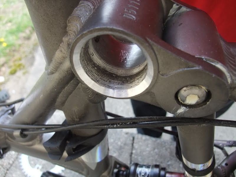

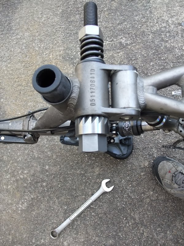

OK, awhile back in this thread I promised I'd post some pics of the ATS drive installation. Well here goes.
I rented the tool set from ebikessf.com. They have an excellent installation video that was my guide. Renting the tool set was about $50 all told (that's rental plus shipping to me/back to ebikessf). Refund of $350 deposit was prompt. Very happy with how this is going so far...
Renting the tool set was very worthwhile, as I bought 3 ATS drives to install on 3 bikes. So, my cost per for installation is about $18.
Here are the pictures.
The most important part of the tool set: The chamfer tool is centered in the picture.
Here's bike #1, my spare bike. It's a 2007 Dahon Jetstream with NuVinci N360 rear hub. A great, versatile commuter bike. The ATS SpeedDrive will give me more gear range without the hassle of putting front chainrings on a folding bike. Here's the BB shell prior to chamfering.
A crank puller and bottom bracket removal tool are a must.
Another view
Here's me, using the chamfer tool the hard way (there are two springs, use them as shown in the video or get ready to spin that nut on the right a whole lot more than you need to)
A bike stand would have been nice, keep my back from aching, but it's easy enough to chamfer the BB with the bike upside down on its bars
Side 1: 45 degree chamfer, smooth and easy:
Side 2: Just as easy, but starting to get the hang of it so I didn't need to take the tool off & inspect quite as often

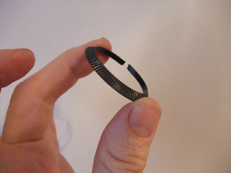

The "nut" you use on the left crank size has the mating 45 degree chamfer and can be used on both sides to gage depth

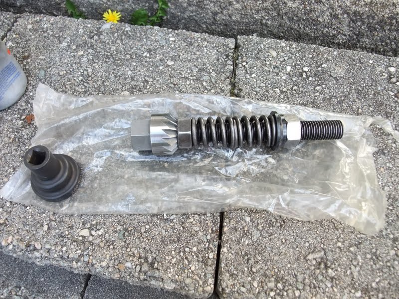

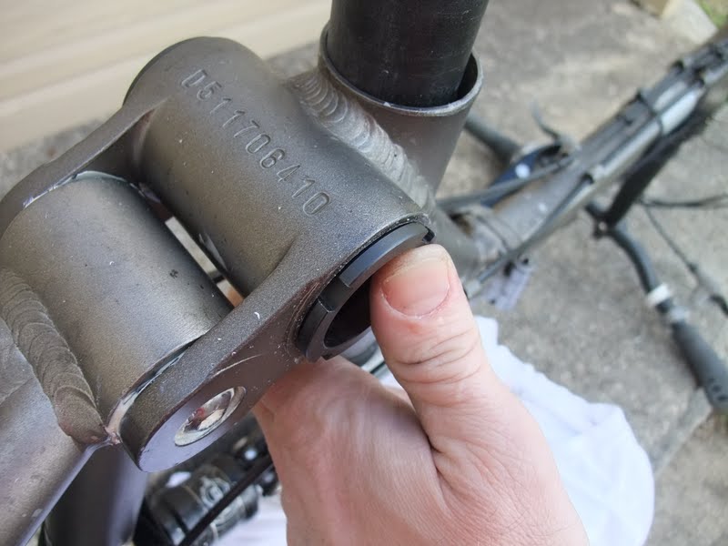

Once I got everything chamfered, I tried to mount the drive tightened to specification. But, the nut bottomed on its threads before I could apply torque. I had to order thicker spacers (they come in 0mm (pictured, I think), 0.5mm, 2mm, 4mm and 6mm). The spacers help with my problem (BB too narrow) and probably chain alignment too - which is why I ordered some 2mm and 4mm spacers.
Here's the spacer cone the drive arrived with.
My rental of the tool set from ebikessf was for one week. Though I was done with the chamfer tool (on all three bikes), I still needed the rest of the tools - especially the "box spanner" for tightening the bottom bracket nut - once the new cone spacers arrive. I suppose I could have called/asked to stretch my rental a day or two if I thought the larger cone spacers would arrive imminently, but I was not comfortable with the shipping timeline on the spacers.
So, I bought my own box spanner from Utah Trikes. I bought some of my cone spacers from them, and the shipping was something like $9 flat rate, so why not? If I need to remove/service the Speed Drive, having my own spanner can come in handy. If I thought a bit longer about the purchase I would have had them throw in this kit, but since I missed the window on fixed price shipping I'll just improvise with tools I have on hand.
I'm still waiting on my spacers - once they arrive I'll show the rest of the installation.

Pff, looks complicated, spacers, more special tools... :?
Hope the chainline will be right first time...
But let's watch the video first :P

A little canola oil during the cutting would be a good thing to add to the procedure. It will do a better job and allow the tool to stay sharper longer. Also using a torque wrench to get the proper nm. Using locktite on the holding screw is a good idea and will have to do that on mine.

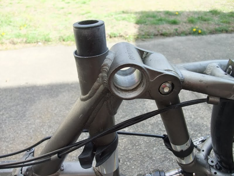

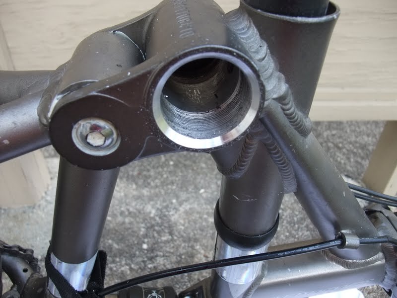

The rest of the install:
First remove the existing BB. This was easy because I just had the BB off a few weeks ago, to machine the BB shell. 6mm allen wrench takes off the crank bolt:
Easy as pi
This crank removal tool was one of my best impulse buys in recent memory
Make sure the inner piece is backed way out. Then thread it into the crank all the way until it bottoms, then back off a half turn.
Now use a 6mm allen key and tighten the inner piece. Some crank parts have left threads on one side and right threads on the other, such that you tighten them as pedal. Not so with these bolts, they're the standard right hand thread on both sides. With this tool the crank arm comes off really easily.
Now go find your BB removal tool. This was about $20 at the LBS.
I had to wiggle it a bit to get it to engage, tight and square. You don't want to torque on this thing with it half engaged, the aluminum on that BB collar feels like it would shear right off if all splines not tight
It's counter-intuitive to me, but to loosen, I had to lift the handle of the spanner from the position it's shown in. Same would be so for the drive side (the BB threads are left/right as mentioned above)
I took a lot of pictures
Here it is with non drive side collar removed
Next, do the same steps on the drive side:

Out comes the bottom bracket. I just had this thing replaced in the fall so it's in pretty good shape. Off to the spare parts bin...
Here's what delayed me: The stock cone washer on the left was too narrow for a snug installation. The 2mm cone spacer is on the right
The 2mm cone spacer was too tight of a fit, so I spent a few minutes sanding down its inside diameter so it would fit in place. Now the Speed Drive is placed into the BB

Preparing to install the BB nut on the non-drive side. See the narrow threaded rod sticking out if the spindle? The Schlumpf tool set includes an aluminum spacer you place over that thing when using a crank removal tool. Betcha ten bucks I forget to use the spacer and ruin the drive when the time comes to remove the cranks...
That spacer I was talking about. Store it somewhere safe.
I put a dab of automotive anti-seize lock on just about everything that has threads. Months/years down the road I won't have to learn new swear words while disassembling this thing.
The BB nut hand threaded on a couple of turns. A little grease, in red, to help with installing.
BB nut, Hand tight
That Schlumpg spanner I keep talking about
Spanner in place, ready to tighten. The worlds oldest torque wrench on the ground between my feet. I had to go back to the ebikessf.com install video to get the torque specification (140 newton meter) then convert it (103 foot pounds)
There it is, torqued to spec. Look how the splines that mate with the install/removal spanner machined off just a little more aluminum from the BB cup.
Clean all threads before applying anti-seize and installing
No show stoppers so far... I'm waiting for the other shoe to drop as I tighten the 14mm crank bolts. I had to tighten them way down, if the cranks are not seated fully, they sit too far out and you can't push the "shift" buttons down fully.
