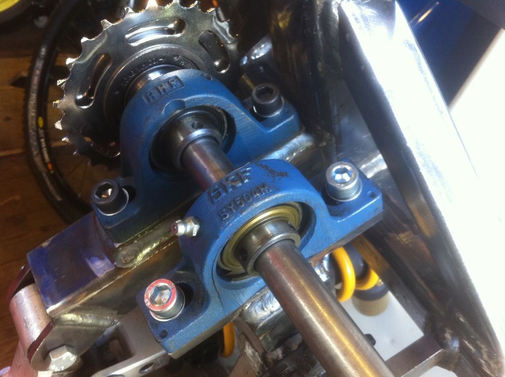

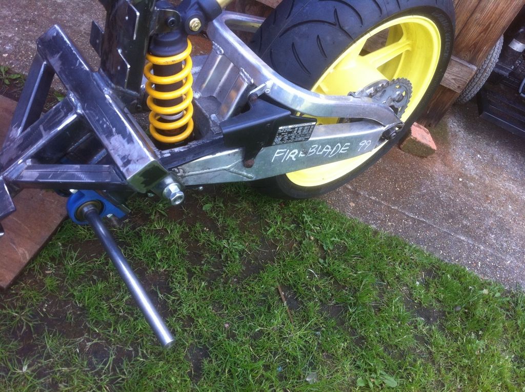

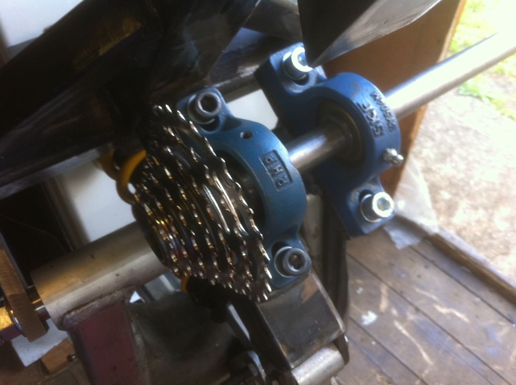

Not sure about steering, surely a damper would cause more load making it more difficult to steer anyways, aren't they more for smoothing out light jerky steering?

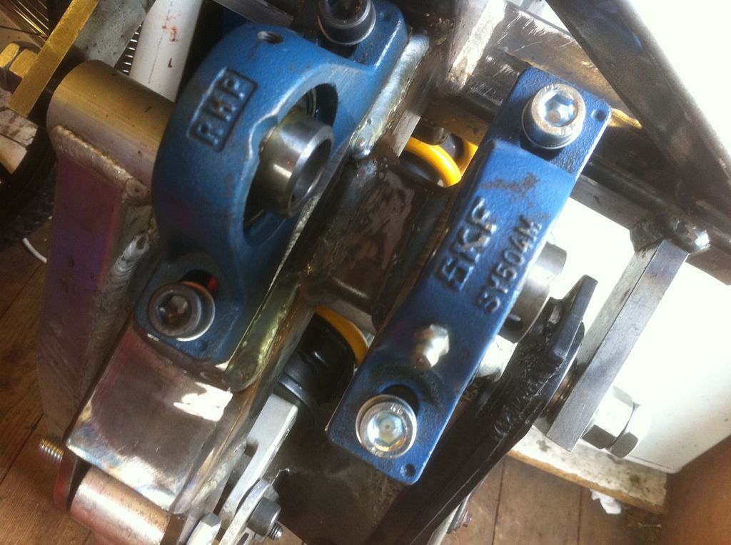

Made some progress on getting the shock mounted. Welded the tabs on the frame to support the linkage arm and the top of the shock. Still need to machine a new linkage, but was able to test it like it is.
Couple pictures of what I got plus a small video of the shock. Is pretty solid, so doubt it will do a lot in use, but looks nice though.

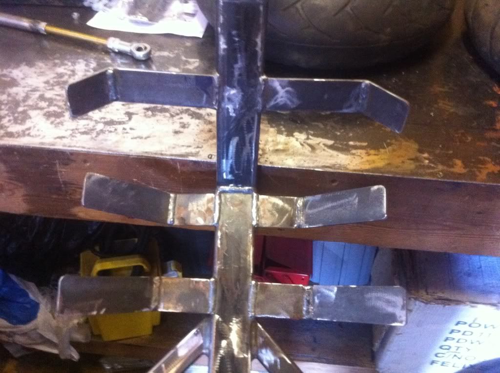

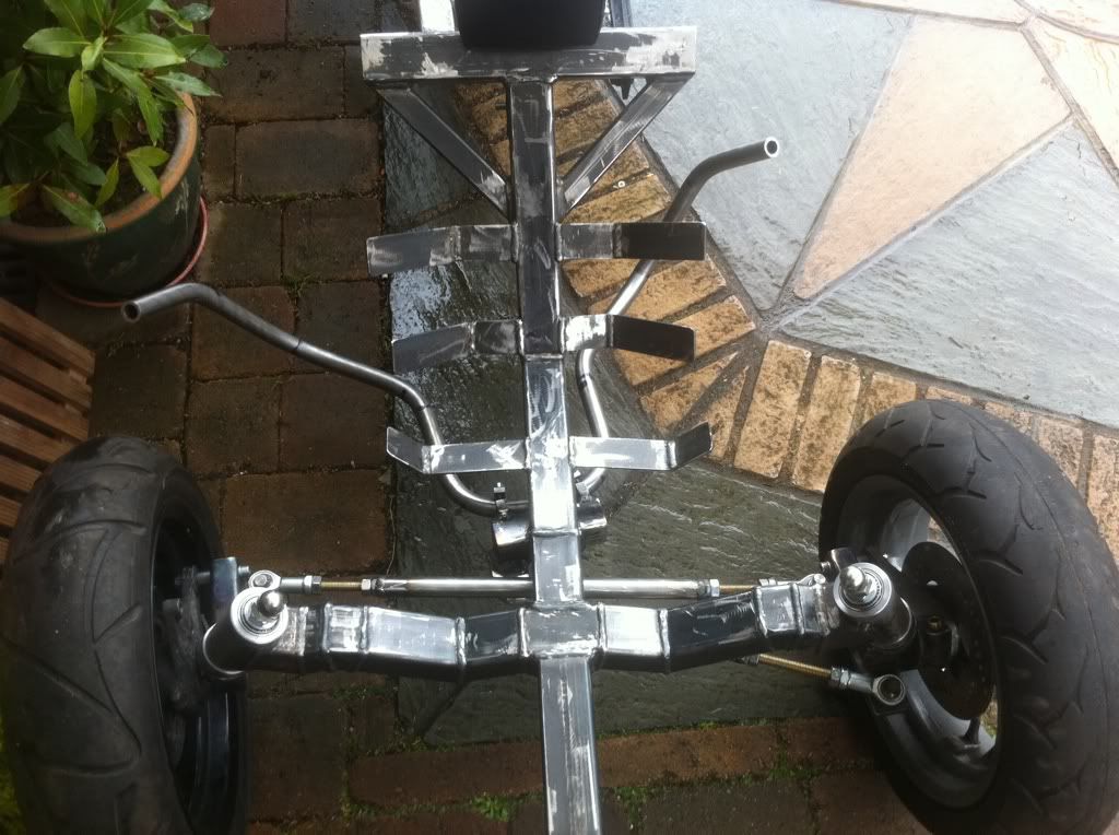

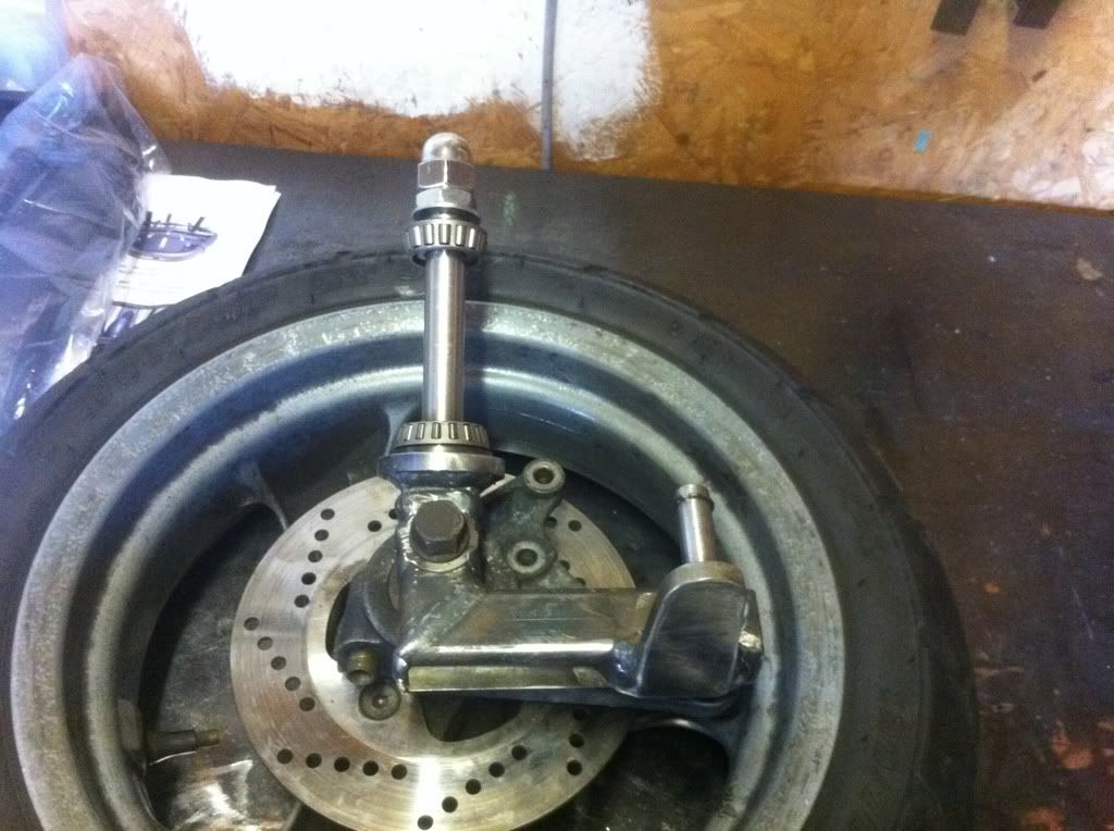

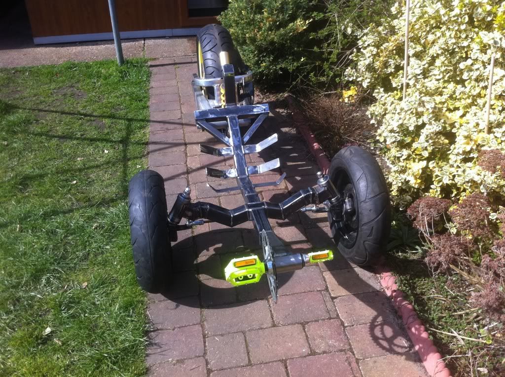

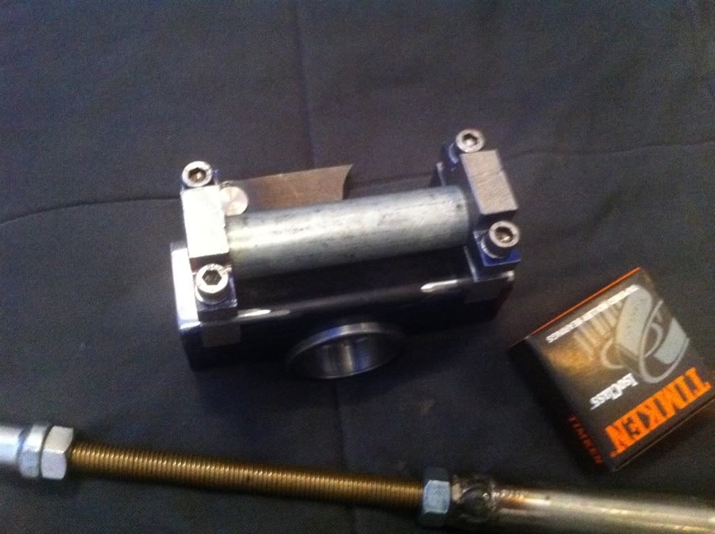

Postby Goped ESR750 » Mon Mar 26, 2012 6:11 am

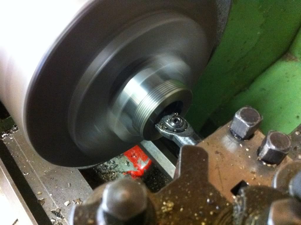

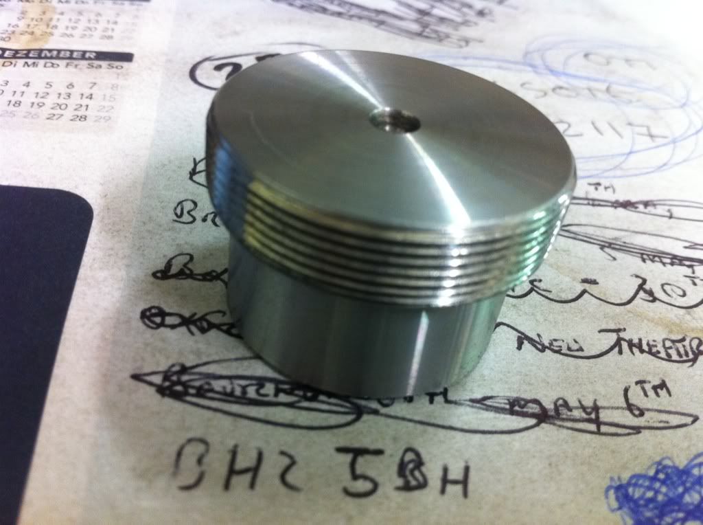

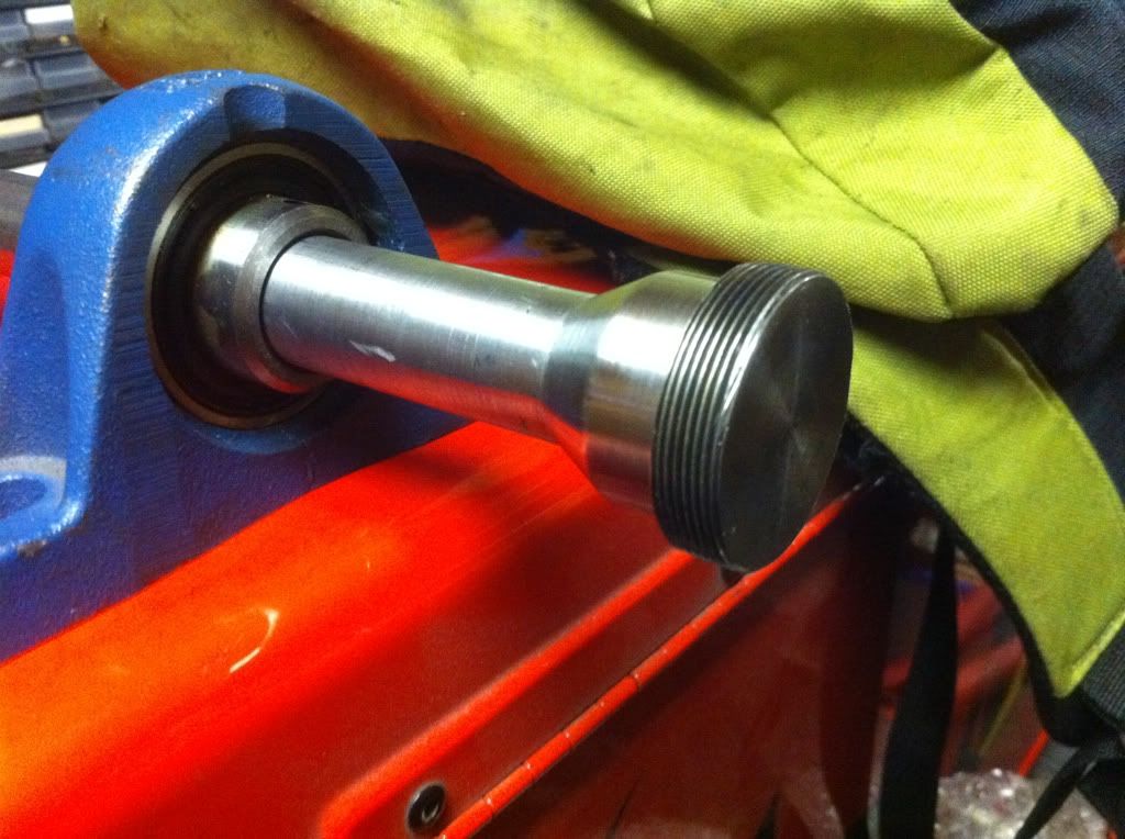

My trike uses kingpins I made for tapered roller bearings. I cant remove either bearing as they need to be locked against each other to work. I included a picture of the kingpins assemblies I machined, they obviously have all the rest of the steering hardware welded to them now.
The steel I used for this is 50mm square box section with a 3mm wall. The actual frame is not hugely weighty, the wheels double the initial frame weight I would of thought.

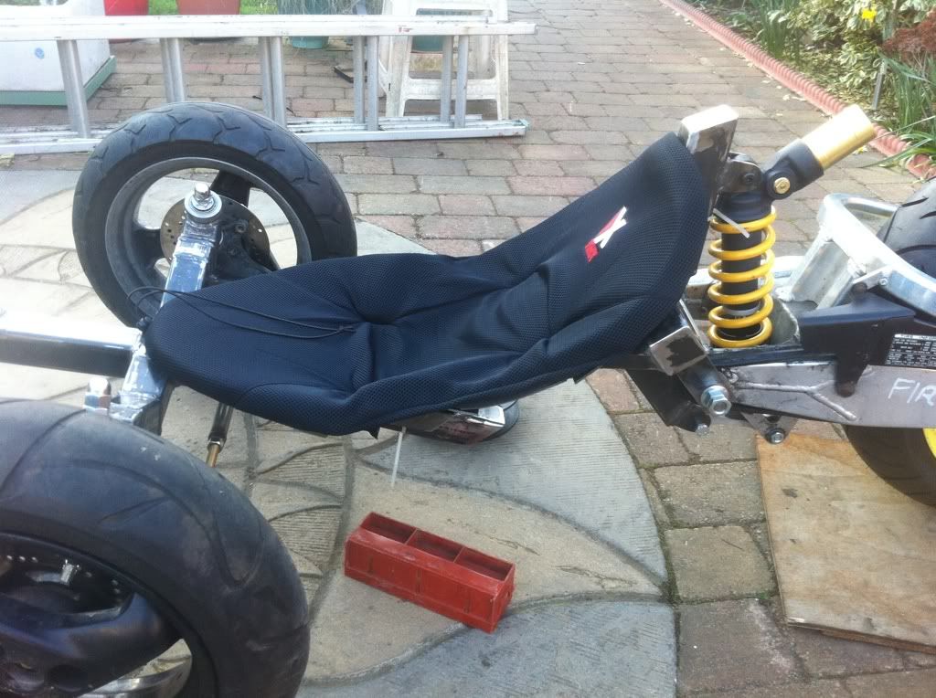

There was an upgrade package for the kmx trike seat. I bought it, and made it fit my trike. I decided I didn't like it, although it was comfortable it certainly was not weather proof. I decided to make a bucket sort of seat which comes out the frame using 40mm x 3mm flat bar. Will add weather proof padding where necessary. The only bit of padding I feel I need is on the rear shock support for my back. The rest feels really comfortable for me, and keeps me in one place without risk of falling out in a corner. Others who have tried preferred the kmx seat, guess this happens when you make it fit one person :)
Few pictures of where I at.

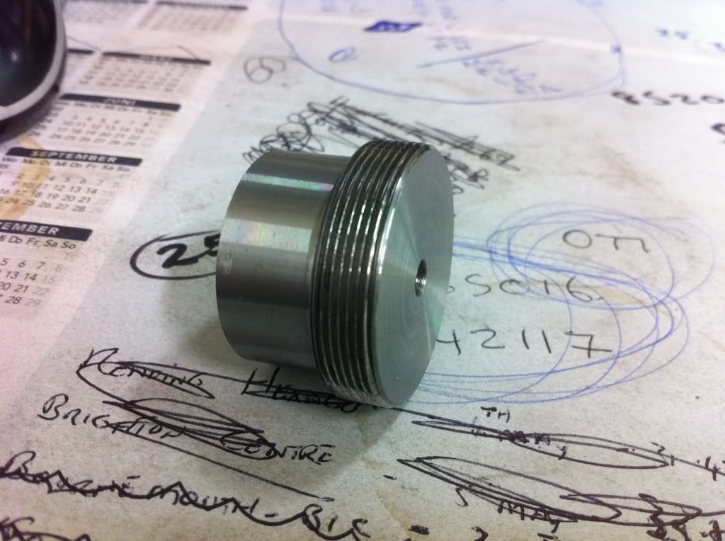

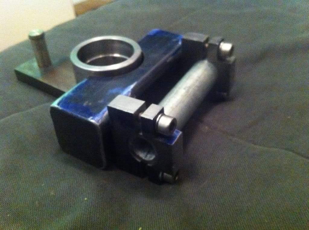

Postby Goped ESR750 » Wed Mar 28, 2012 6:35 pm

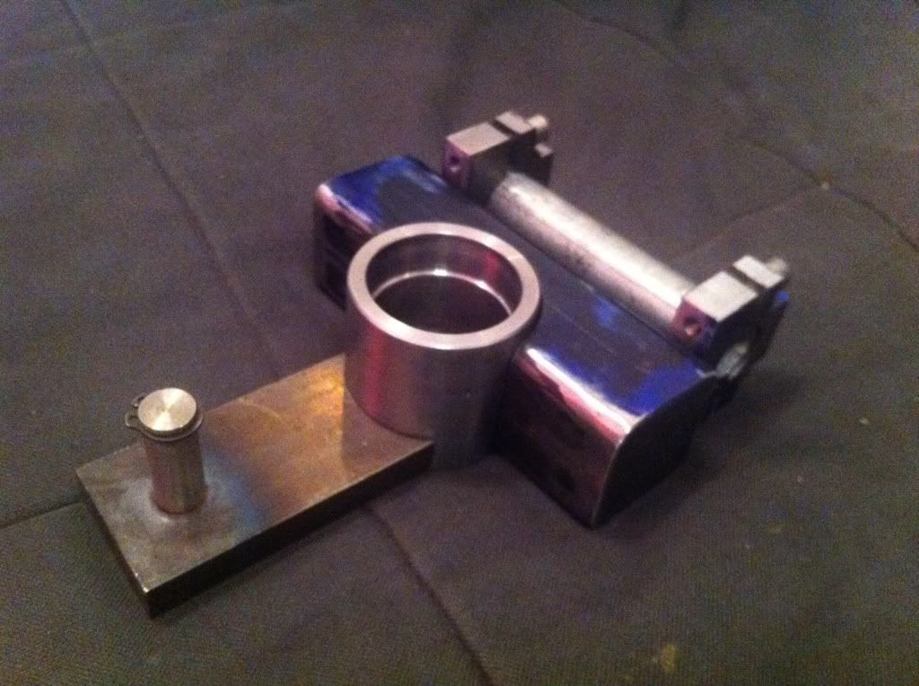

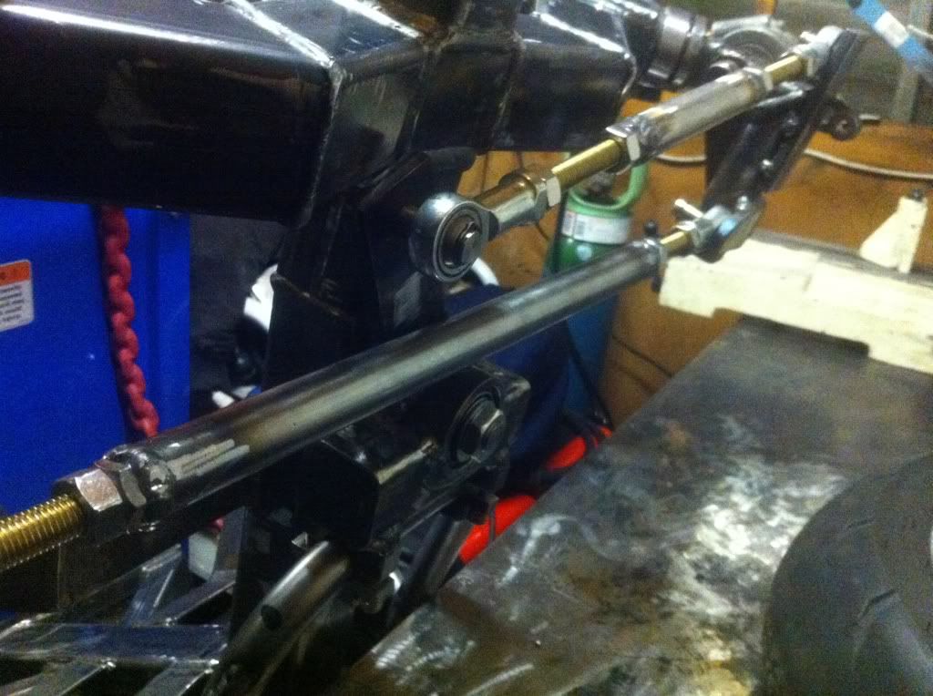

Been working on the steering assembly. Made few bits to weld together tomorrow. Made the notch in the handlebar support box section and steering link pin bracket using a hole saw. Put the hole saw in the mill, worked very well especially seeing as I don't have a collet large enough to fit a 50mm end mill. Used very slow rpm and very slow feed, and was constantly applying cutting compound with a brush. Few pics of what I been working on.
Goped ESR750
Posts: 89
Joined: Wed Sep 22, 2010 10:52 am

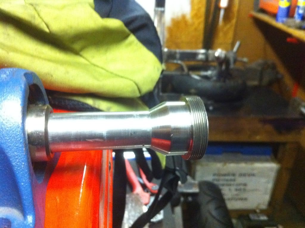

Postby Goped ESR750 » Fri Apr 06, 2012 2:44 pm
Thanks. Glad your liking the build.

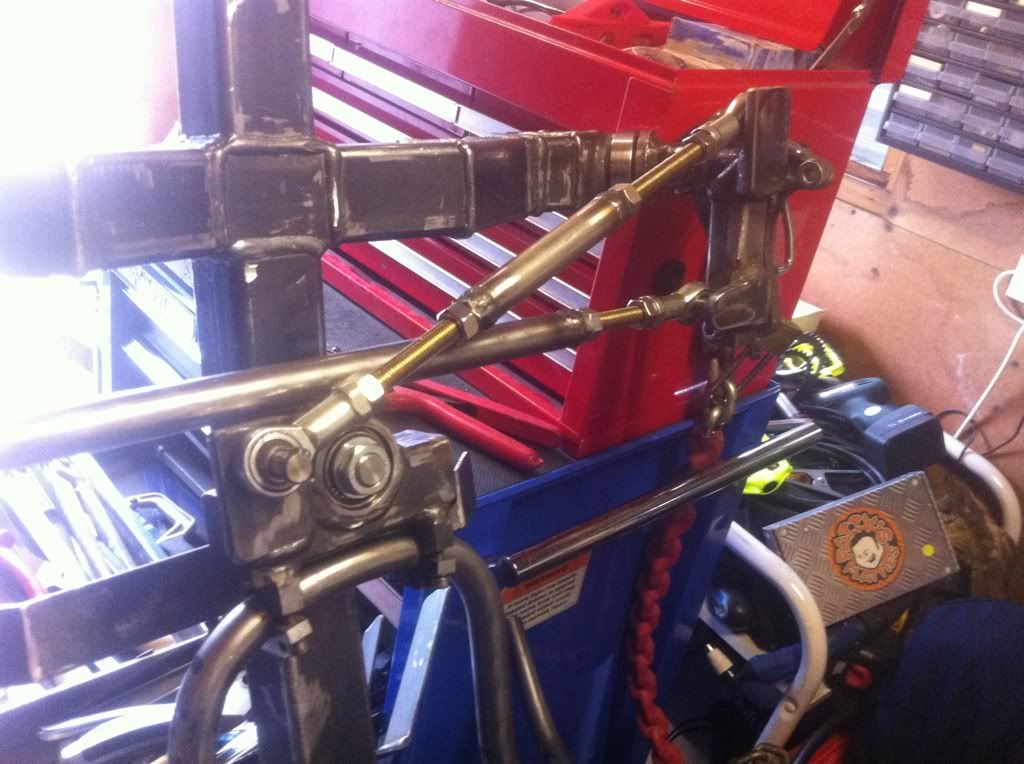

Bent up some handlebars, and been working on the steering linkages. Think I got the ackerman compensation about right, although I think the proportional steering might require some final adjustment.

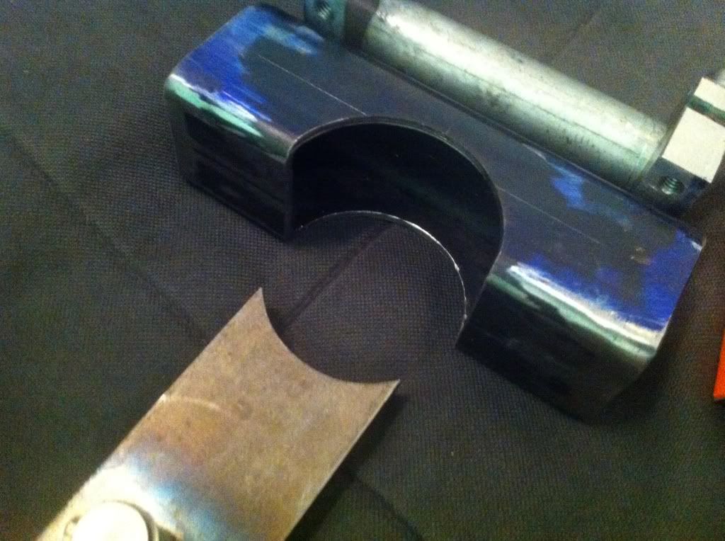

Postby Goped ESR750 » Sat Apr 07, 2012 12:54 pm
Ground off the linkage on the steering tube, wasn't happy with the proportional steering. Found the linkage works best welded closer in. Steering alot better now.
Few pictures of where I am at.

I am real curious about the seat. I have had more trouble with seats than any other part of a recumbent. Here are some of the issues:
If you are sitting a little upright, as many recumbents do, and your weight is just in front of your sitz-bones, your legs will go to sleep. There is a nerve or a blood vessel or something right there. Getting weight onto your back ala' cattrike helps this effect, as does getting rid of any part of the seat in front of your sitz-bones. Those are actually meant to sit on, you know.
I have a friend who used 6" of good quality upholstery foam for his seat, and it works will. I don't like all that squish, so my seats are usually thinner. My current seat is a standard big-butt bike seat, turned around backwards, so I sit right on the edge, with the "horn" toward the back. I customized it to fit my butt by grinding out the foam just so, and adding a waterproof cover. The back support is two tubes that run along my spine, covered in thick foam pads bought from a company that sells gym equipment. It is really lightweight, and small, but strong. I also made it adjustable, instead of trying to adjust the pedal boom, so taller riders can use the bike.
A thin seat means that road bumps hammer your back unmercifully. Even with that big shock absorber, I predict you'll get a wallopping every once in a while.
I haven't had any luck making seats out of fabric or mesh, or lawn chair webbing, although I have tried all that stuff. I suppose one could just buy a seat from Rans or Burley or one of those guys. What have other folks done for recumbent seats? Had any struggles?

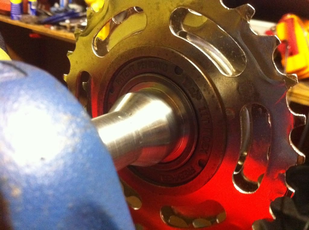

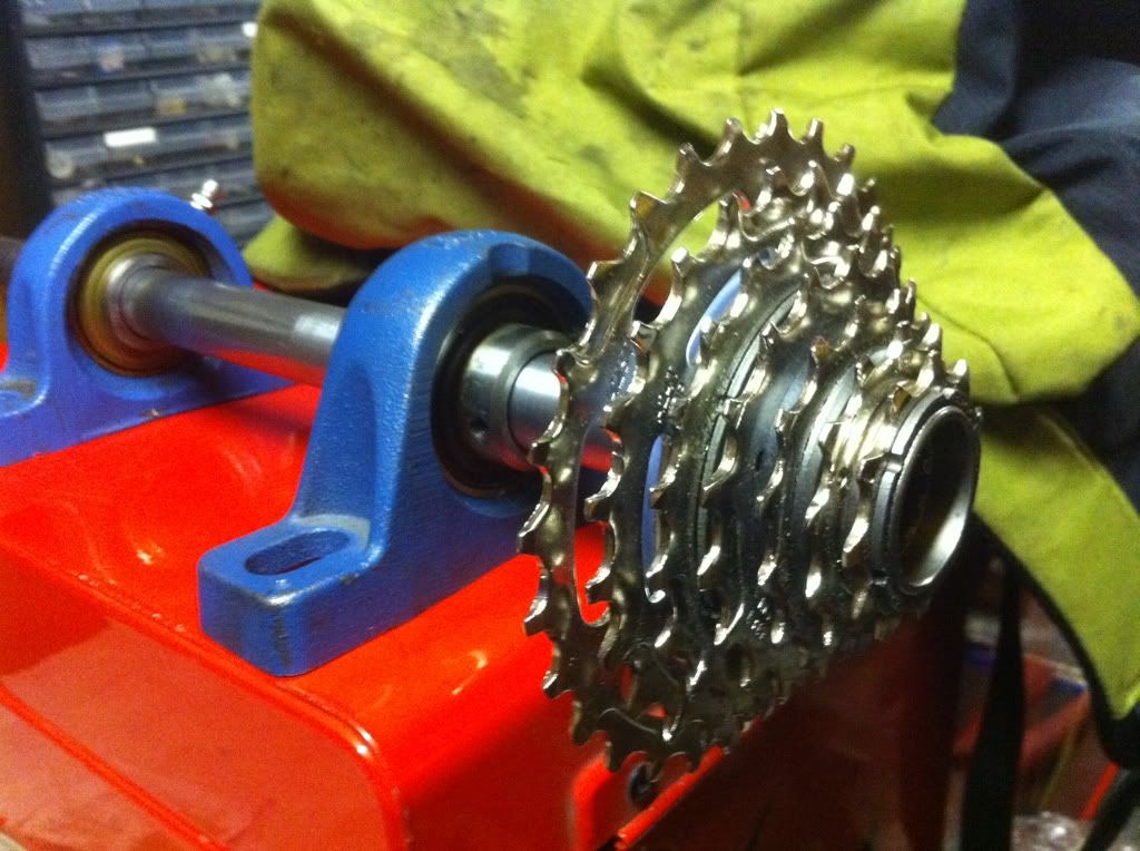

Postby Goped ESR750 » Fri Apr 13, 2012 6:21 pm
Thanks for the replies.
I have no idea of the weight. I have to take the wheels of the trike to fit it in the shed, I can lift the frame without the wheels including the shock. It is starting to feel heavy though, it is not meant as a light weight thing. This probably going to get abused so the bigger the better.
I still have the goped project sidelined. I was working with a frame builder but he was taking so long, so I started the trike. I am going to now weld up my own scooter frame, once the trike frame is out for powder coat. I also have a few other projects in the sideline.
I am not really sure if I can help you much with the seat. It's probably not going to be the most comfortable. I will probably change things as I go along. I like to make things anyway to progress and then come back to them if they cause an issue later. At the moment the seat I am happy with, but I can't guarantee it will be the final seat.
Since I had the steering completed, I have been focusing now on getting the drive system on the scooter. I started with the pedal side as I already know where the front pedals are this will be the datum for my rear cassette and an ideal place to start.
I had a handy new 7 gear free wheel from a previous project. The thread on it was something particularly awkward, being a 35mm 24tpi thread. Had to machine a small weld on hub. Wasn't going to even bother looking for a die, just screw cut the thread on the lathe.
I then bored the hub to 20mm. Slid a shaft through and welded. I really filled it up with weld, which enable me to nicely machine it back again. Can't tell it was ever 2 pieces.
The idea of the drive system is the pedals run to a shaft behind the back of the seat. On one side is the free wheel on the other the sprocket for the rear wheel. In the middle between the two pillow blocks will be the pulley for the motor to drive off. The sprocket and pulley will be use taper lock bushes, so I got a couple key ways to machine on the shaft yet. I needed to use the shaft for alignment so will machine them later.
Here is a few pictures of where I am at.

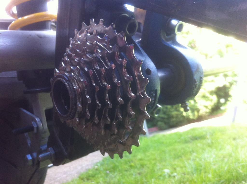

Postby Goped ESR750 » Sat May 12, 2012 12:07 pm
Been difficult finding a break in the weather to get the trike out to work on. It's too big to put together in my shed and I needed to assemble to align the pillow block.
Managed to get the mounts welded on today. I have decided I need to remake the shaft to take a flexible couple past the bicycle free wheel. So I can mount the motor on the other end of the shaft. Need to get a flexible coupling before I make the motor mount, as will use it to align the motor then make the mount to fit. Also need to make a bracket to take the derailleur. Should hopefully have some nice weather so should be able to get rolling on this project again. Few pictures of where I am at.
Goped ESR750
