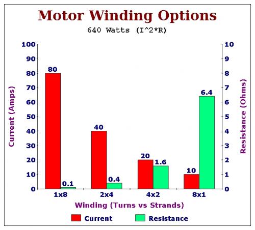

Here is a VERY INTERESTING! thread that SAFE an epic member of E-S did and some representation:
http://visforvoltage.org/forum/13629-concepts-ebike-propulsion?page=10
