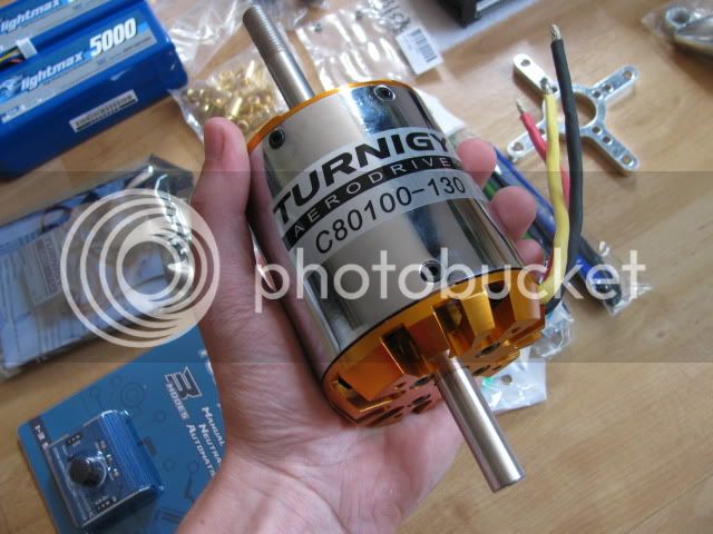

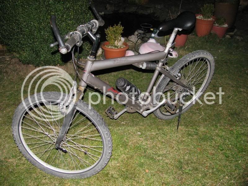

Hi Guys! :mrgreen:
A few months ago I made a topic about converting my mountainbike to electric, I got very helpful reply's from members of this forum (thank you! especially: Aussiejester, Thud and sona1111). Today I turned 17, and I finally bought some stuff at Hobbycity for my MTB. (I actually bought a present for myself lol) The MTB I'll convert is a little old and rusty, but I think it will be OK. Some old pics of this rusty thing (I'll disassemble all the parts, clean etc. them and then re-build the bike before I'll convert it):

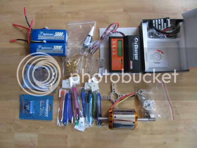

Now to the things I just bought at Hobbycity (a total of $480 :o ):
- Turnigy 80-100-B 130Kv Brushless Outrunner (I know, overkill :mrgreen: )
- 2* ZIPPY Flightmax 5000mAh 5S1P 30C
- iCharger 3010B 1000W 10s Balance/Charger :!: I'm very curious about how this thing will perform, at this moment I've got a cheapo 50Watt charger :lol:
- Turnigy Servo tester
- Turnigy HV UBEC (8-42V)
- Some small things like connectors, ball bearings, thread locker and some other things for my other hobby (RC-cars).
Things I still have to buy:
- Castle Creations ICE HV 120A ESC
- Gears, shafts, aluminium, caps etc.
I'll only use 2* 5Ah 5S 30C LiPo's in series, but gear the bike down to about 35MPH to get the current down. As reduction unit I'll try to make something like Mud2005 has:
http://www.endless-sphere.com/forums/download/file.php?id=31041, a belt driven system from motor to a shaft, then a chain driven system on the other side of the shaft.
3 questions about this:
- Where to get a hardened shaft?
- Where to get the 'belt drive system'; a small 12mm inside dia. gear, a big gear and a belt? (Sorry my English isn't that good, I don't know the name of the parts)
- Where to get a freewheel + sprocket that will fit the hardened shaft?
I'm still not sure how the sprocket/freewheel on the shaft will drive the rest of the bike as I want to be able to paddle too.

Re: BE-Bike - The project starts NOW - Turnigy 130KV Brushle
Postby AussieJester » Fri Jun 18, 2010 8:38 pm
Recumpence could help you with most if ont all of those
items, the item you need for the freewheel is an adapter
I actually just received one from Recumpence myself last week.
I also have some old pulleys from my Turnigy motor i wont be using again
what size tooth count are you chasing ill see if i have one you can have for cost
of postage.

Postby liveforphysics » Fri Jun 18, 2010 9:26 pm
Your going to want to go with the ICE160 at the bare minimum. Going to want about 4x the battery as well ;)

Thank you for your reply Kim, I'll send Recumpence a PM.
Thank you for your offer, but then I'll need the right belt + other pulley (the bigger one which will go on the shaft) right? I assume there are some differ; difference in space between the teeth, the width of the pulley right? I would really like to buy them for you, but it would be useless if I can't find the matching belt and pulley. Do you have any idea where I can buy those parts? (Sorry my English is rubbish, I hope you understand :cry: )
liveforphysics wrote:Your going to want to go with the ICE160 at the bare minimum. Going to want about 4x the battery as well ;)
Hmm... I think I'll order the ICE160 ESC then, although I've seen many powerful E-Bikes driving with a Phoenix 110 ESC? I know my battery's are a bit less for my application so I will try to gear very low and I will also measure how much the Voltage drops under load, if it drops too much I'll order some extra LiPo's.

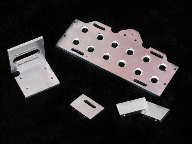

This were some of the parts btw, which imo were pretty nicely made for the tools I had: http://i424.photobucket.com/albums/pp328/Patrickbottcher/Losi%20LST%20Project/LST1dot5/IMG_2649.jpg

Yup good job buddy don't need fancy tools to get pro results if you have a lil skill and are patient :-)
Drilling the pulley out is piss easy you wont have any probs.

Update!

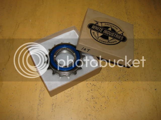

Today I FINALLY (it took 1,5 month....) got my HC package! Some pics of the items from the HC package and some other ones I got a few days before:
ENO 16T Freewheel
Paint! Correct: the bike will be Black, Green and Pink! :mrgreen:
Adapter for the ENO freewheel with 1/2" bore from Matt
The awesome package that came today from HC! 1000Watt charger, 2* 5S LiPo's, 8mm Bullet connectors, UBEC, Servo tester and the...... MEGAHUGEMEGAMONSTER Motor! This motor is sooooooooooooooo huge, big and heavy! Totally awesome!
My sexy hand + XXXXXL motor
And I also ordered 2 extra 5S LiPo's a few weeks ago, this package is at the customs right now :(

Postby drewjet » Fri Aug 06, 2010 2:43 pm
Looks to be an interesting build.
Have you figured out your reduction method yet?
I would suggest staying away from the 5 mm Belt, It will NOT stand up to the abuse these motors can put out.

Postby AussieJester » Fri Aug 06, 2010 5:52 pm
Great to see you got a delivery of 'goods' :-) drewjet is correct on the 5mm belts when used on smaller diameter pulleys, final
drive belt on my cruiser worked fine though, only changed it as i wanted lil more top end speed.

Postby Byte » Wed Aug 18, 2010 4:08 pm
drewjet wrote:Looks to be an interesting build.
Well, my choice was actually to use a 5mm belt :P The first pulley would be 13T and the second one 72T, and I would try to get them as far as I can from each other so the more teeth grip on the pulley. (Sorry, I can't explain this well, I hope you know what I'm trying to say)
What would you recommend? Chain? Gears?
AussieJester wrote:Great to see you got a delivery of 'goods' :-) drewjet is correct on the 5mm belts when used on smaller diameter pulleys, final
KiM
Hi Kim :)
How much teeth do your pulleys have on the cruiser? I've seen a few people who use the 5mm belts on this forum (with the same motor) without having any issues, so I thought it would be good enough for my bike too.

Postby Miles » Wed Aug 18, 2010 4:24 pm
If you want to use synchronous belts you need to give some attention to the specification, that's all.......

Postby drewjet » Wed Aug 18, 2010 4:32 pm
I had a 22 tooth on the small pulley and 72 on the large as received from Recumpence. It worked fine until I went to about 5000 watts. If you are going to drive it like a commuter, no problem. If you want to extract maximum power NO way. especially with only 13 teeth. Go to either #25 or 219 chain. #25 has held up well, though I did wear out a sprocket on mine in about 200 miles. Ideally I think It will take 219 to solve that issue. Now please note that my bike sees severe off-road condition, sand mud water, and I did NOT do proper chain cleaning after ( I am trying to be better about this now)

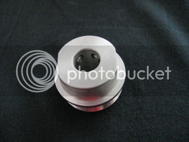

Postby Byte » Wed Aug 18, 2010 5:12 pm
@Miles: thank you for the link, but after reading what drewjet said I think I will go with chain drive.
@Drewjet: I DEFINITELY want to get the most power of it :mrgreen: I've searched a bit at sdp-si and found a #25 72T sprocket, which has a 1/2" bore, so that would be a direct fit. (https://sdp-si.com/eStore/PartDetail.asp?Opener=Group&PartID=50214&GroupID=585) I also saw a #25 14T sprocket, which has a 0.25" bore, this would be too small (I need a 12mm bore) but I could drill it out to a 12mm bore. The only problem which I can think is that the set screw will come loose as it will only be screwed in 4mm.
I made a thingy in paint to make it a bit clearer:
The black "hole" is the 12mm bore which I would drill in.
Do you think 4mm will be enough?

Postby drewjet » Wed Aug 18, 2010 11:13 pm
12mm are tough, there isn't much out there. I have an Astro and it's 3/8, plenty of choices for me...sorry
You could get the shaft turned down
