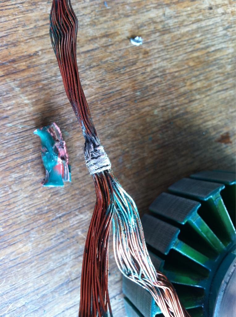

Postby bigmoose » Tue Nov 15, 2011 8:47 am
So it doesn't get lost, this from post 103 in the Lazair reference:
Upon inspection after the last flight, I noticed what appeared to be solder spray that had landed on some stator windings of both motors. After disassembling both motors I found that the Y node of the WYE wound motor windings had overheated and the solder from the node had melted and migrated out, onto the windings. Although the node was still mechanically sound because I had wrapped the joint with fine stands of wire while I was soldering it, the overheated joint was a likely source of additional heating. I was lucky that the joint did not completely fail and destroy my motor controller again.
In hindsight I should not have buried this soldered Y node deep inside the motor windings, the hottest section of the motor. Currently I am beginning the rewinding process on both motors again but this significant delay in testing has forced me to cancel my cross country plans. I still hope to be able to fly the plane at Oshkosh.
Needless to say, I will terminate all 6 of the winding ends outside the stator area this time.
bigMoose's electronic pieces & parts (GENUINE IRFB4110Pbf's, Nomex 410, AntiCorrosion Grease, Current Sensors) available HERE.

bigmoose wrote:So it doesn't get lost, this from post 103 in the Lazair reference:
I have had a bit of a read through that thread late last night BiGMooSE i spotted that
issue also ;-) I see he has moved to a couple of Joby motors now the Turnigys a little underpowered for
the high constant power he required... hrmz...i wonder if i could pick up the Turnigys cheap :-| :P
Cheers all for the interest, shall create a new thread when i start rewinding this and building a frame to mount her in...
or modify the existing one, seeing it will be trashed anywayz in favor of a replica chromo replacement...
