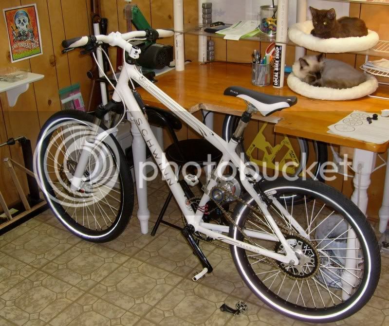

I. Frame and Motor/Drive unit
1st, my goal, Keep it a proficient peddler that safely uses bicycle components, yet fast enough to have fun! Safe means the power/speed doesn't stress the bicycle brakes, forks, wheels, ect. .to near 'failure' Fast IMO means getting to run in the final :D An extra challenge is lite/fast enough to fend off getting lapped.
Boy, the Swhalabee(s) fairly glow, even brighter on the street in the dark :!:
The frame; 1) extra wheelbase, 2) <69degree fork rake, 3) roomy chainstay
Kept coming back to this Schwinn GS; 42.6WB, 67rake, & 18.25" chainstay. Worried about it being Walmart quality, but the select 9 series is substantially beefier/higher quality.
The motor/drive. Almost went with a BMC600S but thanks goodness I perused the non-hub section of ES. If not for Matt's developments (and others supporting his drive), never would of considered RC. The Astro3210 was just the step up from BMC hubby. An analysis of Spooky Tooth racing verifies the 3210 has just enough umphh for some fun and a little racing (this is theoretical on paper, actual performance data later).
Oogle these: 1)Matts' throttle interface, 2) HV160 preprogramed w/ extra input caps, 3) Maguro throttle, 4) 130BCD sprocket adapter, 5) pair 1.5" motor mounts, 6) slipper clutch within large pulley! 2748 grams/6lb 1oz includes motor mounts; Thanks Matt.
If you're thinking of an RC build read this 1st :!: http://www.recumbents.com/wisil/e-bent/rc_drive/tutorial.htm

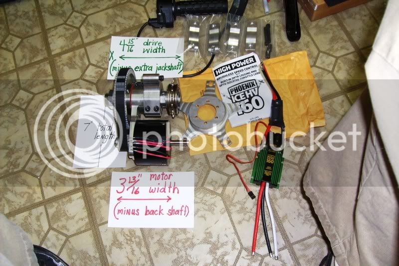

To start with, consider the low speeds of your gearing as well as top speeds. The CC HV160 doesn't like to be loaded at low speeds. Maybe 40mph seems a desirable top speed but not a good idea for a single speed. I killed 1 HV160 learning this.
There's a 45T rear sprocket on a TopHat adapter as a single speed LH drive. In the future, may attempt a 2 speed and/or #25H or #219 chain. The Astro3210 8Turn/44V is rated at 169Kv, so 7400rpm or 6320 @ 85% reduces to about 13.3:1/34mph/24"wheel with 46T.
http://www.recumbents.com/wisil/e-bent/rc_drive/rc_drive_calculator.asp
Also, on the right side are 3 cogs, 12T, 15T, & 21T to be pedled in unison with the 3 speed chainring shifter. An 80-120 pedal cadence ranges 24-35mph with my 50T chainring, 12T cog, and 24" wheel.
The disc brake fitting, being taken by the LH drive, leaves cantilever braking at the rear. Yet going to a 24" wheel, from 26", requires relocated brake posts. Here the left side is almost done, just fill in epoxy and paint. Lots of grinding to do to get the right side ready. My experience with disc brakes at 45mph taught me that very little rear braking need be applied with 90% of the weight up front :!:
When selecting gearing, don't focus on top speeds. Low speeds are a primary factor in loading/heating the ESC and should be considered.

Took a couple of short runs, brisk enough up to 32mph no pedal, 34mph pedal assist. Runs 1400W at 32mph no pedal, 1200W at 34mph w/ assist.
Just what the limits of heat soaking are is taking some time to pin point. Apparently the ESC allows the motor to draw 100+ amps regardless of what settings are used in the ESC and CA! At least for a few seconds. The 8T motor is rated for 48V/47amp continous; guess around 63amp for 60sec. However, if run at 80+ amps for 30 sec., the motor tends to get into a cycle of any power applied just turns into more heat. A 15min cool down is then required. *See Conclusions; page 9
50amp riding is a pleasure with moderately brisk acceleration up into the low 30's. If one is reaching and holding cruise, allowing the amp draw to drop (40, 30, even 20amp) for a while, then applying 60+amp works out. If hard on/off throttle is your ride, best to keep below 60amp. This isn't inconvenient if you are geared about or below 30mph. For pleasure cruising, 32-34mph is nice gearing, for hotdogging gear lower. If you don't mind having to monitor your CA and are looking for performance, multiple gearing to get motor loading minimal, would be the ticket. Around 39-40mph, 180lb, hi-pressure street tires, tucked position, fresh lipo charge, is the max countinous power that can be expected. 37mph more of an average top continous speed.
For occassional play, the motor tolerates some abuse. Running 90amp for 30 seconds gives one a sense of what a 3220 could do more continously :wink:

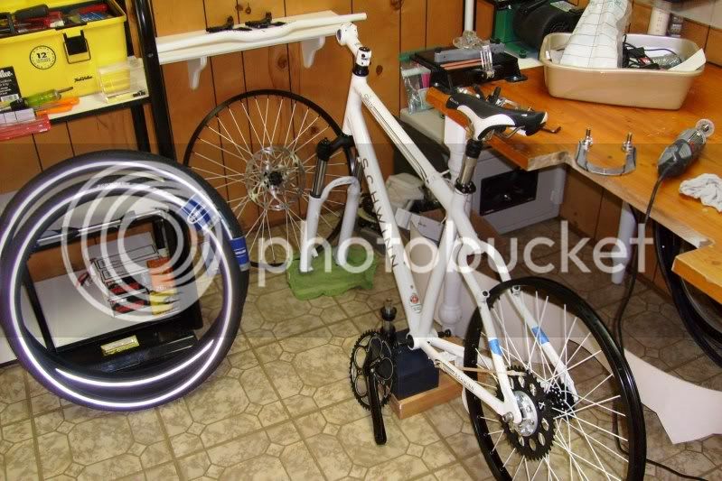

Grinding was exhastive. The brake post I thought was ready but needed a little more, then a little more. I used large small dremels to cut and grind, burned up the small one in the process. The 'on sale' cranks I bought didn't fit, but had the right number splines, also there wasn't any other type of bottom bracket/crank set that looked close. Some mechanic, that I don't know, at the LBS told me I had the wrong bottom bracket, something about tabs, There aren't any tabs associated with the bottom bracket. After much pounding, grinding, touch up painting, got the left done. I took my dremels, preshaped the splines, and the right side snugly fit after a few wacks with the rubber mallet :)

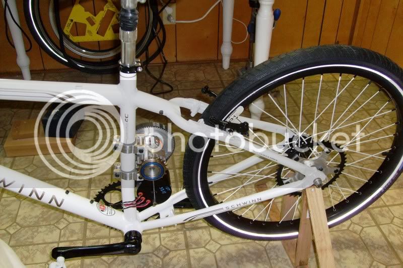

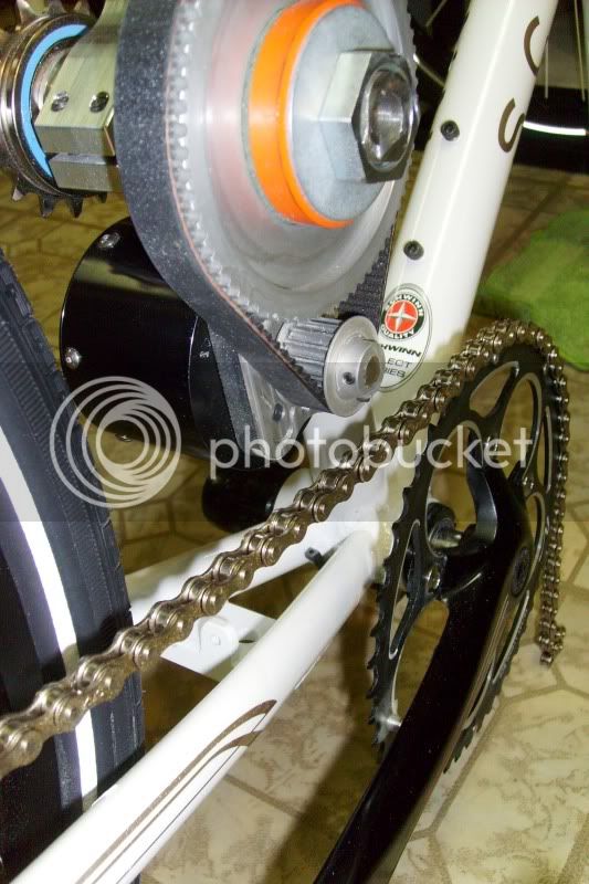

Also switched to Matt's 130BCD sprocket adapter as it's lighter and offsets further inward toward the spokes enabling the LH drive chain to align.
After moving the motor/drive unit up a half inch several times, this location appears feasable. The chain path on the Left and one on the Right align, as well as the drive pulleys clear the crank/pedal path. Of course I trimmed both the motor and jackshaft.
Got a wrong front axle adapter from Jenson, the difference between a '120mm to QR' or a 'QR to 120mm' grrrr :evil:
Looks good so far.
Bear in mind, when you first run the drive, the clutch may not be set correctly for your setup. So, it may need to be adjusted to allow more or less slip depending on the specific needs.

It is super simple. You see that huge nut on the end of the clutch? Loosten the two set screws (2mm allen wrench) and tighten the large nut for more clutch grab, or loosten it for more slip. I normally adjust the clutch about 12th of a turn at a time or even less. I just loosten the set screws, then move the big nut a tiny bit, lightly snug the set screws (you do not want to ruin the threads for the big nut), and try it out. If it is not quite perfect, I repeat the process. It only takes a couple minutes to get it dialed in. No problem at all.

No mudguard, but I regret not leaving the brake adapter in 1 solid piece rather than cutting the center part out as it would've acted as a partial mudguard. Its' purpose is a fair weather fun bike and hopefully can double to 'play' race a few times. Won't be hauling groceries on this set of wheels :wink:
Had a few hardware mismatches to work thru, needed to shim the motor mounts, and my famous(infamous) kittens caused another mishap. Noticed 1 playing with my 'titanium' front axle skewer nut. Being the diameter of a dime and some 6-7mm thick, didn't think it'd get too lost. Later my wife and I took the house apart looking for it to no avail; We wonder if he swallowed it :?: So much for $40 titanium skewers and organized spoke nipple sets :|
Put some handgrips on it that look as a killer whale, thus I may dub this bike "Orca." (ToyRacer final name) Also remeasured the wheelbase, the 24" rear wheel and front forks produced a longesh 44" wheelbase :p
Monday(12/6) I'll have the bicycle components and 2 chains in place, everything but the electrics. Will post pictures, looks different, like a racing e-bike IMO.
Looks good man! You even splurged and got the slipper clutch. What happened to the disk brake mounts? I don't see any in the pic. Are you planning on making the spooky tooth race this spring?
Yep, here's todays' foto; still have to adjust out a few things, find the parts and fit in the singleator/chain tensioner, but am ready to solder Lipo harnesses, fit batts in a carrier, and beg for help how to hook up wiring :!: This 12/10 weekend this weekend. .

Chain is good 'ole 1/8" bmx nickel plated, think the side plates is the major contributer to the strength.http://www.gizmology.net/sprockets.htmhttp://www.cantitoeroad.com/catalog/index.php?cPath=28_47&osCsid=30e4b158acb0a525e5354414c6629ad5
However, I'm eyeing the #219. Would love to get a #219 freewheel to fit, then machine down the rear adapter to fit BCD110mm, adapt the 219Kevlar sprockets to that, and for a finale double the back sprockets and use a second derailer on the chainstay to get a 2 speeder :mrgreen:

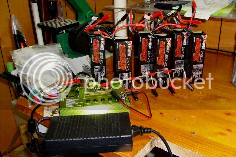

This is where I'm at as of Fri.12/10:
There's the 6 lipo batts, 25C 5000mah; the 2 on the left are paired in series. Made 2 12ga harnesses w/ Andersons.
#1 Could the other 4 batts also be plugged together (series) for 2 more pair (3 pair total) :?: making pairs 1a&1b, 2a&2b, 3a&3b.
#2 Then connect 3 red+ leads of batt 1a, 2a, 3a to the red harness; connect 3 black leads of 1b, 2b, 3b to the black harness; (is this 12S3P) and plug the red & black harnesses to the charger :?:
or,
Should I separate the series pairs and charge: a)only 1 batt at a time, b)only 3 in parallel :?:
(edit reply to Matt: knowing I can charge in 12S3P configuration opens a few possibilities; have 2 chargers, plan to get more Lipo :p )
