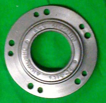

Postby MotoMel » Wed May 23, 2012 10:43 pm
We had ACS make up a batch of custom flanged freewheels (based on Crossfire) with 5 threaded 5mm holes and 5 unthreaded holes for 5mm screws, so that you can attach unthreaded or threaded chainrings to them. That makes them pretty versatile. If anybody is interested, we can put them up in the for sale area. Here are a couple of photos:

Postby MotoMel » Thu May 24, 2012 4:24 pm
Hi CNCAddict. Are you asking about the custom ACS freewheels?
Hole location is the same, and the units are interchangeable. The White Industries freewheels are slightly thicker if I recall: wider and maybe even taller shoulders by .5mm or so. The ACS might have a partial mm taller flange; the ACS flange is just barely taller and barely thinner than Dicta. Is that any help?
