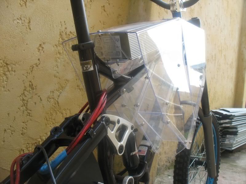

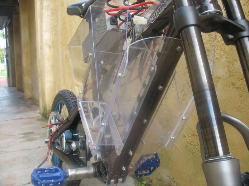

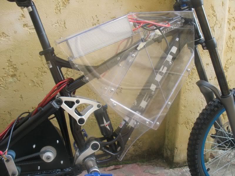

I have basically finished the battery box now, other than covering it with the carbon fibre vinyl which should be in the post.
The box appears fairly large however it all feels fine between my legs, not too wide.
