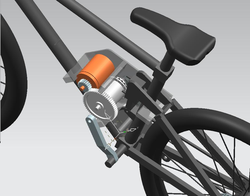

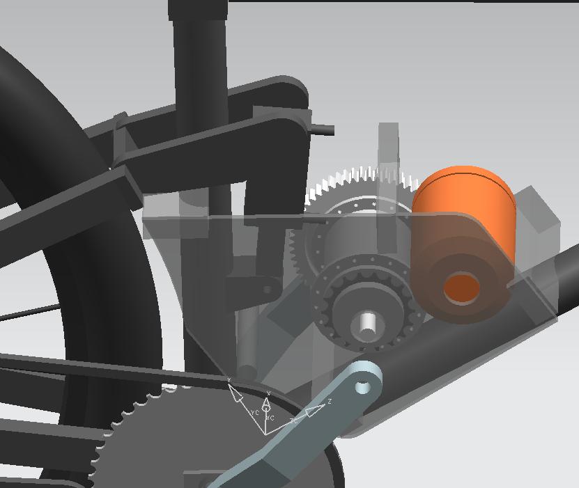

Thud, how bad of an idea is the "#40-16T-BB idler sprocket" for the 2nd gear dog setup?? Can you help with a better? ;) :)
Here is where I'm at now with sizes of all sprockets in the drawing are accurate for:
20.5" wheel, stock 80-100-130kv at 44.4volts with 5300rpm at the motor...
1st gear; 15:1 reduction=21.62mph
2nd gear: 7.875:1 reduction=41.18mph
I'm probably way off, in fact I am probably not even close...am I? I'm still using that "RC" speed calc... :roll:
8) Thud, I'd ideally like something like this for my 2nd gear. How did this work out for you with the BB's? If you can help me I'd be able to go with #35 on the 2nd gear side too, I think, ya'know..?

Postby Thud » Mon Jan 30, 2012 7:31 am
hello J,
The ball bearings are overkill. I ended up with a bronze bushing that is a straight press into a 5/8" bored sprocket.
I also enlogated the engdgment pockets for a little more room.(easyer engadgment)
my math on your gearing is:
corrected for actual KV133 low=24.6 mph
High=46.0 mph

Postby GITech » Wed Feb 01, 2012 3:15 pm
I think I found what will work for the 2nd gear as per your advice Thud,
This gear: http://www.surpluscenter.com/item.asp?c ... -2413-15-D (maybe one with more teeth would be better to clear the lovejoy OD?)
with this bushing: http://www.belarusagsupply.com/LIFT-ARM ... p_686.html
and engaged with this lovejoy: http://www.surpluscenter.com/item.asp?i ... powerTrans
Are these parts something you would be able to work with if you were to do the modding on them?
That bushing will also hopefully allow me to use the 7/8"ID Morse Torque limiter that was sent to me as the wrong size ID, as well? This should make it fit the shaft, but I will probably have to cut a groove out of the bushing and make a custom key tall enough to make it from the keyway in the 5/8" jackshaft to the keyway in the 7/8"ID of the TL. They refunded my money and let me keep it! ..so it turns out I got it and the full "repair kit" I ordered to go with it for FREE! :mrgreen: How would you go about making it work, or is 'this' idea sound?
Also, a slight redesign is in order now that I have the TL in sketchup, something more like this:

Postby Thud » Tue Feb 07, 2012 7:32 pm
I'll pm you a shipping address & open up some drive sprockets to 12mm.
i run a ton of power through dimpled shafts & set screws....but if i had the option for a key...i'd take it.
Making dog pockets is another matter. Its a bunch of work requiring some fixturing & time....which is allways in short supply these days.
get some......

Postby GITech » Tue Feb 07, 2012 8:26 pm
Thanks Thud!
I'll have one motor pinion for you to do.
I understand if your too busy. I'd just love for you to be the one to do the job of the dog clutch 'cause your the master! :D
I'll have these parts to do the job with:
1. https://www.surpluscenter.com/item.asp? ... m=1-3420-G
2. https://www.surpluscenter.com/item.asp? ... -2413-18-D
I think, the gear would need dog windows, and the lovejoy would need the ID of the tips of the 'dogs' opened to just larger than 7/8" (and so they will fit into the dog windows created). (?)
I'd do my best to compensate you for your time! ;) :D
Thanks,
Jay

Postby GITech » Wed Feb 08, 2012 2:12 pm
I hear ya e-racer! I'm already looking at changes, posibly making parts I already ordered obsolete... :roll: I'm sure no matter how much I try do do it all in one build there will be future itterations!
I'm also quite sure one side will be done before the other as each of the 5-6 parts that go on the wheel/hub itself are each more expensive than an entire order of smaller sprockets and stuff for the rest of the transmision from Surplus Center!! :evil: Ie; an ENO 22T freewheel and broching it, an adapter for the FW to a large sprocket (preferably an itteration of my "Shock Relief FW adaptor), a Top-Hat, and 2 big custom sprockets. :shock: Boy, I have a long way to go..!
Thud, there's a post on the previous page for you too.
If you can't do dog windows, how about instead of putting windows in the 18T, #35, 7/8"ID, type-B spocket... I just use another L-075 lovejoy (with a 7/8"ID for the bushing) and an 18T #35 type-A sprocket bored to 1.75" to fit the lovejoy OD, and weld it to this freewheeling lovejoy?
Could you open an 18T #35 type-A sprocket to 1.75" ID?
Only thing about this idea that concerns me is it may take up more room and I don't have much to spare. With the windows cut right into the face of a type-B sprocket I figured I only would have about 1/8" of space for the lovejoy to clear the sprocket when not engaged. Maybe for this second idea I could get away with welding the type-A sprocket right out on the couplings dogs so that their tips are flush with the face of the sprocket?
Oh, or, instead of buying a type-A sprocket...just boring out the type-B sprocket already ordered to 1.75" if there is enough material on its' hub?
Thanks,

Postby Thud » Wed Feb 08, 2012 4:46 pm
GITech wrote:Could you open an 18T #35 type-A sprocket to 1.75" ID?
Thanks,
Jay
J,
I actually like this idea. it would be ready made dogs...& simple lathe work....with a stop at the tig welder to lock it all together. I'll see if i get time tonight to make a couple skecthes of the parts & post the senarios up here.
the love joy could be inserted to flush & its ready made pockets without a bunch of fiddling about with a rotary table on my flexy mill.
Backside & overall width of the assembly can be trimed with a cut off operation.
Good out of the box thinking!

Postby Thud » Thu Feb 09, 2012 2:17 pm
looks like the smallest canidate for a lovejoy dog application will be 21T (2"hub diameter)
looks like this:
bottom is a raw sprocket
(going clockwise)
then its opend to a light press fit of the lovejoy
lovejoy in position
back side look..
Total guess on the all the lovejoy dimensions other than the diameter.
get some......
Thud

Postby GITech » Thu Feb 09, 2012 4:05 pm
Awesome! :shock: :twisted:
The tooth count doesn't scare me. A spur of 54-58 tooth is still totally fine!
It's yours! Take the idea and run with it Thud!
No need to cut it shorter, having the dogs even with the face of the gear is what was needed. Perfect! I'd bet we've also increased the torque handling of the L075 quite a bit too! 8)
Here's another thought I had; what about using a 5/8 x 7/8 x 1" roller bearing: http://www.vxb.com/Merchant2/merchant.m ... &offset=60
I don't think either of the pics are really for the 1" long version. :roll: Anyway, I think the L075 is ~1" long total and this would allow extended support out into the 'unsupported' dog area, directly under the gear mid-line. The only thing is I'm not sure how the rollers would would do over the opening of the keyway, but the bearing won't be under any load when freewheeling, so it might be just fine..?
Would you also like to take a shot at the SRFWA? You can have that too if you make it a reality! I have no machines or real capitol so.. :) We could explore different ways to design it here in this thread (or through PM if you wanna keep it secret, hehe).
I am making another shopping cart at surpluscenter, I'm thinking I should have it sent directly to you? It would include 3' of 5/8" keyed shafting (you keep the extra), a 7/8"ID L075, a #35 21T type-B sprocket, 13t 14t and 15t motor pinions so I can change my overall gear ratio with one sprocket change. (I also have an order coming to my house I will need to send you some parts from). Addy PM?
Later,
Jay
Edit:
What about this bad boy: http://www.surpluscenter.com/item.asp?i ... powerTrans If they will replenish stock..
Or this one, more in stock: http://www.surpluscenter.com/item.asp?i ... powerTrans
Cheap and less to machine!!! :shock:
