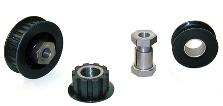

SDP-SI sells the "Shaft-loc" coupler. It is an expanding compression-bushing that connects a smooth-bore pulley to a smooth round shaft. The Shaft-loc is one of several ways to connect one family of pulleys to various shaft diameters.
Shaft-loc pulleys are cast plastic, with a metal center. The ones I am interested in have a 3/4" (0.750") smooth bore. There are parts available to attach these to an 8mm, 10mm, 12mm, or 1/2" shaft.
https://sdp-si.com/eStore/Direct.asp?GroupID=273
There is a wider choice of pulley tooth-counts available if you only need a flange (guide-plate) on one side of the pulley (rather than 2, one on each side). The Gates pulley tutorial stated that if one of the pulleys has only one flange, then the belt is easily loosened for changing with a tiny shaft-mount adjustment, rather than the motor or jack-shaft needing to be moved a lot. Also, it is common to have one pulley with a single flange on one side, and the other pulley also having a single flange, but its flange is mounted opposite of the first one.
If using the Shaft-loc system, you can add a wide washer/disc on one side to create a second flange if desired. There is a 19 different tooth-count range of 5mm-HTD Shaft-loc pulleys with a metal 0.750" dia bore. (20T, 22T, 24T, 28T, etc)
20-tooth, 1.25" diameter, $16 (plus tax and shipping)
80-tooth, 5.00" diameter, $23
$23...Shaft-loc 0.500"ID-0.750"OD compression-bushing
$6...0.500" OD-to-Metric ID "bore reducer" sleeve for attaching to an 8mm, 10mm, or 12m shaft
