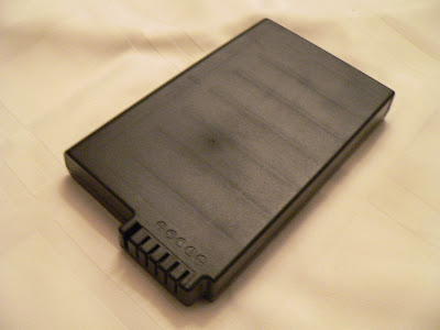

Hi Everyone
This is my first post on here, so a I have a fair number of questions.
I have a Costco Schwinn MidTown bike that I have converted with e-bikekit 500w direct drive rear motor kit which I was able to pick up at a local bike shop as a 36volt 9ah lead acid kit.
In seeing this thread I was inspired to peak around on e-bay and managed to email a seller who didn’t have a “make an offer enabled” an offer after a lot of brand new manufacture surplus batteries expired.
My accepted offer was only $50.00 +SH for 24 NBP001197-00 laptop batteries so I don’t have much into it.
The specs for these batteries are:
11.1V at 6600mah so I am assuming they are an internal 3s3p configuration at 2200mah?
In reading DrkAngel’s post 2600mah cells are current design so having 2200mah cells could indicate older cells that might have self-destructed though age?
I see laptop packs in generally 10.6v and 11.1v configurations what’s the difference? At 4.2v max voltage for a li-ion wouldn’t a full charge be 12.6 volts? Are they being conservative because they are not balance charging in a laptop battery pack?
Should I try to use these packs as is; or proceed directly to salvaging and testing the cells? If I wanted to use them without breaking them up, how would I capacities test them?
Or should I add balance wires so that they can be balance charged? If doing that should I charge to 11.6 or 12.6 volts?
I have a “Thunder T6 Multi-LiPo Battery Charger (4X 6-Cell) Professional Balance Charger/DisCharger w/ LCD Display” on order.

Postby DrkAngel » Tue Jun 05, 2012 10:10 am
Li-ions have been variously rated as 3.6V (10.8V) or 3.7V (11.1V)/
You might think that the 3.6V would have less energy?
Strangely, in my testing, I have seen that a 3.6V had usable energy down to the 3.6V point ... while a 3.7V had little energy below the 3.7V point.
As for peak charging voltage, I determined this by testing the usable capacity by 100th of a volt.
Different "formulations" showed a wide variance of "usable range".
For example this 3.6V 2600mah cell displayed substantial "usable, from 3.6V through 4.2V.
While this 3.7V 2160mah cell (lipo) held little usable above 4.1V or below 3.7V.
Lithiums - mAh/100th V - Discharge Tests
I would recommend 4.15V(x3 = 12.45V) to 3.7V(x3 = 11.1V) as a very safe, long life , reasonable range.
Modify this by observation-testing, if there is substantial energy at higher and lower voltages, I say, it.s OK to use it.
It is when you try to scrape the small bits of energy that you damage the cells.
As for using the batteries "in packs", you will be using a multitude of parallel circuits, amplifying the complexity and limiting redundancies.
I would say it's best to remove cells and build into a pack, with balance wires-circuit.
Leave cells connected to each other - makes "build" much easier ... usually!
as for determining "isolated power supply-charger" :
Quick check - While charging 2 separated banks, run a voltage meter from 1 ground to the other positive, if 0V read, then should be "isolated".
But! I would recommend placing a small fuse (5A?) "in line" on each bank, at least during initial charging-test!

Postby HypnoToad » Sat Jun 09, 2012 1:32 pm
Just finished reading this thread, it's rather long but there's lots of great info here.
I'm almost done doing a 18650 based pack, 10s 6p, I'll post some photo's when I can.
Today I was wiring up my balance cables to the pack, and I accidentally shorted out 2 of the wires with my cable cutters.
The short was only brief, but I still produced a few sparks. :shock:
Did I cause any damage to my cells at all?
All the voltages still measure ok, I balanced all the packs before paralleling them up and they're mostly around 4.082v per cell.

Postby DrkAngel » Sat Jun 09, 2012 1:57 pm
HypnoToad wrote:Just finished reading this thread, it's rather long but there's lots of great info here.
If the individual cells measure OK, then no problem.
"Typical" balance cables are light enough that damage is unlikely.
37V ~15Ah? 15Ah is a bit lacking, unless you're running <350w.
Might be OK, with pedal assist - getting started and on hills etc.
Highly recommend adding a few extra "p" - 20Ah minimum, 30Ah recommended.
But mainly ... to fit your use.

Postby HypnoToad » Sat Jun 09, 2012 6:54 pm
The more the merrier!
I actually shorted out the tabs on the cells as opposed to the balance wires, the short was between 2 cells in series and left a black mark on my wire cutters! :shock: Still the voltages are ok, and it was only a brief short. I'm trying to be a little more careful now. ;)
I was thinking 6p may be enough, but after seeing some of the 20p monster battery packs in this thread I'm now not so sure. I did start building it before even finding this thread however, and it was the most I can fit in the bikes existing battery mount. The bike is an Ezee Forza, which only has a 250W motor, so I guess 6p may be ok? Even so I've ordered one of those voltage monitor things, and if I'm getting too much voltage sag then I can always build a 2nd pack and run then in parallel. The bike did originally have a 10Ah Li-ion battery apparently, I bought the bike without any battery however hence me having a go with 18650's.
I did make a typo, I'm actually making a 12s 6p pack, and I did use a different method to you guys here, as I only found this thread yesterday. I kept each laptop battery pack together, as opposed to removing each cell, here's my method in case you are interested:
I had identical laptop battery packs, and either all cells were good or all cells in each pack were dead. Each pack is 4s 2p, and I chose to keep the packs together, and charge and balance them with an RC charger before paralleling them up. I used an Imax B6 with the current set to 1.6 amps charging current, and it would take between 4 to 6 hours to balance charge each pack from empty.
Once charged and balanced, I compared the total voltage of each pack and also the voltage of each cell and tried to match voltages and capacities, and I ran 3 laptop battery packs in parallel giving me 3 x 4s 6p packs. Here's a photo of one of these packs, this is the middle pack and the numbers are for each set of cells in series:
After insulating each pack I then put each pack end-to-end as I need a long thin pack to fit my battery mount, then I soldered the tabs together in order to parallel the packs:
And today I connected up the balance cables:
The short I made was actually between the tabs on the pack, but I've measured the cells voltage since the brief short and they all seem ok. I need to actually test this pack on the bike in order to really see how much current it can deliver.
I still need to solder on the main power cables and insulate the exposed connections, and once I've done that I'll make another post on how well it works.
Now I didn't test each cell individually, but I did find each pack did balance charge evenly and pretty quickly, and each 4s2p pacl had a capacity between 4400mAh-4600mAh when charging from empty according to my iMax B6 charger, so can I assume that all my cells are good? If there were any bad ones then surely balancing would have taken much longer and I would have seen reduced capacity?
My reasoning behind my method is that the laptop originally kept the pack balanced, so I'd try and avoid breaking up packs if i could, and also this method means it's quicker to build larger packs, if you have a large lot of identical packs like I do.
I would be interested to hear people's thoughts on this method as I'm learning as I'm going along here, and this is my first attempt, and it would be good to know weather building a 2nd pack using this method is a good or bad idea?

Nimh like memory effect for totally drained Lipo 18650 batteries?
In a previous post I mentioned buying 24 NBP001197-00 manufacture surplus batteries via e-bay, got them all in and was able to identify the internal wiring and measure the voltages which was nil on all of them!
All of them where factory sealed in their anti-static bags, but deader than a doornail when I opened them up!
This battery form factor was actually shared between manufactures which seems rare in hindsight. The part number NBP001197-00 sometimes referred to as DR202 has a number of specification power levels, some in 10.8 and others in 11.1 voltage and mAh ratings.
Most of the 11.1 voltage specs packs I can find under this part number are 6600mAh 9 cell packs, mine have no mAh rating on the batteries.
The batteries are blue in color and labeled LGR18650P A&TB JA61A or JA61B (assuming this last part is the lot number).
Are they supposed to be 2200 mAh batteries?
Using a Thunder T6 multi charger I am attempting to revive these packs by:
1. Charging at 0.9A in Nimh mode with voltage cut off at 12.5 volts for thirty to sixty minutes.
2. Balance charging in Lipo mode at 3.3Ah until full (thinking 0.5C charge rate).
3. Measuring discharge capacity with the charger
In a marathon session I managed to get 13 of the 24 charged in one day using the four channels on the T6.

When I capacity tested the first four it was an even bleaker result:
Capacity mAh
2381
2220
2941
3854
So an initial result of 33% to 58% of expected capacity, yuck!
In experimenting with the charger I discovered that I hadn’t actually balanced charged them even though the charger complained when the individual cell leads were not hooked. So I recharged the first two of them again in balanced mode and discharged them again. With the following result:
recharge mAh Capacity mAh
3650 3359
3751 3288
They bounced back almost an Amp in one cycle! This seems like the memory effect you have in Nimh?
How many cycles should I attempt this for? Any idea of percentage capacity I should be happy with?
Unfortunately the channels on the Thunder T6 are not isolated and its charge and discharge rates are kind of lopsided 50 Watt charge verses 5 Watt discharge per channel!
That leaves me two option discharge batteries as 3S pack at 0.4Amps or do them in 1S zones at 1.0Amps.
Which option do you think will recover the most capacity in these batteries?
I.E. Should I be as gentle as possible or since these batteries basically slowly suffocated on the shelf, give them a good knock on the head to stir up the fire?

Finding Recycleable Li-ion notebook batteries
Postby DrkAngel » Mon Jun 25, 2012 9:53 am
icecube57 wrote:I wanna know where are you sourcing these cells i maybe interested and making a tinkering with this even though I'm on the lipo bandwagon. I just got my icharger so I'm ready to f some s up.... or resurrect the dead... but seriously these laptop cells don't have enough C rating but the way I hypermile and barely sip 1-2A at 20mph I wouldn't mind a small light pack that i could possibly fit in my triangle and have it look stealthy.
Battery acquistion!
eBay, craigslist - search for lot, or batch, laptop, or notebook, batteries.
("Used" search option cuts down the item count, but you might miss some )
Local recycling centers
Large companies - many, swap all notebook batteries for new, ~semi-annually - ideal - same brand, age etc. & most all still good!
Hybrid pack!
One of my next trials will be to mate a RC Lipo pack to a recycled Li-ion (18650) pack.
The object being a good surge capability married to a cheap large capacity.
Any surge would be mostly covered by the RC portion, with the 18650 portion offering a modest addition, followed by a gradual replenishment of the RC.
Alternately, blocking diodes could "segregate" - limit battery outputs to the controller only.
Surge output would come from the RC and "normal" drain would come from the 18650's, until voltage equalizes.
Unfortunately, I have no motors requiring more than a 1C output, during surge.
Until ... I stick my ETEK 8-16HP into something, 300A @ 50-60V surge capable!
