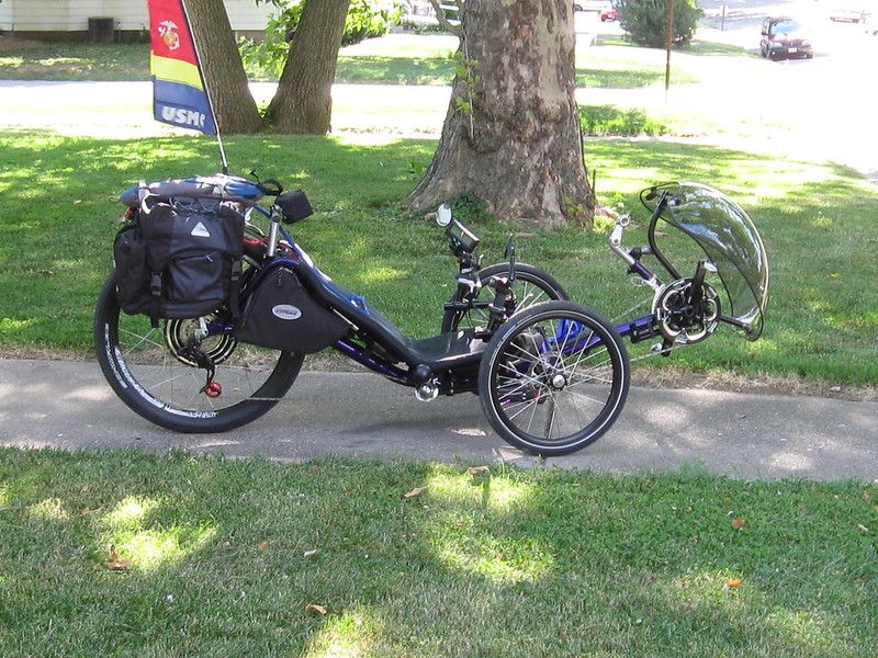

Also check out Utah Trikes as they have a large selection and pretty reasonable prices. Also great custom service.
otherDoc
edit: If you want full suspension, check out Cyclone.tw because their trike is cheap. We need a guinea pig to test one!

Postby docnjoj » Sat Jun 30, 2012 8:16 am
chopper_elec wrote:Here is one that i've been considering:
http://www.aliexpress.com/product-fm/57 ... alers.html
I just had a good look at that trike in your link and it does not have a suspension like they claim! I would buy local or at least a US dealer.
