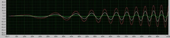

Postby zombiess » Wed Feb 08, 2012 12:58 pm
You should see the looks I get from people when I try to explain why someone was unable to log in to their computer, I fix it and then they actually want me to answer their question of why which then leads to a very simple answer of the time sync between a server and domain controllers was off. If they actually ask me why after that I try to do my best layman's explanation of time sync, RTC clock drift, kerberos tickets, replay attacks, NTP and the different stratums and domain authentication. Usually by the time I get to the explanation of time sync (the first one) they ask me to stop and thank me. Most have now learned to just stop asking why because they get one of two answers from me.
1. I have no clue but it works now (this happens pretty often but I usually have some idea what caused the problem but don't want to get into details)
2. I fixed and know why, but do you really want to know the details?
I could probably write several pages explaining this to a lay person since it's a pretty simple concept, but you really should have some sort of base knowledge of security and time sync, real time clock drift and NTP protocol to really get it without setting aside an hour for me to go into details / examples. It's really amazing how important and complex just keeping the same time can be when you have servers spread across the globe, not to mention getting windows to actually listen and re-sync the clock when you tell it to and not just ignore your command.
A little off topic, but still relevant.
Back on topic:
Thanks Lebowski!
