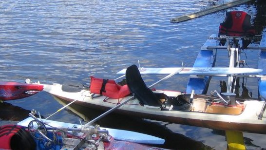

Postby www.recumbents.com » Tue Apr 21, 2009 12:14 pm
Hi Guys,
My pedal powered kayak is located in the Chicago suburbs.
Straight line stabilty is scary but managable without any amas (side floats). When you turn, the boat leans into the turn, which is fine. As you are going through the turn, you naturally become upright again, also fine. When you turn the rudder again to go straight, you are then leaned to the outside or the turn, which is really scary.
Because of this I added the floats shown in the picture. They just skip along the wave tops and don't add much drag, if any. The boat feels very safe with the side floats.
This is a 20 ft boat, and it is very fast. I have been racing it once per year, but now I want to build a new one...
-Warren.

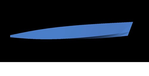

I've been doing a fair bit of reading up on low resistance hull design, including looking long and hard at some of the simple designs from Phil Bolger. I keep getting drawn back to the slipper launch though, as it's surprisingly simple in construction. I've drawn up a tandem two seat slipper hull, for ply stitch-and-glue construction, using this excellent shareware layout designer: http://www.carlsondesign.com/#Utilities (scroll down to "hull designer"). Here's a simple graphic model - I think I have the proportions about right now. I've narrowed the beam to better suit the reduced overall length (15'8") and keep the boat in proportion. The hull is flat bottomed at the stern and the transom sits just clear of the water for low drag. The hull panels will just fit on four sheets of ply.
Jeremy

Looks good! You've certainly done your homework. Shouldn't take too much to get it up on its step.
