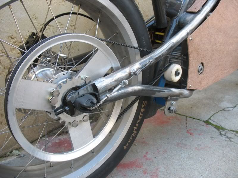

Postby 1000w » Fri May 22, 2009 3:12 am
Here are some photos of the rear pulley drive I fabricated using a standard 10" V belt pulley and a offset rear sprocket.
The plan is to use a GT toothed belt with this flat pulley.
Toothed pulleys this large are not available "of the shelf" and on the advice of recumpence (Matt) there should be enough belt contact for a flat pulley to work.
Cheers,
Matt.

Postby 1000w » Fri May 29, 2009 2:04 am
A small update. The motor is now mounted and allined with the rear pulley.
Puchased this belt tensioner and installed a skate board wheel.
This is probably where the tensioner will be mounted.
Cheers,
Matt.

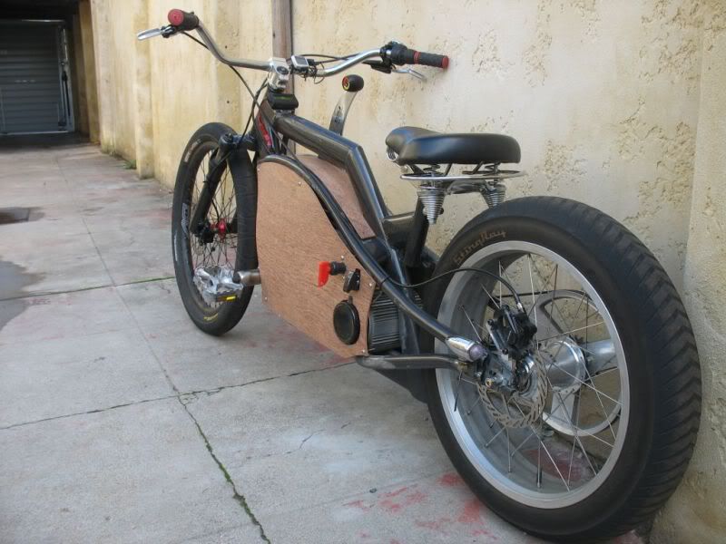

Postby 1000w » Sun Jun 07, 2009 7:19 am
I made some timber battery/motor covers out of 3mm ply wood today.
The open front will allow air cooling for the motor and the controller which will sit on top of the battery.
These covers will be clear coated probably with a satin finish.
Cheers,
Matt.

Re: Cyclone 1000w Cruiser
Postby 1000w » Sun Jun 21, 2009 12:03 am
Had some progress recently.
I have taken it for two small test runs and I like it alot, especially the LiFePO4 battery.
I have got a fair bit of belt slip on the rear smooth pulley. I am using a 9mm belt for testing as the 15mm is out of stock. The 15mm may just give it enough grip.
The bike does work though, I just have to roll on the throttle slowly. I have easily done 60kmh today, so it feels good.
The wood panels are not finished yet, they will have an oil finish, so a little darker than now and they are not all bolted down properly yet.
The frame has to go for powder coating, not sure what colour to go with.
Here are some photos.

Postby JEB » Sun Jun 21, 2009 11:36 am
Hi Matt;
Great looking build! Years ago I had to use a small pitch cogg belt that there was not a stock pulley available, I turned a blank to the right size for the correct belt/tooth capture, put a release agent on a belt covered the belt and pully with epoxy, rapped it around the blank, rubber banded it, let it cure, pealed off the belt, cleaned up drips/runs, worked fine.
The epoxy that I used was the same as what the reflectors are held down with on the freeways. If it is still available, it has good grip/bond, also not as hard as to chip very easy.

Postby 1000w » Tue Jun 23, 2009 4:44 am
Hey JEB, thanks heaps for the great idea using epoxy. I have ordered a belt to do the molding and I have some epoxy ready to go. You are a champ.

Postby 1000w » Sat Jun 27, 2009 9:19 am
I tried JEB's idea of using epoxy to create some teeth on my rear pulley.
The results are looking very promising, thanks again JEB.
I have reasembled the bike tonight and had a very small test run, small due to rain, and the belt seems to run very smoothly with no slip.
Postby recumpence » Sat Jun 27, 2009 12:47 pm
That is awesome!
The only difficulty I can see in doing this with the epoxy is getting the pulley diameter just perfect. If it is not perfect, the teeth will not line up at the joining point and the mesh will be off. So, assuming the pulley diameter is perfect, this is a fantastic method!
Matt
recumpence
Posts: 4321
Joined: Sat Apr 19, 2008 8:33 am
Postby 1000w » Sat Jun 27, 2009 8:46 pm
Thats right Matt, the diameter being right was my biggest concern. To my amazement, this pulley was spot on when I wrapped the belt around, so I didn't have to revisit the lathe.
Matt the 9mm wide belt you suggested seems to work fine, however I think I will get the 15mm one when it is in stock.
The 15mm pulleys look a bit empty with a 9mm belt running on them.
Thanks for your help with this belt set up Matt.
Postby recumpence » Sat Jun 27, 2009 9:57 pm
Well, I am glad to help. But, you did have some belt slip. So my advice was not spot on for you. Part of it is belt width and part is tension. But, with the tooth idea, you are good to go! :D
Matt
Postby 1000w » Tue Jun 30, 2009 9:15 pm
Here are some photos of the bike ready for test rides, when it stops raining.
The frame needs to be stripped and powder coated, colour I am not sure, maybe red.
The wood panels are going to be a black carbon fiber finish.
Cheers,
Matt.

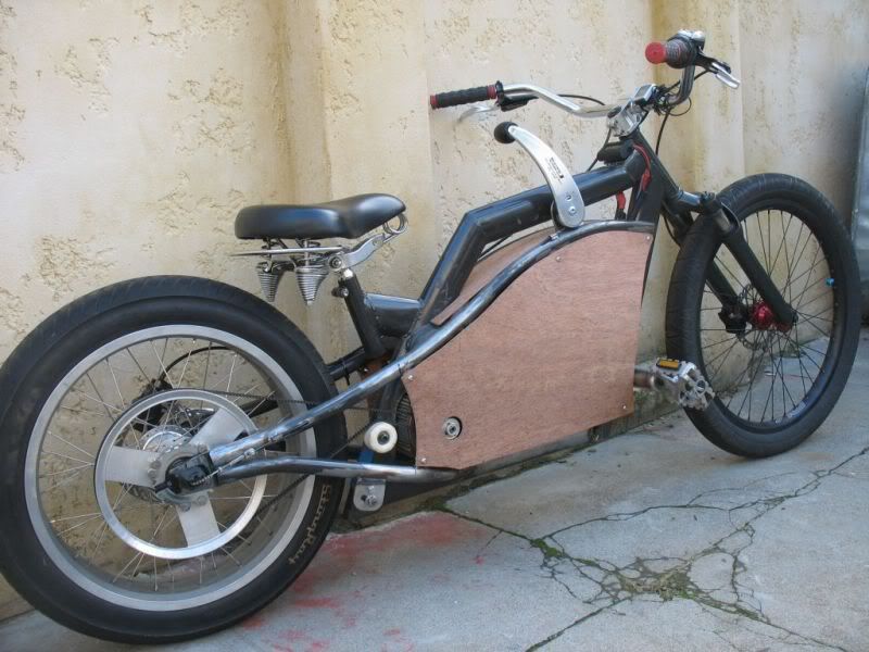

Postby 1000w » Thu Jul 02, 2009 8:34 am
I just got back from a 26km test ride. I am breaking the battery in at the moment, so not going too far, I used 9Ah.
Couldn't be happier, the bike is super quiet, has loads of pickup, and cruises nicely between 35 to 40kmh.
I am sold on LiFePo4 and belt drive.
