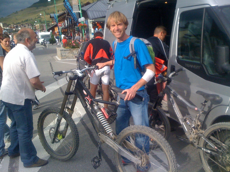

food for thought.... :twisted: 300mm front & rear, from here:
looks like offset shock/seat post supports. very interesting. anybody recognize the swingarm? or the frame?

GCinDC wrote:food for thought.... :twisted: 300mm front & rear, from here:
:shock: :shock: :shock:
now THAT is what I want to build for myself!! Imagine that with a 3220, or even... a TWIN 3220 and a kw'h or two of lipo??? Or even a greyborg hub in the rear?!? (pipe dreams galore!!) THAT is a serious contender for a mx bike. Mind you, im guessing most of us would probably get to excited and end up draining the bats in about 500m. But it'd be a FUN 500m. :twisted:

Postby amberwolf » Mon Nov 21, 2011 1:10 am
That swingarm vaguely looks like the one on here:
which i just got and will be likely installing whole (including wheel) on my new bike.
http://endless-sphere.com/forums/viewto ... 99#p493399
Most likely the one on there is from some similar but probably smaller dirtbike.

amberwolf wrote:swingarm vaguely looks like the one on here:
yes, those do look similar. thanks, amber. what's the largest diameter tire that will fit there? would a 24" fit? nevermind about the axle issues...

Postby amberwolf » Tue Nov 22, 2011 5:58 pm
Last night I took more pics over in that thread, but basically I think that swingarm IS the SAME one I have. It's on what I think is a Suzuki DR350 from 1990, maybe 91 or 92.
Both left and right sides are identical, and bolt onto a D-frame that actually contains the front pivot, so it would be a cakewalk to unbolt them from that D and build a new pivot like what htey have on there--it is exactly what I am planning to do on mine.
Then they probably just cut off the entire MC wheel dropout end (theirs are about that much shorter than mine), and drilled new holes for their own axle size instead.
So essentially, you could make it fit whatever size wheel you like, by having the bolted-on part sized correctly for that, including whatever width and dropout spacing you want. Plus it makes these sides parallel, rather than V shaped like most bicycles, if you want them that way. (I do).
On the MC I have it's an 18"x3.5", whcih I think comes out to closer to a 26" than 24" tire in bicycle size. I think 16" MC is closer to 24" bicycle, IIRC, but JRH could tell you for sure. For my own build I'll have to find someone that's tossing out a still-usable-for-me road slick type in that size for MC or Moped, cuz the knobby it has on there now would suck to ride on streets.
Either way, I'm sure it'll clear a 24" bicycle tire no problem, even a big fat one. :lol:
EDIT: I just did a comparison wiht some bike tires next to those wheels, and I'm off a bit: front is more like a 24" bike tire and rear would be a 22" if there is any such thing, cuz it's smaller than the 24 but bigger than the 20, and that's for the outer diameter. I didn't try comparing bead-vs-rim size.
Also, one of the dogs (Fred) got interested in what I was doing and perched on the other bike, so I snapped some pics, then Hachi had to get up there and chase her off, but almost pulled the bike down on herself, so I helped her up (and had to pose her a bit after the first pic) got pics of that, then Nana had to get up but she got spooked and almost put us all into a pile of squish. She did put her paws where I pointed, and stayed just long enough for the pics, but couldn't get down herself, so I had to sort of lift her down, whcih left us both panting on the floor. Got pics of them going up in the Pets thread for those interested--they look ridiculous.
