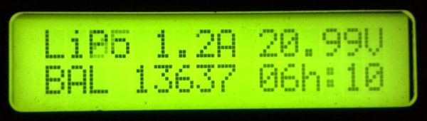

Postby GCinDC » Thu May 31, 2012 1:55 pm
perhaps not for long! after at 6 hours charging, 4 of which was balancing @~1-2A:
i'll check the bm6 voltages before and after my commute..
