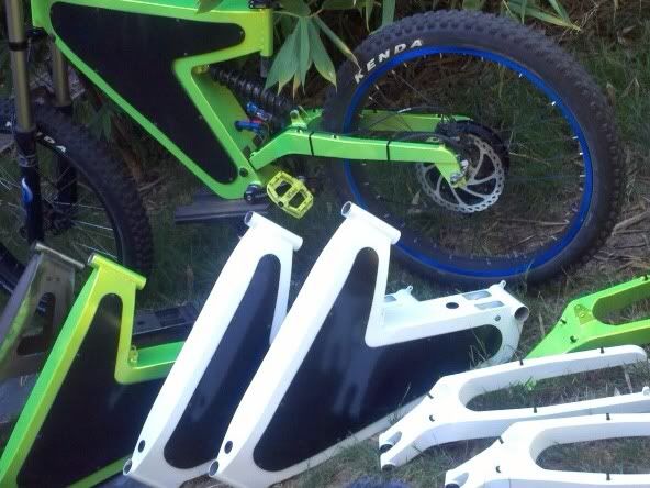

First 4 Frames

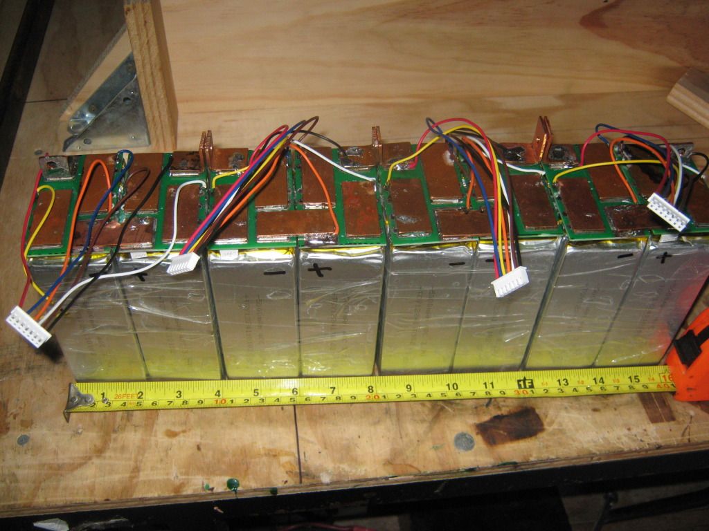

24s3p, 88 V nominal, 100 V hot off the charger and 84 V when it's spent. Length 400/150/81mms. Weight 12 kilos

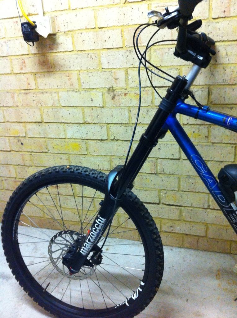

Marzocchi Forks
NS Bikes Trailmaster Rims
All set up and awaiting frame

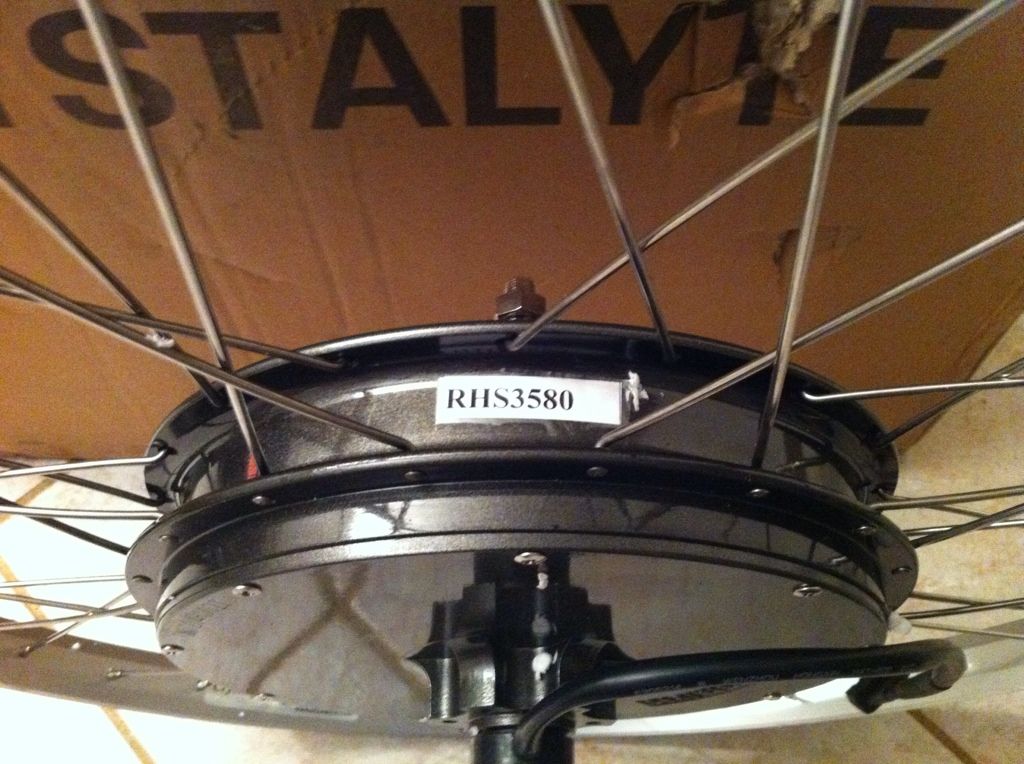

Picking up my H3580 Motor tomorrow. Will post a couple of picks when I get it.

Motor arrived today

Although you'll be running an RHS3580 (Really High Speed? :lol: ) and i use a HT3525 (84v hot) so you'd be waving me goodbye on the more open sections of track 'till we reach a hill :P
What AH is your battery setup?
You'll like the forks and shock, i've got an '09 888rcv and DHX5.0 and love 'em.
Whats the ETA on your frame?
You guna add cooling holes on the 3580?

Set the forks up on my old Giant Cadex with a 9C they feel real good.

Not sure what I'm going to do for cooling but from what I have read I will need to.

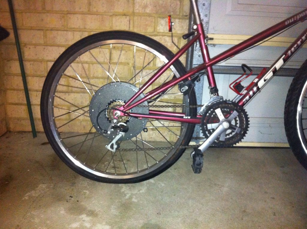

I have set up my crystallite 3580 in an old cromoly frame for testing.
Planning on using two 36 volt batterys in relay. Planning on trying this tomorrow.

Well the green frames currently somewhere between Sunny California and the now a bit sunnier UK :-)
