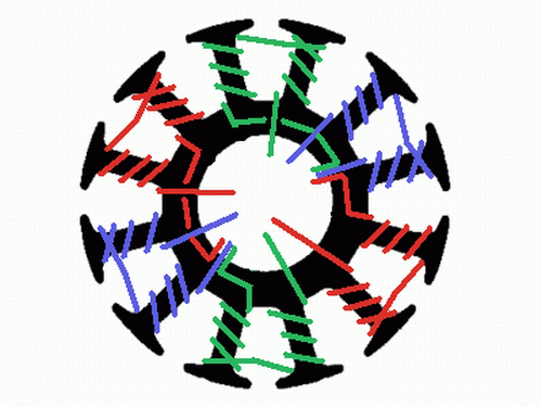

Is my winding scheme really dLRK?
It is two separate engines teminated in WYE with distribution over two teeth. The maths behind the KV compared to delta dLRK is 2/1,73=1,156, so it´s only 15% faster than Delta. 2 because it's half the turns in series and1,73 for the delta/WYE conversion. My motor with standard 8 turn and KV=130 would get a KV=130 * 1,156 = 150 rpm/V. So to get the same KV I would need to add 15,6% more turns, 8 * 1,156 = 9,248 turns. Here comes the scary part, I have 9,25 turns on each tooth if I count with the connecting wire between the distributed teeth's and gets a KV=129 (measured today).

Yeah, it is still dLRK even though you wound it with two sections. It should be twice the KV if you are running each group in parallel with the other side, as compared to a typical dLRK where Aa would be in series with the opposing aA.

Could you explain what it is in my winding scheme that makes it a dLRK?
Yes I have been calculating with twice the KV. (2*130)/1,73= 150, 150/1,156= 130.

12 slot 14 magnet winding AabBCcaABbcC is dLRK. Splitting the coils in half doesn't change this, although we could name it something fancy if you wanted.

I guess a more complete explanation might be called for. (This is my understanding, so feel free to correct me if I am wrong)
LRK is really just an easy way of winding a motor that has 6 stator teeth for every 7 magnets (it also works for motors with 6 teeth per 5 magnets). Basically their idea was that you just need to wind every second tooth with one coil that fills up the slots on either side of the tooth rather than winding every tooth so that each coil takes up 1/2 of the slots next to it. Doing this was faster, but there are issues with it. Number 1, it makes the waveform sharper than it would be, number 2, it is difficult to get a really good copper fill using regular winding techniques because the copper sort of blocks off the slot as you get it full and as you layer on the copper it tends to make a bee-hive type shape which becomes difficult to keep the wire where you want it, and Number 3, the thickness of the copper at the end of stator is 2x as thick because you have the same number of turns, but they all go around the same tooth, so you end up needing more space for the copper.
What is commonly referred to as DLRK in the RC groups really shouldn't be called that, it is really just the standard way of winding a stator with teeth:pole ratios of 6:7 or 6:5. Each pair of teeth is wound in different directions with the same wire.

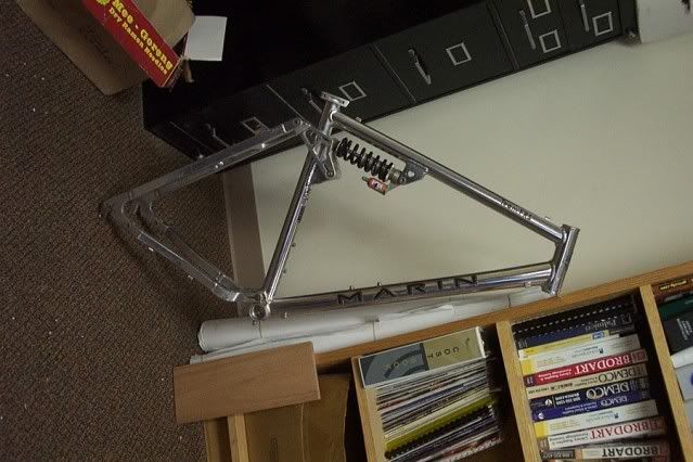

Thud wrote:Image
We'll see if I can build a 18kw power package I can get 15miles on 25ah's...under 70#s....
Alum frame, carbon fiber motor mounts & battery boxes, 20" wheelz full suspension......multi-championship winning rider (with internationl experiance if canada counts LOL :mrgreen: )
Hubs schmubs....GET SOME.
Back Later. Thud
Thud, I really like that frame, looks like plenty of space for Lithium goodness. What are your plans for drive? Left side, Dual freewheels, swing arm, through the chain, or something else? I really want a dual suspension MTB, but haven't found a drive I like for it yet. Somehow I think you will have something I like on this.

Postby Thud » Thu Sep 09, 2010 2:32 pm
I will be calling these "Congenital twin motors" for the time being :mrgreen:
drewjet, I picked that one for 2 reasons....#1 I was looking for Alumn, full sus, round tubes for clampin' too & it was cheap on fleabay & had everything:lol: & #2- it has a huge diamond & standard threaded BB. this wll be a suitble platform for a multi purpouse bike...I may need to fab a swing arm lower to fit my 2-1/2" tires. But I have Aj's motor to re-wind again tonight & a tranny that needs some fittin & anodising ASAP
(I did take the time to lace the rear wheel for this last night, watching the late news) I will show some pics when I have more to look at.
I modded a hub for a southpaw freewheel so I have every option open ATM. Somehow I thought Marin's were made in Marin CA. theres a made in Tiwan sticker on the BB. :lol:
The frame is well used but all the suspension points are Nice & slop free. I have a lighter air shock for it also & some chepo 4"travel forks....looking foward to getting this one rolling proper....no more Hoopty rides for Thud!
get some......

Postby Burtie » Thu Sep 09, 2010 2:47 pm
Thud,
Looking forward to the results of this re-rewind now that you have the stator lams sorted!
Should perform really well with all that extra copper you manage to cram in 8)
Are you planning to try the internal halls in this one?
Nice frame too! -what model of Marin is it? And why are you planning on such small diameter wheels?

Postby Thud » Thu Sep 09, 2010 3:44 pm
Hi Burtie,
I ran internal Halls in the video above, truthfully I am not happy with all the glueing them in & then not having any adjustability in them....(poke,poke, how is your adjustable timing circute coming BTW? poke) I have some tiny magnets inbound to make a small timing ring to fit the free end of the shaft & will bracket some halls there & see what comes from that. May even allow for few deg. advance on the fly when we want more rpms on the long straightaways.
The 20" wheels are for a road racing setup. I have Pirrelli 16" tires mounted up & plans for a front & rear faring. & a few more drive train experiments to see if we can't "mechanicly" unload a low resistance motor & keep the amps in range of a controller. So far I seem to be able to draw 250+ for too long when hot dogging & the bicycle stuff doesn't hold up....yet. I have a kart clutch & spring set up for an 800rpm engagment....we'll see if it launches alright.
The stuff that will hold up is to heavy to keep me interested....I'll go back to Hydro-carbon fuel & a real motorcyce if I have to ride a 190# vehicle.
Also smaller wheels opens space for my new 3 speed tranny & a proper chain tension/guide set up. & if it looks too goofy we can allways get back to conventional.....I am going for a more Aero-aproach than motard....but that could change any second LOL.
