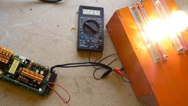

SUP BABY :D
4 of them pushing 12v bulbs in series
All of them power on together. All mods done. I love the click all the relays in them make, slightly out of time, as they power up.
I ended up setting all at the highest voltage I could get them. Between ~12.9v-13.2v, and no I'm not worried about the difference in voltage. You need to worry about that when they're in parallel.
Did 4 units today - coffee and the punk rock station on http://grooveshark.com
Stripping the lil wires was time consuming, but much quicker if you assembly line it.
