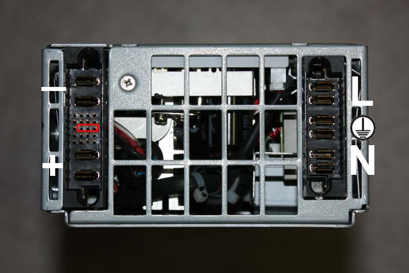

Postby ZOMGVTEK » Fri Oct 14, 2011 6:56 pm
Here's a place to discuss the HP ESP120 server power supply. Modifications, uses, sources, etc... Throw it in here!
I got only one to mess around with. These claim to require 200-240V input, at 20A! I will see if I can get it to power on at all off 120, but it would take at least a 30-40A breaker to get its rated power at that voltage...
First order of business is to determine where the power goes. These do not have an IEC on them. I would assume the top terminals are the mains in, probably ground in the center, but I can test continuity between the chassis and pins to confirm.

There are diagrams all over for this server supply.. and activating it. you need 220.
http://www.cnczone.com/forums/general_e ... _51_a.html
I have esp 115s, and with a small modification to the pins you can achieve an additional 1.3V I think. Maybe the same is true for this guy...

Postby hillzofvalp » Fri Oct 14, 2011 7:32 pm
Yeah, My initial post about this was in my thread on ev charging stations.. I want to put one of these on my bike rack and get J1772 going and 10 minute recharges. ;)
I want to know what this double pole/neutral fusing means:
"Connect together the three pins inside the red rectangle to activate the DC output."

Postby ZOMGVTEK » Fri Oct 14, 2011 8:11 pm
I assumed these supplies would be well documented, just didn't look around yet.
The DC ground goes not go to the chassis on these supplies. It looks like you should be able to get away with running them in series.
I can't see any way to raise/lower the output voltage. There is probably a way to do so...

Postby ZOMGVTEK » Sat Oct 15, 2011 10:47 pm
That little pot appears to do nothing to the 48V output.
These fans look like they sure can get loud...
AC in board. Fuses on each phase, caps going to ground on the two screws to the right. The only 'grounded' portion of the case is the metal section this board screws into, which in turn grounds the chassis to AC ground only.
DC out board. The thicker red/black wires with the ferrite appears to be the 5V rail. There's spots where caps can go to run the DC ground to the chassis, but they are absent.
Lots of stuff going on here. The pot on the top was covered in some silicone and did nothing to the output.
Fully unloaded output voltage. A few hundred mV of ripple unloaded.
The lighting in the basement always throws the white balance off, these will have to do.
The AC inlet happens to be conveniently labeled L G N right on the case.
I don't think I have any real use for a 48V supply, especially one that needs 240, so progress might be slow on modding this unit.
Overall design appears to be very good. There's probably a way to at least marginally adjust output voltage. It probably only goes up, however.

Postby hillzofvalp » Sun Oct 16, 2011 12:54 am
Sweet pics. Do u think this could be repackaged to gain a little more rack room? I suppose the cooling could be reworked
Try the pin route that I posted earlier. It's the long double spaced part.

Postby ZOMGVTEK » Sun Oct 16, 2011 9:53 am
It looks like there is a separate board for DC and AC. Past those two big transformers the board is separated, so you probably could reconfigure it a bit. However, the fans sure look like serious business, so this thing must really need some airflow at high power.
I don't have any 220V outlets here as well, I just shoved the romex into two adjacent breakers that had useless stuff on them. Probably not the best idea for long term use.
If you had a CC CV charger, you definitely could configure something to kill the supply at a preset voltage. However, there is no real use, since it would be best to have the output voltage set to exactly what you want your cells to be charged up to. I would imagine this supply would definitely not drop voltage to maintain its current limit, and would need something external to control the current for direct battery charging. If you had a CC CV charger, there would be little need to shut it off immediately after reaching HVC, so it wouldn't be really even needed. It would be dangerous to rely on using an external board to turn the power off when you are charging at such high power, and the output of the supply is above your intended HVC.

Postby hillzofvalp » Sun Oct 16, 2011 10:46 am
Thats great that it separates. Couod u measure each section.. Lxwxh?
