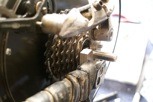

Hi,
I have finished my "no cut" drop out adapters for the Giant DH comp.
They turned out great, everything fitted perfect, which for a first shot I was pretty happy about.
I drew it all up in solidworks, then had the profiles lazer cut and turned the bosses and tig welded them together.
With the 150mm drop outs, there is heaps of room, the 9 speed cluster goes in fine, had to space the disk 6mm.
Motor dropped in, have retainer pins in case the nut loosens during riding. New disk and dérailleur mounts worked sweet.
Took like 5 minutes to swap the original wheel out for the electric.
Will finish the bike up in the next couple of days and show you the results.
I made 3 sets and sold em all allready. Will make some more. Not cheap. About $250US delivered.

Nice design!!! I like the way you moved the caliper from the origianl position. How thick is the steel you used?

The adapters are stainless steel, 10mm thick on the disk side, 12mm thick on the drive side.
The battery is mounted on what I call the "Fork Lift" rack on the front forks. This also houses the controller. The battery straps on, either in a bag or by its self. The 5kg of LiFeP04 is enough weight to have up front. Not so much the weight, the bike is nicely balanced with the motor in the back, but the inertia it causes on the steering is not so cool. Fine for commuting and trail riding, but not for mx or DH style riding. I was thinking I would go out and do some jumps for the camera, but after a bit of a ride this after noon, not so keen. Would rather have the weight on my back for that sort of shenanigans.

I have had a request for 135 adapters, can be done, wont be quite as strong, but sufficient. I cant see any reason to doubt the strength of the adapters, I think they could handle anything you can.
The Fork Lift I designed to fit a range of fork sizes and widths and so you can lower it down to keep it as low as possible.
I will make these available soon. PM if your keen. Few changes needed. Also plan on doing one that is an enclosed case a bit later.

Postby Kiwi » Tue Dec 06, 2011 9:37 pm
The test bike, having to do a bit of work on it, new bushes, forks, bars...
I have the prototype fitted now. I found I could modify a 150mm adapter to test the theroy of the 135 adapter with out having to make a new one.
I had to mill away some material to get out to the 135mm measuremet. When I make the new drop outs, these changes will be made to the parts.
I have read some stories that have made me nervous with all the high power junkies out there, so to cover my ass, I am going to beef up the adapters, with 12mm thick on the disk side and 16mm thick on the drive side.
The drop outyou can see above is 6mm, but I will make this 12mm
After this weekends testing, I may consider clamping drop outs, while I dont think it will be necessary, its not to hard to do, just more time.
I have fitted a 7speed cluster with a 14t small ring. The chain does not touch the stay, but my feeling is it will with an 11 tooth. If you went to 5 speed you could have an 11t small ring. (if you can get that)
The HS motor will have to have the stupid plastic cable protector taken off. I will try to make some nylon bushes available to replace the seal and stop cable chew.
The nc motor fits good.
Over all it is looking good. I have a bunch of improvements to make to it when it goes to manufacture that should help get the price down and the strength up.

Postby Kiwi » Sun Dec 11, 2011 2:54 am
Well progress has dropped back a bit with a few challenges and christmas and family taking time priority.
I have the wheel fitted now, I found once I installed the disk I had a bit of a space issue.
I went to build up the HS and found my spokes were not suitable, so I laced up a new model NC motor.
For those of you who dont know, the next versions of the rear nine continent motors will have the cable exiting the side of the axle, not the end. So like the HS motor. Only NC have done a better job.
How ever, I found that once I spaced the disk out to fit a normal disc brake caliper, there was only just enough room for the cable.
The heads of the screws that hold the disk on just brush the cable outer.
I can compensate for this in the design.

while I have not proven it, I am quite sure that the chain will touch when on the 11 tooth. Only ways around this is to run a bigger front sproket to lift the chain clear of the stay, or run a 5 speed 11-32 if there is such a thing. This would bring the chain in.
I have sold out of my 11-32 clusters, so currently cant prove it.
I have spent way to much time on this to go changing it now. If I was charging my normal design rates these would be worth thousands of dollars each, but as this is also my hobby and I love es, and am trying to establish an ebike component design business, I am basically selling at manufacture cost to ES members just to get some of my work out there. I have a few improvements to make, but these will remain a no cut solution for the Giant DH comp.

Sounds good Kiwi. Awesome! In my case I am cool with just not using the 7th gear. I believe my 6th gear on my 11-32 is a 13 tooth and that would be just fine by me for my tallest gearing. So for me, don't worry about chain rub on the 11 tooth sprocket..............wayne

Postby Kiwi » Mon Jan 16, 2012 1:51 am
Hi everyone.
Firstly, a sort of apology for the parts taking a while. I know you are all keen as beans to get riding.
With out elaborating on circumstance, I had my life rocked in a rough way over xmas, one of those WTF moments that seem to keep getting worse. Things have calmed down now, but I am still on alert, but back into bikes. My only advice, if there is sh*t gong down with the people you love, get it out on the table early, don't pretend its not happening or it will blow up in your face and be a hell of a mess to clean up.
So, the 135 clamp adapters are designed and will go to get cut tomorrow.
You all asked for the clamp, but i have my doubts if you will be able to make the drop outs flex with the bolt, as they are 14mm thick. Still it will give you the security your wheels not going to fall out.
Also, they are really 138mm adapters, you will flex the frame 3mm, which it does easily, it was the only way to get the disk caliper to fit.
Here they are.
Drive side
Disk side
Kiwi
