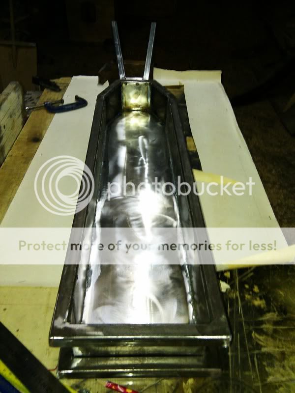

The box for battery and all the electric components:
It does look like coffin, steampunk baby :D

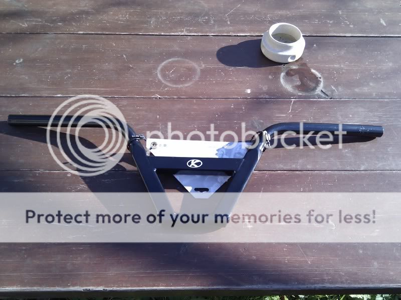

Welded frame and rear fork:
Steering:

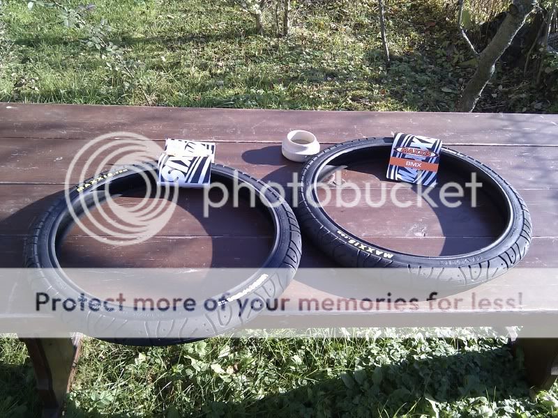

Rear tire:

Got some more work done this weekend, looks like its turning out to be long low rider. Here are some photos:
Next some cleaning to do on the frame. After will fit all components, weld some studs to mount controller, charger, DC-DC etc.

Postby sk8norcal » Mon Jan 16, 2012 3:51 pm
looks good, very nice...
hopefully that headtube weld will hold up...

Postby agniusm » Tue Jan 17, 2012 8:10 am
sk8norcal wrote:looks good, very nice...
Thanks. I will need to adjust head tube angle, but the weld is pretty beefy, should be ok.
