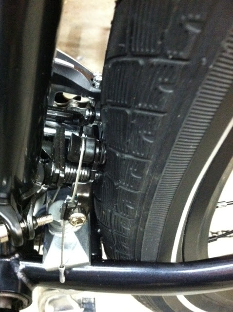

Last evening was spent massaging the rear disc caliper to create clearance for the hubmotor, as well as trying to extract to broken machine screw from the hubmotor coverplate. Never having had bike disc brakes before, I was able to figure out how to get some adjustment to move the cliper outboard. My rotor now fits and the motor housing doesn't rub on the caliper. I was however, less than succesful at removing the screw. I wasn't able to drill a pilot hole directly on-center, but tried left-hand threaded drill-bits as well as an extraction set to no avail. At this point I'm looking at tapping new threads for a slightly larger screw for that position and (most likely) ordering another coverplate from cell_man to replace the one I messed up.
:cry:
Oh well, at least the rear brake now works! Now on to creating a torque plate!

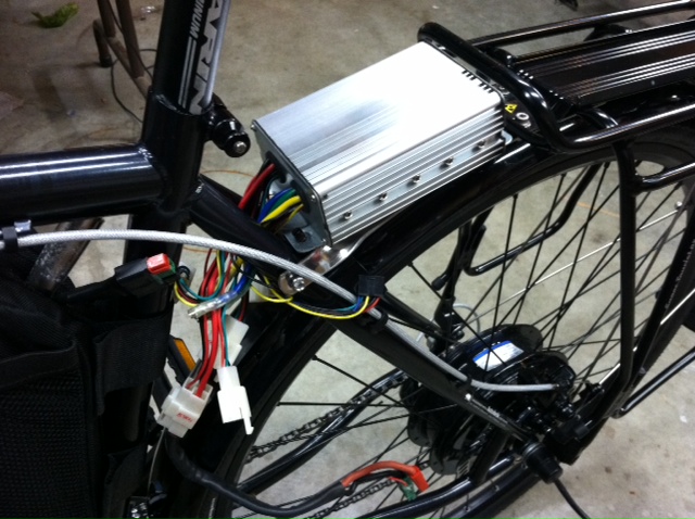

Postby TonyReynolds » Sat Jan 07, 2012 2:20 pm
I thought the controller might fit on the support arms for the rear rack. Test fit shows it to be a perfect fit:
The advantage of going with a larger-framed bike shines here. The DiamondBack has a compact-road geometry with a shorter wheelbase. There's much more room on the Muirwoods. The rear holes of the controller line up with the rack support rails; I'll have to use zip-ties or fab a bracket for the front holes. I'll most likely prime and paint the controller black before mounting it. I'm going for stealth, and a largish, bright aluminum box with wire doesn't help me there.
Now to get all the stuff off the bars of the old bike and onto the new...

I have a Brooks B17 Flyer that is sprung and actually works quite well for butt fatigue. Forearm fatigue relief was what I was hoping to get from the Big Apples.
The controller has been painted black and will bolt to the silver straps that secure the rear rack to the frame.
The wires from the controller go through the opening in the rear frame stay to the battery and points forward. Not much shows. As for waterproofing, the rear fender protects the electronics from spray.
The motor control harness that comes out of the axle was nicked and now the insulation is completely cut. I will have to mark the wire locations for the five-way plug that goes to the controller, remove the clip and slide a section of heat-shrink tubing down over the harness to the axle to protect the wires. The inside edges of that axle are SHARP. I'll see what I can do to de-burr them before applying the heat-shrink.
Oh yeah, battery is an 11.5Ah A123 52V (57V HOC) from cell_man in a frame bag. Motor, batteries and controller add about 18 lbs. to the bike. The Muirwoods is really light for a steel bike. All said and done, bike, electrics, fenders, lights and racks should be about 50 lbs. all told.
Third Build: 2012 Marin Muirwoods 4130 Cromoly, 7 speed 11/32 with 500/1000W MAC geared rear motor, 48V System, 52V, 11.5Ah 16s5p A123 lifepo4 triangle battery, DP CA; 20-30+ MPH... GRIN! Build Thread: http://www.endless-sphere.com/forums/viewtopic.php?f=3&t=33819
