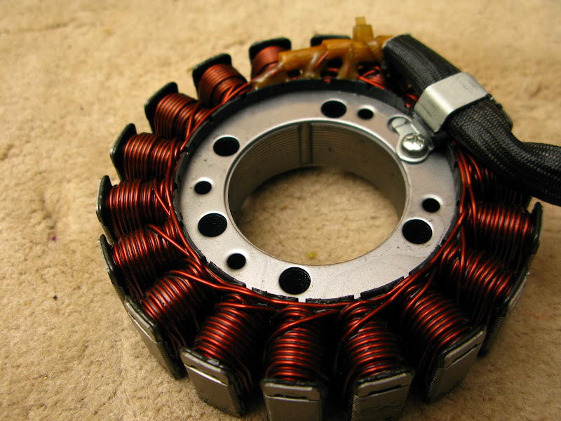

What do you think about making a motor by stacking some motorcycle stators together and making a rotor with neodymium magnets?
You can get the stators cheap on ebay or from junkyards.
Are there any stators with good enough steel laminations?

Yeah, it seems like most of them have thick laminations. My thinking/dreaming was that maybe there has been made one or two stator models made in the past (when engineers designed the parts, not the economists) that could turn into powerful cheap motors.

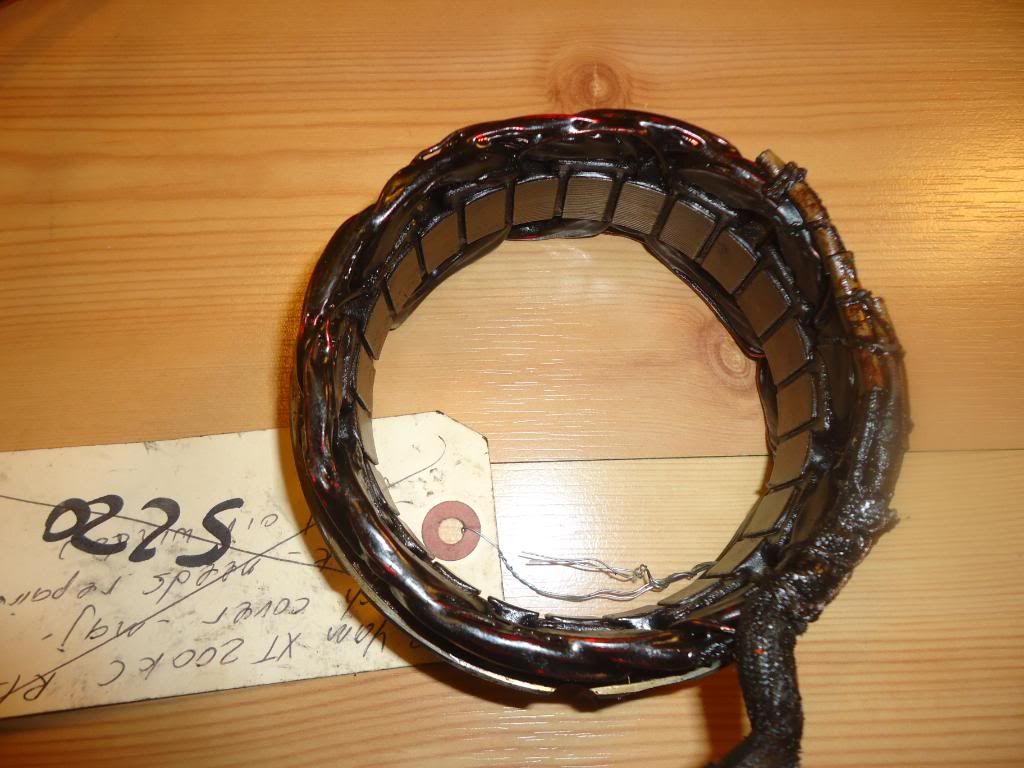

I just found a thread where Arlo1 has done just what this topic is about; using the stator from a motorcycle as a BLDC.

I don't see any reference to the SC model. However, looking at the close up photo of the name tag, you can see the windings through the ventilation slots. It appears that the windings are all slanted in one direction.
It's very possible this is what you are looking for. I have a photo of a Denso Stator shown below.
