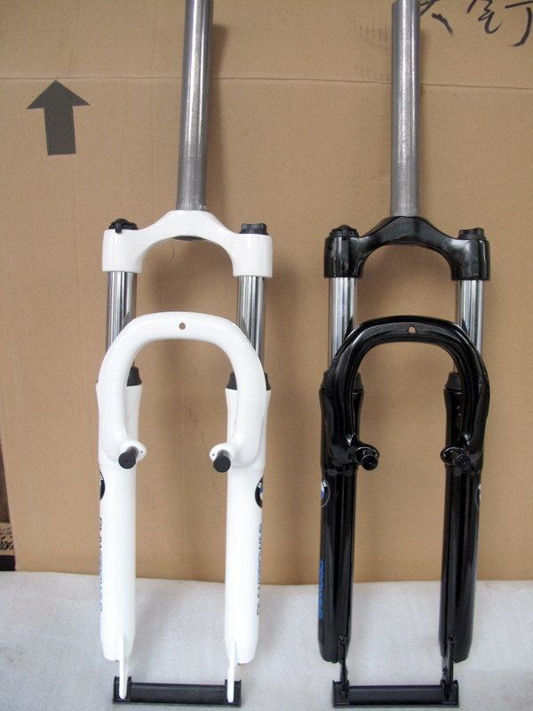

Postby iperov » Tue Mar 27, 2012 7:46 am
I bought from yoybuy.com (taobao) 1 1/8 100mm travel fork with steel dropouts, so I need no torque armor.
http://www.yoybuy.com/en/Show/14952860611
Sorry, bad english!
iperov

Postby gogo » Tue Mar 27, 2012 7:53 am
iperov wrote:I bought … fork with steel dropouts, so I need no torque armor.
I think you have coined a new phrase useful to this E-S forum. :mrgreen:

Postby dogman » Tue Mar 27, 2012 8:03 am
Still a good idea to add one torque arm-or, unless the motor is really low power.
A cheap fork like that, but with more travel than genesis stock, could be the best option.
I don't know that we ever heard what his needs really were.
I disagree that a better feeling fork is a waste. But I agree with Mad Rhino that too much travel for the frame would be dumb. On my cheap mongoose, I replaced cheap 80 mm with 120 mm that feels a ton better. Big improvement. Trying to ride the mongoose frame into the dust, but so far it seems fairly impossible to actually break it. Perhaps the same will be true of the genesis. Cheap junk, but tougher than you think?
