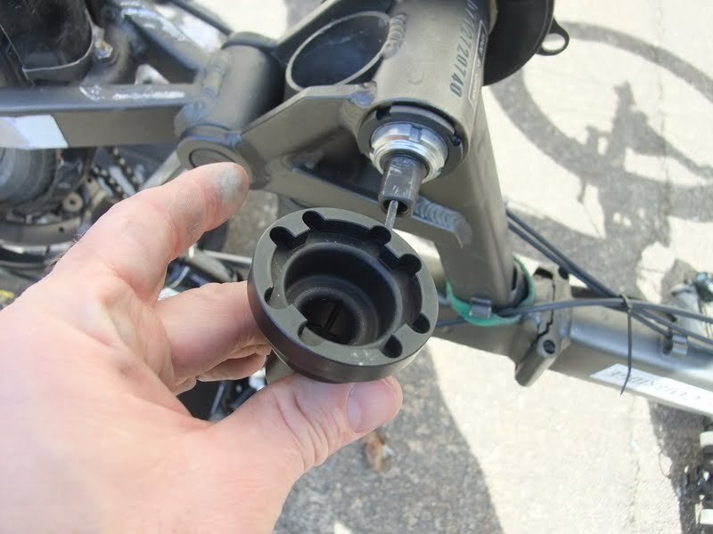

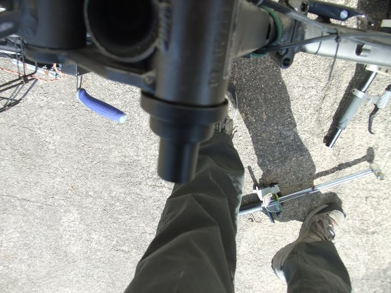

The rest of the install:
First remove the existing BB. This was easy because I just had the BB off a few weeks ago, to machine the BB shell. 6mm allen wrench takes off the crank bolt:
Easy as pi
This crank removal tool was one of my best impulse buys in recent memory
Make sure the inner piece is backed way out. Then thread it into the crank all the way until it bottoms, then back off a half turn.
Now use a 6mm allen key and tighten the inner piece. Some crank parts have left threads on one side and right threads on the other, such that you tighten them as pedal. Not so with these bolts, they're the standard right hand thread on both sides. With this tool the crank arm comes off really easily.
Now go find your BB removal tool. This was about $20 at the LBS.
I had to wiggle it a bit to get it to engage, tight and square. You don't want to torque on this thing with it half engaged, the aluminum on that BB collar feels like it would shear right off if all splines not tight
It's counter-intuitive to me, but to loosen, I had to lift the handle of the spanner from the position it's shown in. Same would be so for the drive side (the BB threads are left/right as mentioned above)
I took a lot of pictures
Here it is with non drive side collar removed
Next, do the same steps on the drive side:

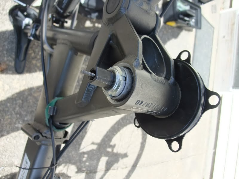

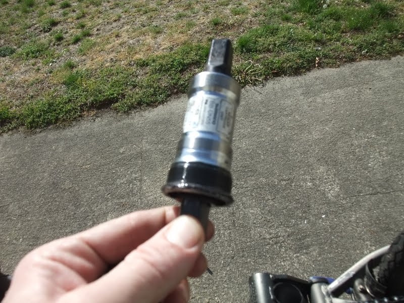

Postby MattyCiii » Sat Apr 28, 2012 11:32 am
Out comes the bottom bracket. I just had this thing replaced in the fall so it's in pretty good shape. Off to the spare parts bin...
Here's what delayed me: The stock cone washer on the left was too narrow for a snug installation. The 2mm cone spacer is on the right
The 2mm cone spacer was too tight of a fit, so I spent a few minutes sanding down its inside diameter so it would fit in place. Now the Speed Drive is placed into the BB

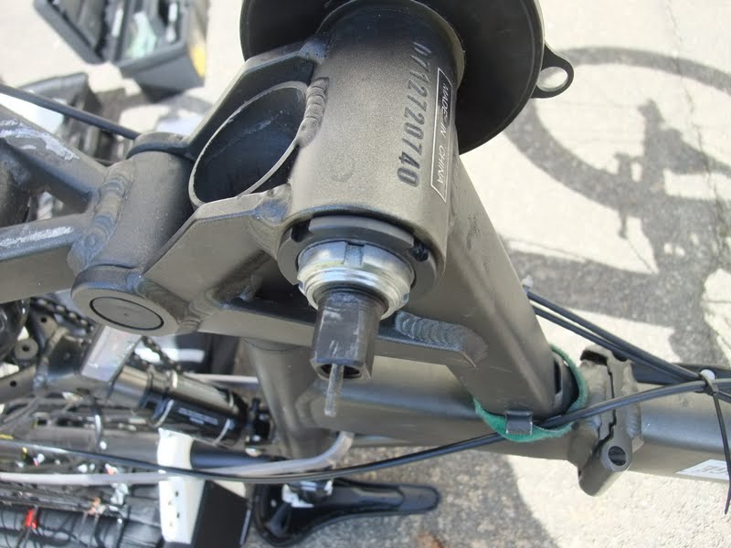

Postby MattyCiii » Sat Apr 28, 2012 11:48 am
Preparing to install the BB nut on the non-drive side. See the narrow threaded rod sticking out if the spindle? The Schlumpf tool set includes an aluminum spacer you place over that thing when using a crank removal tool. Betcha ten bucks I forget to use the spacer and ruin the drive when the time comes to remove the cranks...
That spacer I was talking about. Store it somewhere safe.
I put a dab of automotive anti-seize lock on just about everything that has threads. Months/years down the road I won't have to learn new swear words while disassembling this thing.
The BB nut hand threaded on a couple of turns. A little grease, in red, to help with installing.
BB nut, Hand tight
That Schlumpg spanner I keep talking about
Spanner in place, ready to tighten. The worlds oldest torque wrench on the ground between my feet. I had to go back to the ebikessf.com install video to get the torque specification (140 newton meter) then convert it (103 foot pounds)
There it is, torqued to spec. Look how the splines that mate with the install/removal spanner machined off just a little more aluminum from the BB cup.
Clean all threads before applying anti-seize and installing
No show stoppers so far... I'm waiting for the other shoe to drop as I tighten the 14mm crank bolts. I had to tighten them way down, if the cranks are not seated fully, they sit too far out and you can't push the "shift" buttons down fully.

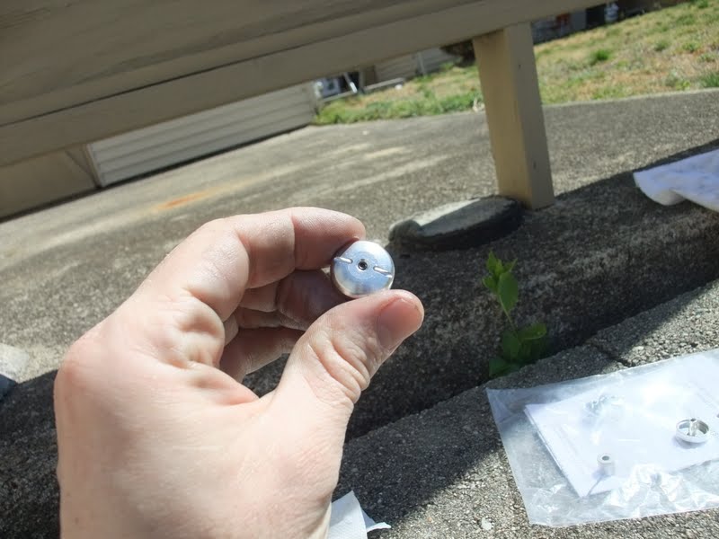

Postby MattyCiii » Sat Apr 28, 2012 11:53 am
There it is, with the shift button in place. This was before I got the cranks fully seated, so the button is an "innie"
Edit: Do NOT thread loc the buttons! They'll be impossible to remove! (original text: "I hear these buttons tend to fall off, but usually only when you've got your bike sitting over a storm drain. So, use thread loc")
One more shot of the button with its set screw installed Edit: Do NOT thread loc the buttons! They'll be impossible to remove! original text: "also thread loc'd"

Do not use thread loc when installing the buttons. If you do it'll be near impossible to take the shift buttons off, and this it'll be impossible to remove the cranks (say you want to install shorter, or longer cranks). I edited the steps above recommending thread loc to indicate this update.

Postby BATFINK » Tue Jun 19, 2012 6:25 pm
Hello there Matty, i received my Schlumpf from accountant, unfortunately two of the lips are bent, the lips with the hole to mount the chain ring, did you have a problem with this as i read it somewhere on ES that someone had the same problem, now I'm scared to try and bend anything incase i ruin my drive, very disappointed just now. can you look at my thread please:
viewtopic.php?f=3&t=40296&p=598675#p598675

Postby MattyCiii » Tue Jun 19, 2012 6:44 pm
Sorry away from real Internet just now. But I think it was Alan B's Croborg build where the chainring flange was bent. I'll look when I get home to see, there was definitely a thread about that

Postby Alan B » Tue Jun 19, 2012 9:45 pm
Yes, it was mine that was bent. Was not hard to bend, is working pretty well now. More details in my Croborg and other threads...
