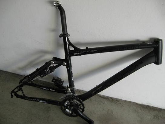

I've got a quote for having the swingarm welded up. I was told $65-$85. Does that sound reasonable to you guys?
Here are some pics of it before it goes off for welding.
Here you can see I shaved these solid bars of 6061-T6 down to fit inside of the main rails for some reenforcement. I will have the swingarm welded up without these installed so that they do not change temper at all during the welding process. I will insert them afterwords and they will be held in place by friction and the rear axle bolt.
Here you can see it all marked up for the welder to do his job. I just guessed at how to do this, he just told me "forget drawings..just mark it up" (?!) You can also see the huge chunk of alu I will use for the motor mounting plate. I'm thinking it is wide enough that it will stand up on it's own with 2 or 3 huge bolts drilled and tapped into its' bottom edge, and I can cut a bunch of groves into it to make it an effective heatsink and lighten it up.
I payed the same for welding an exhaust aluminium pipe with only three welds here in Germany.
Sounds reasonable for me. Remember, the welder has to clean everything etc. That takes its time
Your swing arm really looks stiff. I hope it wont weight a ton. Looks a little to wide.

Postby GITech » Wed Apr 11, 2012 1:59 pm
I payed the same for welding an exhaust aluminum pipe with only three welds here in Germany.
BTW what are the braking levers made for? you should really use hydraulics! I didn't mean you should use this crab when I said you shouldn't bother with brakes...
Your child looks like she wants to become a true mountain beater :D
Yea, I thought it was a good price for the welding. :)
I just weighed it all up and the swingarm with the extra support bars weighs 4lbs-14oz total. The motor mount plate weighs 3lbs-8oz, but that should be cut down to less than half that once it is all cut up to the correct size and finned for heat dissipation. So ~6.5-7lbs when it's all done? Plus the wheel, jackshaft w/gears and torque limiter, and motor...maybe 15lbs on the rear when done? What are your thoughts on this?
I had to add 12mm to the left side of the swingarm to make room for the disk brake/caliper, and the #35 chain and its' sprocket, upon the advice of Thud. So that makes a total of 147mm at the axle inside the swingarm. Each side of the swingarm is 19mm thick so..147+19+19= 185mm wide total. I will use this 220mm bolt as an axle: http://www.fastenal.com/web/products/de ... u=11114435 What do you think?
I am kind of stuck with the mech brakes...I figured, at the time, that I had to go with mech brakes in order to use the switching brake levers from Lyen. Since then I have come across a thread on here that showed someone using magnetic reed switches with hydro brakes to accomplish the same thing. Doh!
How bad is it that I'll use mech disk brakes? I 'am' using 203mm brake rotors with 20" tires. It looks like I've got a lot of braking advantage...over say a 165mm rotor on a 26" rim, ya know?! I'd like your opinion. ;)
Yes, Lily's favorite thing seems to be climbing now! She wasn't happy in her play area until I put that powerwheels in there, which she loves to climb all over like it's a jungle gym. It keeps her busy and I happy about that! :D I will have her on a bike as soon as possible!!! :mrgreen:
