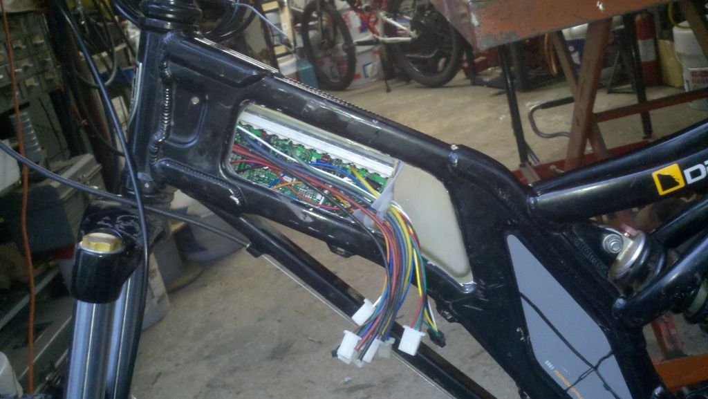

So I'm trying to get the controller inside the frame, which looks like this:
The controller fits perfectly into one area:
The problem is that the frame is aluminum. Is the only way I'll be able to do anything to the frame is by tig welding? I'd like to be able to have one side able to be accessed because I want to throw 16s1p lipo into it as well, and will need to access the balance plugs every once in awhile. Advice please?

Those older Norco frames were overbuilt, yet I wouldn't cut so much off it as to fit this controller and batteries.
If you build on it welding alu, it will need to be heat treated after, for the welding will affect the hardness of the alloy.

Does the structural integrity of the frame come from a skeleton or is the frame made to distribute the stress to all parts of the aluminum? I'd like to cut a rectangle the size of the controller, and "slide" it into place, while having all the wiring inside the frame which sounds hollow. I will keep the controller in place with silicone, and if possible, I'd like to slide the batteries into place in the frame as well which will be padded up with foam. Basically I'd like to "unhollow" this thing out, so that it will still look as stock as possible.
John, this is a 15fet with 4410's. I got it custom made for my specs, and it provides all the current I want without even getting warm.

In that case I'd look at dumping the controller case and making that part of the frame the case for the controller with a good thermal pathway from the heat sink bar to the frame itself. If the grey panels enclose a hollow space with the top and bottom sections being channels as opposed to close tubing, then there's plenty of space.
Going that route pick up a spare identical controller now to keep it simple in case of a failure down the road.

Postby John in CR » Mon May 14, 2012 11:32 pm
Drill a fairly small hole and go exploring with a coat hanger.

Postby iovaykind » Tue May 15, 2012 9:33 am
Looks like the entire thing is hollow. Drilled a hole and was able to reach very far in, a flick to any part of the frame gave a loud resonance throughout the entire frame. Looks like the black part is the structural part, while the gray parts are rather thin. Will try and fit 16s 5ah in the frame with the ability to add more packs via a ton tube bag if need be.

Postby iovaykind » Tue May 15, 2012 10:40 am
Cool build Andy. The main reason I'm trying to keep this as stealth as possible is that I don't want to always take the batteries off the bike for charging, or when I get to school. It can be quite a hassle, I just don't want to worry about getting stuff stolen.
Taking the casing off the controller made the controller considerably smaller. It will definitely fit inside the frame, and can probably be mounted with some silicone to the frame.
I know the bottom of the frame is flat, and can probably take 16s 5ah there, while I want to fit another 5ah inside the frame. Hopefully if all goes well, I can fit 16s10ah in a nice and stealth build.

Postby iovaykind » Tue May 15, 2012 2:04 pm
I measured and it seems that for the last 4s pack I'll have to split it into two in order to fit into the frame. 12s fits perfectly fine, its just the last bit that will take some ingenuity. Also going to try and build an adapter for the balance plugs so that a printer cable plug can be mounted on the side of the frame for easy balancing.
The empty spaces I'll fill with space filling foam after all is settled so that there won't be issues with things moving around inside the frame. It should also help with providing some extra padding.
The controller is now without a case. I'll have to seal it somehow to keep it from shorting with the aluminum frame correct?

Postby iovaykind » Tue May 15, 2012 10:30 pm
So I just spent the past five hours working on the bike.. time really flies when you're doing menial tasks like soldering. Here's how the controller fits inside the frame:
I had to reconstruct the batteries to 3s blocks instead of 4s because 4s wouldn't fit inside the frame. This is a very annoying task. And I also have to build a printer cable port so that I can balance charge my packs if needed, that's a lot of work still needing to be done. Can anyone suggest a printer cable thing that has at least 17 pins? Not too many either, I'd like it to fit in the little space left in the frame.
All I did after taking a break from battery work was wire up the throttle, CA, and misc switches like cruise and three speed.
Here's the issue I'm having though.. wiring it all up, I get one of two problems. One is that the throttle doesn't work, the other is that right when I turn it on I already get full throttle. I can't seem to work out the combination for the throttle and since I have the same throttle and controller as my last build, I wish I could look but that one is sealed up also. Will have to work on it again tomorrow.
Edit: throttle issue worked out.. bike is up and ready to go, just have to finish the battery setup. I got my hands on a SATA plug so will have to wait for that to come in to build a balance port.

Postby iovaykind » Fri May 18, 2012 9:08 pm
My big mess of wires that makes my lipo look like a bomb.
Scratch that.. it IS a bomb.
Trying hard to get it to fit in:
Had problems so had to cut out the extra panel to fit everything.
Big mess, needed to relocate capacitors, and sliding in batteries was a huge feat.
But FINALLY it all fit:
Thanks to those who believed it could happen, and hi haters to those who didn't. Just kidding, :roll:
There's really like no space left.. I'm going have trouble fitting any sort of switch to turn it on. Will have to devise something, but will remain as stealth as possible! Going to get covers fitted so the bike looks normal again. Cheers!

Postby whereswally606 » Sat May 19, 2012 6:41 am
iovay, thats impressive, i'm surprised and worried about how much weaker taking that second panel out has made the frame? my norco's do, have as much internal space as this so id have to resort to long packs , not sure im going to bother till i get one of a very similar style or make my own.

Postby iovaykind » Sat May 19, 2012 8:15 am
The frame is still pretty darn strong.. I wouldn't by any means jump this off anything significant, but off the curb no problem and can probably handle some small jumps. What's good about this aluminum is that even if a jump were to exceed its tensile strength, the frame would bend, but it would never snap. After removing the panels, I went ahead to test the material, and 6061 alloy is really good stuff.
I hope to close this bad boy up soon after I get the balance plug, install some charging wires, and a switch. Finding a spot for this stuff will be an issue now :wink:
