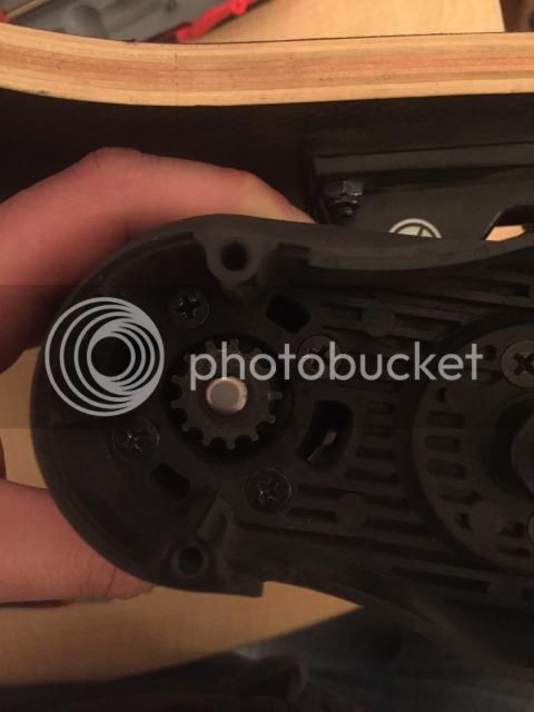

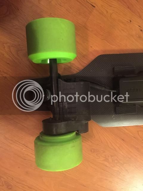

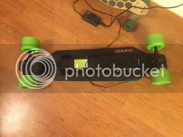

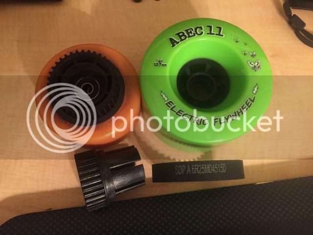

Hi All, here is my modded yuneec e-go that will cruise at 14.4 mph.

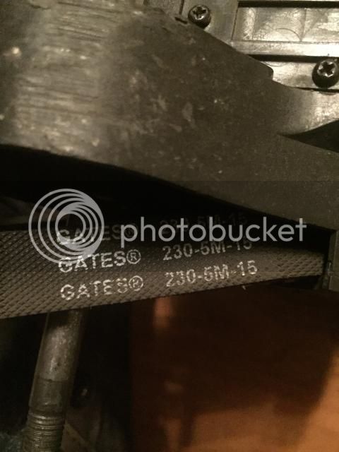

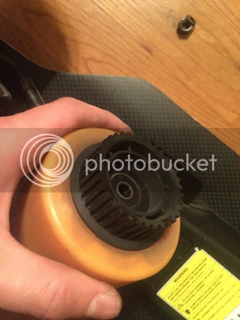

I got 107mm abec 11 electric flywheels and the evolve boards drive wheel (33 tooth). I also got a 45 tooth belt from SDP. It fits a little bit loose, so it skips when you brake, but I haven't ever had it skip when accelerating or cruising.
I had to shave a bunch of material off the drive wheel to make it fit, but you cannot tell the wheel is different when you ride it. One nice thing about this mod is that it doesn't damage the yuneec setup at all, so you can change back to the stock setup if you feel like it.

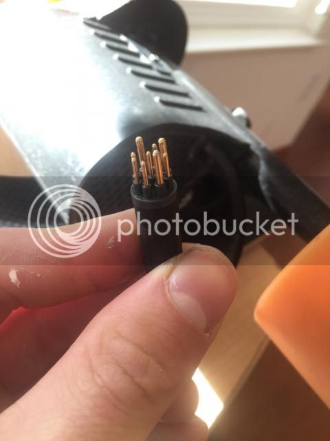

I've also thrown in a couple random pictures of the e-go parts, because I figured others might be curious. It is by no means a perfect mod, but I'm pretty happy with how it has sped up the board a bit.

I will also confirm that the electric flywheels are awesome. They will roll over anything. For comparison in size look at my pics above... Those are gumballs on the loaded board, and they look tiny!

I think all in all the cost was closer to $200, but I also picked up the e-go off craigslist. I don't know if I would recommend anyone pick up a $700 e-go with the intention of dumping another $200 into it with this mod, but it was fun to experiment with.
I only have 2 small hills on my commute, one of which is a freeway overpass walkway, and it climbed the hill pretty much the same as before. Going downhill I could not brake with full power or else the belt skips.
I cut the wheels with a hack saw and a kitchen knife. As soon as I got it small enough to mount to the board, I used the motor to spin the wheel and a metal file to clean it up a bit. It wasn't pretty, but it worked. It would have been much easier if I had any power tools.
