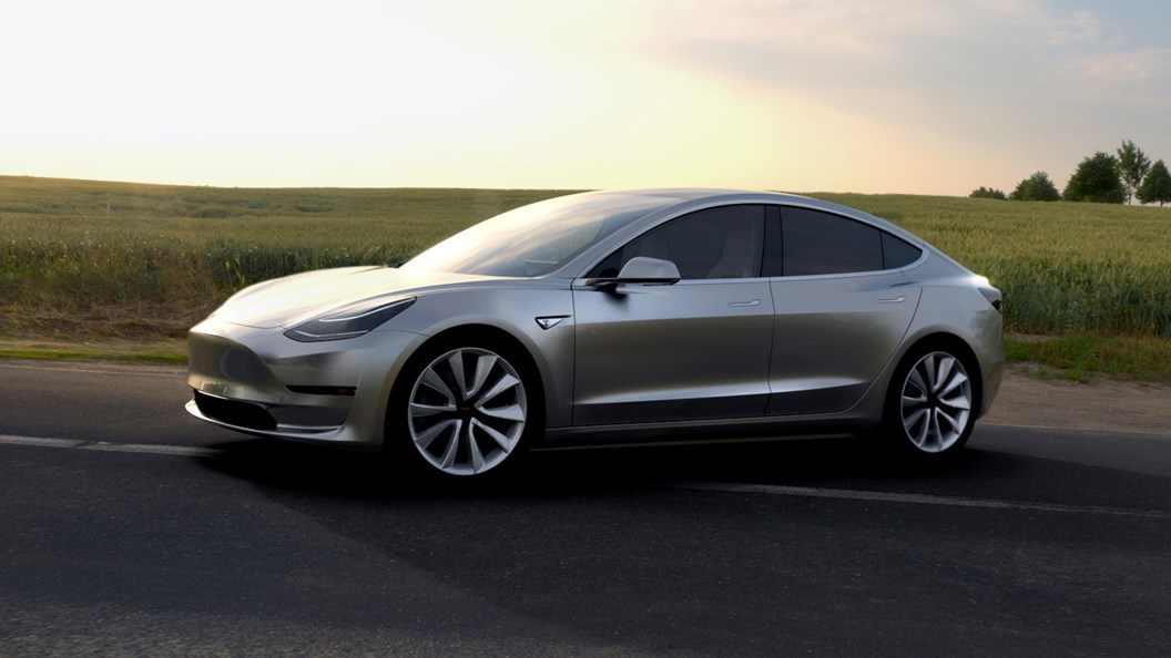

In terms of wheel aerodynamics.. if i use a rear cover like the 140mpg Daihatsu UFE, then i can hide the ugliness that a different set of wheel sizes and shapes creates.
The UFE also has an acrylic aerodynamic wheel cover which is pretty aesthetically appealing compared to moon discs.
I'd like to imitate that somewhat, even if it's just a matter of filling in gaps in my current rims.
A Tesla owner has done the same thing with good results.. though i'd say the aesthetics could be improved greatly!

Looking at the designs of very aerodynamic cars produced recently, especially the Tesla Model 3 and newer Mercedes cars, i see that the body of this car is very well streamlined; but the front bumper/grill is an atrocity compared to the Model 3:
I think there would be massive aerodynamic gains in extending this bumper out by 1 foot and adding a bit of the Model 3's 'duck bill' while i'm at it. This could be designed as an extension of the center grill section, and not look terribly outlandish.
Even in The Tesla Model 3, the front bumper is a huge source of resistance and could be improved notably.
Even though the other grill blocks are easy to design and install, I am going to wait on adding them and focus on lightweighting the car, to reduce the momentum when rolling so that the air resistance and tire friction becomes a larger proportion of what causes the car to slow down. I think lighter wheels is probably the big ticket item here. Finding some is going to be extremely challenging.
