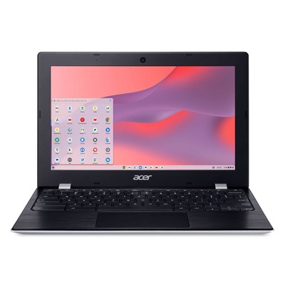

so 1st problem was os flex needs a min. of 4gb ram, and it only has 2gb ram. site refused to download os flex. :roll:
next i learned 1 screw takes the back off :thumb:
next i took the ram out of another c710 that suffered the grey screen of death,
and added 2gb ram to the empty slot .
site did NOT give the no go warning 8) BUT i'm not switching today.
did a quick test running YT on THREE windows at once, and all 3 music vid's played fine (that would lock it up before)
enough for today :twisted:

2015 c720 crashed bad. no screen. dead :shock:
in the course of my study, i learned to press and hold the ESC + refresh, and then press and release PWR.
WORKED :thumb: BUT screen said "chrome os either missing or not installed" :roll:
then a minute or 2 later it booted and i'm on it now :bigthumb:
c720 crashed again, even worse. did not re-boot. then i remembered i was pressing keys at random, so i tried that again :bigthumb: 8)
Now i just changed the USB2/LAN adapter to a new usb3/lan and it works lots faster :shock: Maybe that old gizmo was failing and caused the crashes?
i better try to get a recovery program on my flash drive.
sometimes it says "no internet".
finally found an easy cure. i clear the cookies and it instantly has internet. no rebooting or anything.
