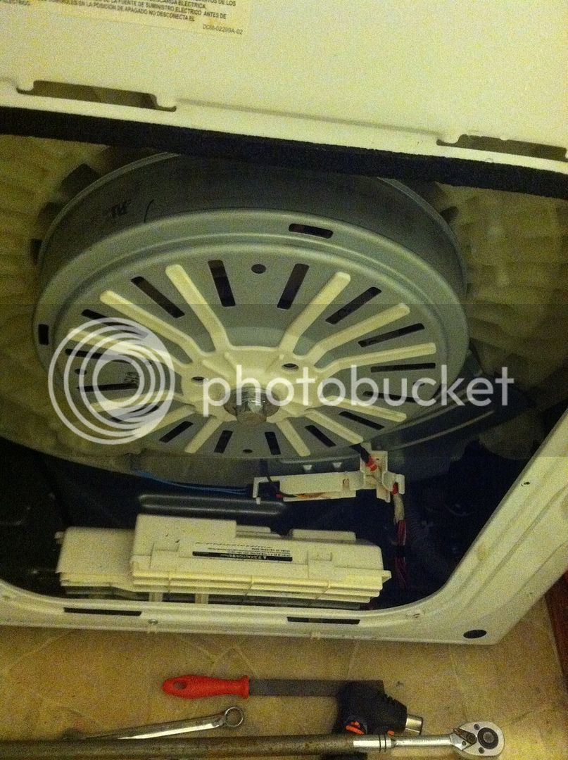

I have been pulling this machine apart to try to fix it. I think I found the culprit. The back bolt which holds the rotor(magnets for stator), which I remember the repair guy tried to remove then stopped because he could not get the bolt loose :x he knew the real problem but didn't want to spend the time to fix it!, is basically stuck. No amount of force will get it to come loose even with a hammer. In repair video's on this same washer they just give the wrench a smack with a hammer and it comes right off. I assume the drum is wobbling because the metal rod that connects to the motor from the drum is warped or twisted... Obviously shitty quality steel not up to spec with spinning a drum filled with heavy water soaked cloths. So I am looking at a new spider assembly and possibly drum. I read on this thread a few of you have appliance repair skills. Any advice on how to get the bolt off?
Penetrating oil, breaker bar, breaker bar with a pipe on it, pneumatic impact wrench, Be sure you have the right size socket. Helps to make grunting noises when using wrenches. Gloves will protect hands when something slips. Are you in the US? Standard of metric sockets? Reverse threads? Try going the other way?
My washer was shaking all over. Spring that holds drum to base was broke. $7 for a new spring and all is good with my washing machine. Give the machine a good visual inspection. Anything missing or broke? Get some good lighting. [flashlight]
Invite a friend over for beer. Have him or her hold the rotor. Pneumatic impact wrench might be best tool. Do you take the wheels off your car? Pneumatic impact wrench is great for that. Snap-on makes a nice battery powered impact wrench.
Looks like it's time to break out the torch lol. Or the sledgehammer. NO- just kidding! I don't think heating or beating will help.
Anyay, just a few days ago I couldn't figure out how to loosen my neighbor's crankshaft bolt to replace the seal. I'd never done it on an auto transmission, and it would just spin. Youtube showed two methods, and I tried the 'safer' one. Sure enough, impact took that thing right loose. I was really surprised, cuz I've broke 1/2" sockets trying to loosen the crank bolts on my own vehicles.
So +1 penetrating (or cocacola?) and impactwrench to remove that bolt.

I will have to find an impact wrench and have someone hold the drum. Hopefully it will come off. The part below is what would make it out of balance unless the drum is causing the issue. If that shaft is bent that bolt would be wedged in it, not sure anything will get it out if that is the case without snapping the bolt inside it. The thing is that bolt is not suppose to be tight and never could be tight due to there being no way to hold the motor and torque it down, and there would be no need to torque it since it just holds the motor rotor in place. Due to the motor/drum assembly being the main part of this unit it will be hard to find a complete drum/motor replacement so if I can't get the bolt off it is basically totaled! Might pull all the parts out sell them on ebay and hopefully pay off most of another washer, a f$%*ing top loader this time!

Shorting the phase wires would help hold the rotor while working on the tight bolt. If the wires are hidden then maybe a belt around the o/d of the rotor? Good luck.
