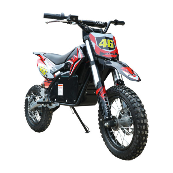

Hi guys,
I'm at a junction in the 'pimp my Chinese eBike' project where I need to upgrade my battery having purchased a 2kw 48v 4300RPM motor to replace my 1200w 48v motor, and I naively replaced the 30A controller with a 48v/60v 33A-35A, not checking that to get proper @ 2kw you need 45A @ 48V which the motor is rated for.
Therefore I'm thinking, OK I should have got a 45A controller for my motor, If I wanted to run full 2kw on this motor @ 48V!
Either way the current battery is 48v 30A 20AH, and is being killed quick and needs replacing ASAP.
So do I correct my error and buy a 45A controller and a 48v 40AH battery or do I over volt to 60V with 25AH battery, thus still pushing 2kw 60V x 35A = 2100w and from a calculator I found takes the standard 48v RPM from 4300 - 5325 and although my motor is VEVOR , the controller is KUNRAY and the KUNRAY MY1020 60v 4300RPM motors are rated max 5300RPM.
So I'm thinking hmm, looks like these 48v motors (the photos of the VEVOR & KUNRAY look identical) will run happily on any volts as long as amps doesn't exceed 45 and watts @ 2kw before over heating.
So as my controller has a mode wire that switches it from 48v to 60v, do I.
1. Overvolt motor to 60v @ 33A-35A and buy a 60v 25AH battery.
or
2. Swap controller to a 48v 45A+ and buy a 48v 40AH battery.
The controller is also rated 2kw , so either way it's roughly 2kw!
Note: battery AH, are picked based on potential manufacturer and their dimensions of what would fit in the bike!
My goal is greater torque / acceleration not top speed, but also additional range at a controlled pace.
I appreciate all input.
Thanks,
Craig.
Nope this is an electric Dirt Bike, I've hacked with a 2kw BLDC motor.
I could change the sprockets but I still need a battery as it can't handle the discharge amps.
I don't want to buy another controller for higher volts & amps, as I can't fit the battery in the bike.
I was going to get a 60v 30AH but dimensions just don't work.
It's really a kids toy, and I'm just having fun pimping it as I use it to take my son to school, and we are maxing out weight limits :lol:
I know just getting the 48v 40AH 50BMS will improve performance without even replacing the controller, but 35a x 48v = 1,680w and if you only get 33a on 48v then = 1,584w so I could go full throttle for an hour and technically the battery would still have loads in it, so my range / time between charges would dramatically increase, but I would still be technically under powering the motor as it's rated 42A continuos.
Or I overvolt, giving me 5300RPM & 2kw power, but 35a full throttle would kill my 60v 25AH battery in less than an hour.
OK, I'm not going to be full throttle all the time, and nipping around town isn't going to kill the battery to quick.

Well, I got a 60v (71.2v) 25AH 50A-Continuos /100A-Max BMS battery and still the Vevor motor was running poorly.
I'm not sure if the hall/phase changes the Chinese gave me to reverse motor was correct or if the fact the motor is 48v 42A and my controller though 60v is only 33A, even though the battery is 50A BMS
I do have another controller that is up to 72v and 38A-45A, but it's pretty big and not sure it will fit under the fake petrol tank, and having stripped the bike, moved everything and totally rewired including a new 12v circuit for lights, horn, indicators etc, I thought I'd try the old 1200w 30A 48v motor.
Then found with this replaced controller, the wheel went backwards, with no learn wire I decided to follow the Indian reverse motor wiring I had seen (Blue / Yellow - Phase, Green / Yellow - Hall), instead of the Chinese.
WOW! , the acceleration just on low speed is awesome, and the torque is phenomenal, overloaded with my son sitting on the tank, I could drive on slowest setting, @ 1 mph up a steep incline and it didn't even struggle only needing a minute twist to get over the brow at the peak.
Normally I'd have to take a run up at the hill if it was to make it to the top.
Not even put it on high setting yet, and will need to do a GPS speed test, but yeah, this eBike over-volting is awesome :)
