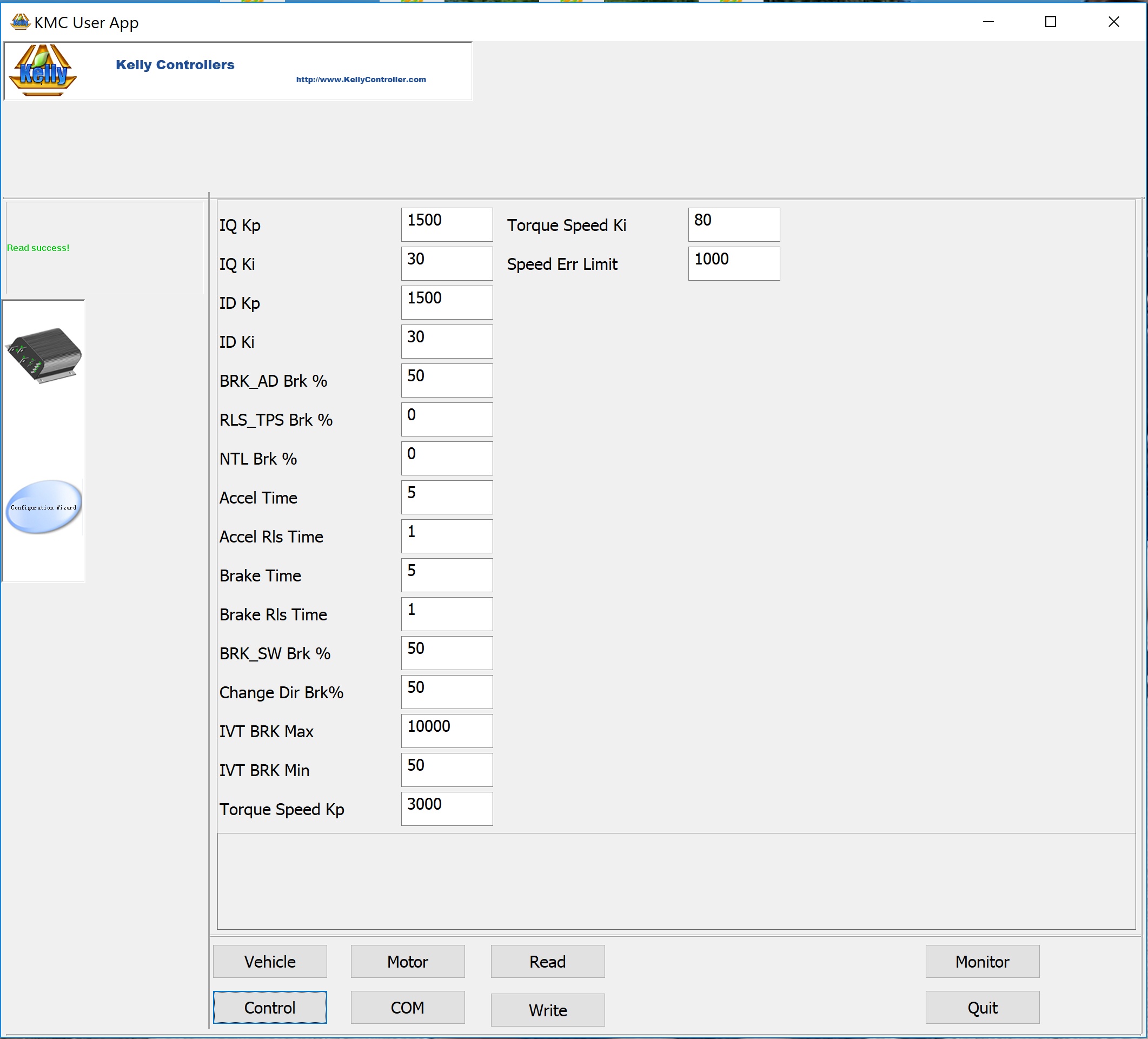

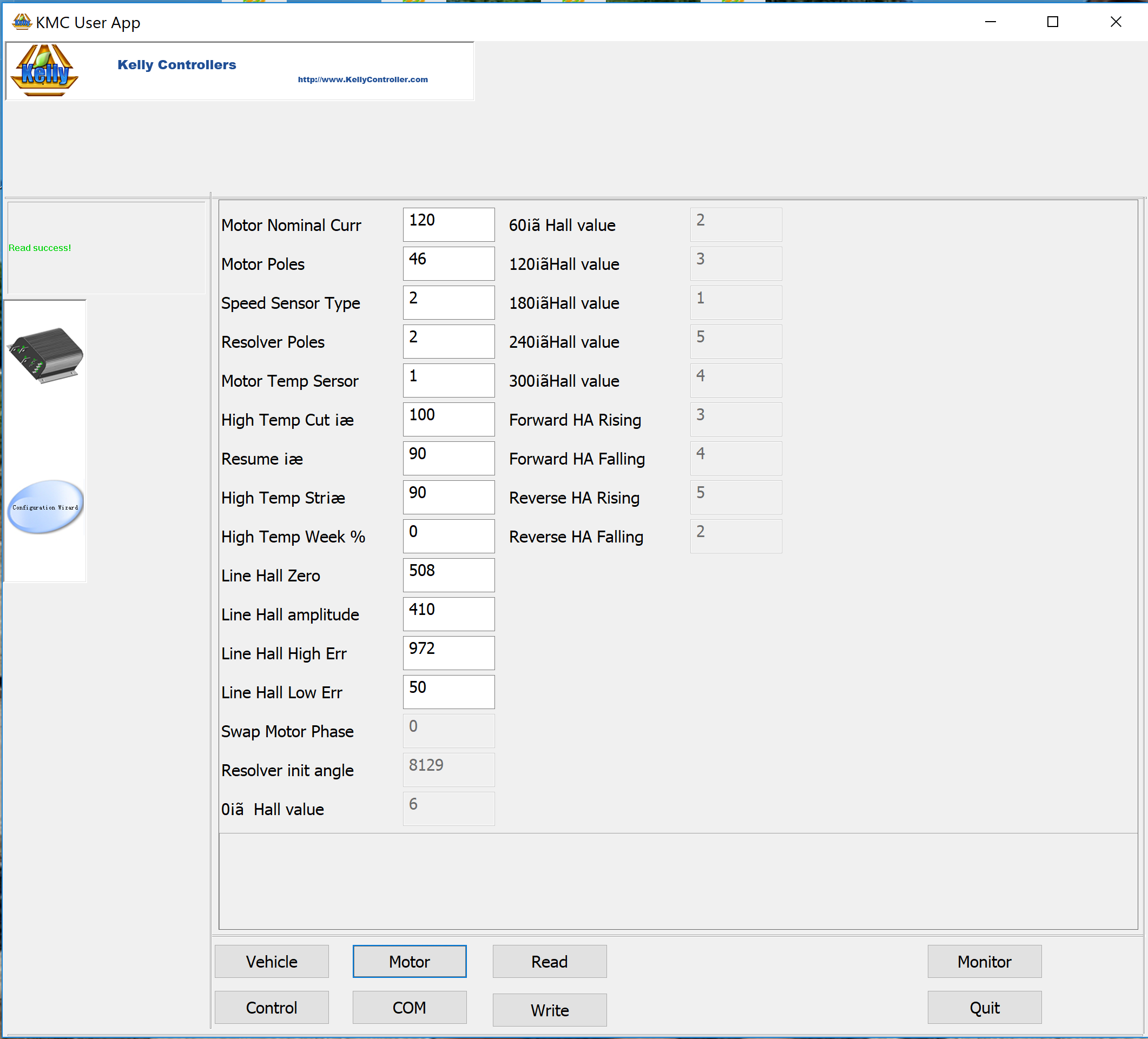

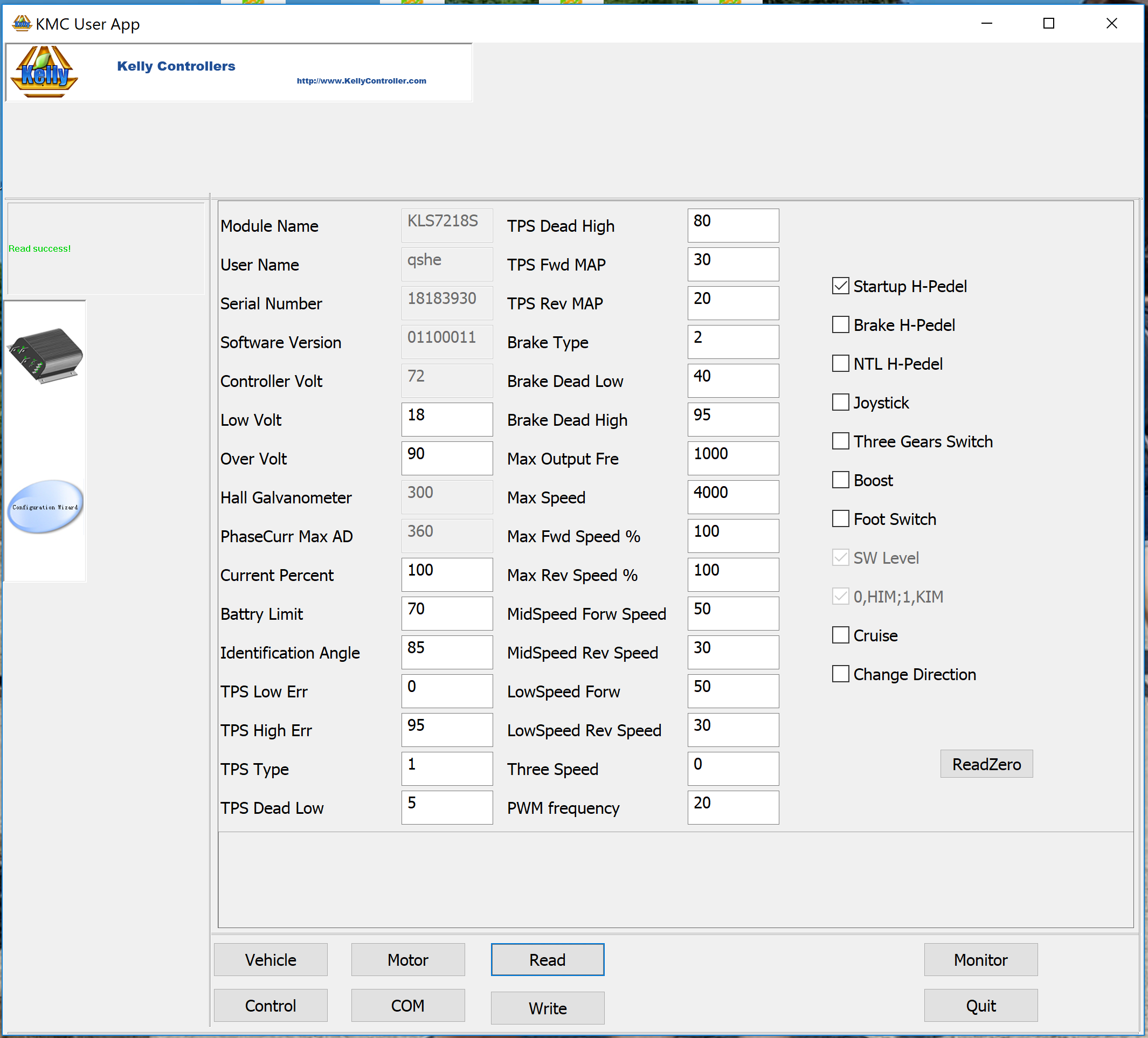

I need some more power on my Kelly KLS-S Controller. How do I set it up? Anyone familiar with it?

(7)TPS High Err: Hall active pedal, if higher than the value, report the fault of TPS Type. Range:
80~100
As you may know, the output of hall throttle from Kelly is about from 0.86V to 4.2V.
Our controller will report 3.3 error code if the output of hall throttle is below 0.5V or above 4.5V
by default.
The controller will think the hall throttle is shorted or damaged if the output is beyond the range
from 0.5V to 4.5V.
You can adjust the threshold voltage below or above 0.5V. The controller will report the 3.3 code
to protect the system according to different types of hall throttle.
Because there are many different hall throttle suppliers in the world. The initial output cannot be
always in the range of 0.5V to 4.5V.
But it doesn't make any differences if you choose 0-5V or 3-wire pot for the throttle type. That is
to say, these two settings are only useful for hall active throttle or pedal when you chose throttle
type at 2.
As the same goes, it is valid to adjust the high threshold voltage above 4.5V or below 4.5V.
Usually, the Hall output voltage is 4.2V Max. If you adjust it to a lower value which is near 4.2V, it
may trigger the error code in a normal way.
(8)TPS Type: TPS Type, 1:0-5V 3-wire 0-5K pot,5K is normal,2K-20K can be used;2: Hall active
throttle or pedal. Range: 1~2
eee291 said:If you need more regen then you need the more powerful Controller.
eee291 said:I can see something wrong with your settings, Throttle type should be set to 2 if you have a standard Hall throttle.
TPS dead low is a bit low, Try changing that to 20%.
I just want to rule out the settings at least.
eee291 said:I still think you should check the Connector and see if it's mated properly.
The same thing happened to me, the Motor would spin up without a load but on the road, it would cut out.
I also solder the pins after I crimp them to make sure I get good contact.
It says error code 3,2eee291 said:Do you have the Bluetooth module? You could monitor the Controller with your phone and see what error code pops up or look for any changes in the throttle position value under load.

More likely it's because when the first "ebike" controllers started using a 3-speed switch, they used an on-off-on, (center-off). That means that speed setting 2 (the middle one) would be the default if no switch were connected.2WheelsMovesTheSoul said:For some reason the system uses the default "MidSpeed" 50 setting if you don't have a 3 speed switch. Probably has something to with ensuring a vehicle can still move even with a busted speed selector switch.
DasDouble said:Next question: The Kelly cuts off power when accelerating full throttle after 2-3 seconds from standing still. What to do with that?
