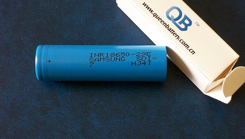

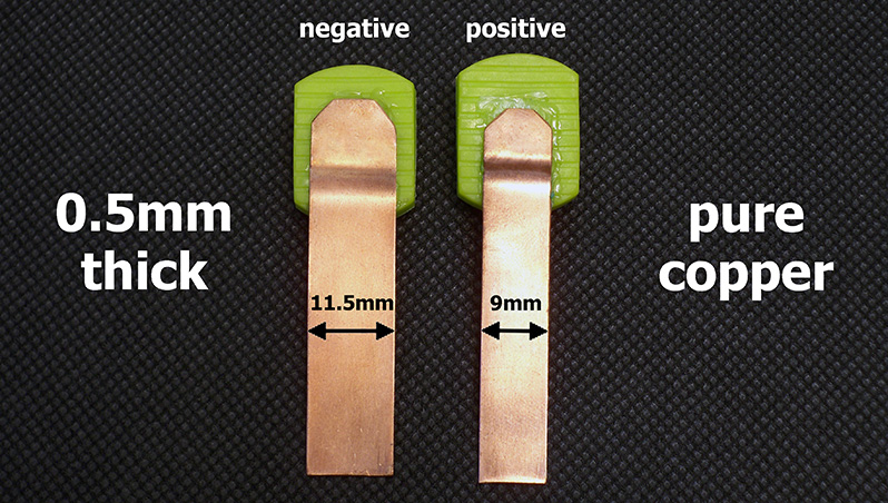

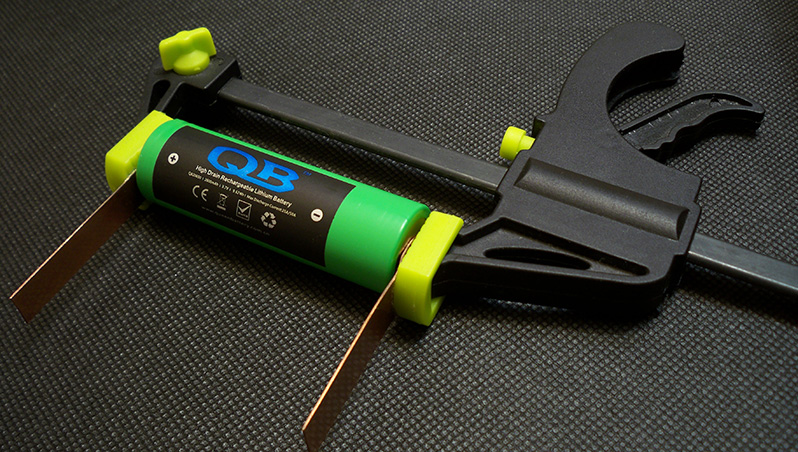

The battery was bought from my reliable supplier (Queen Battery) and tested with ZKETECH EBC-A20 and a self-made battery holder. It's a PC-connected battery tester supporting 4-wire measuring and discharging at up to 20A.
I've used version 3.0 of my battery holder based on 0.5mm thick pure copper terminals

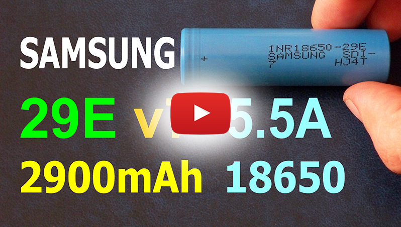

Samsung INR18650-29E v.7

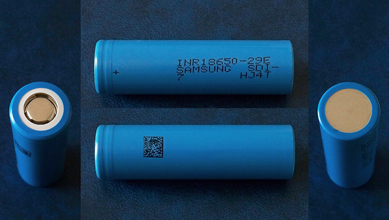

The cell is marked as INR18650-29E SAMSUNG SDI 7 HJ4T - number 7 stands for the version. This cell has also a 2D barcode on its back which has this code BRHA9E7Q50508297H7TT143509210000000000000 encoded.

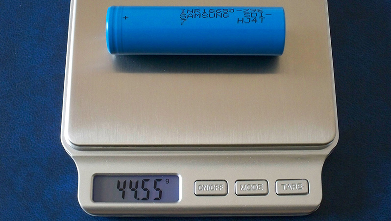

Measured weight: 44.55g.

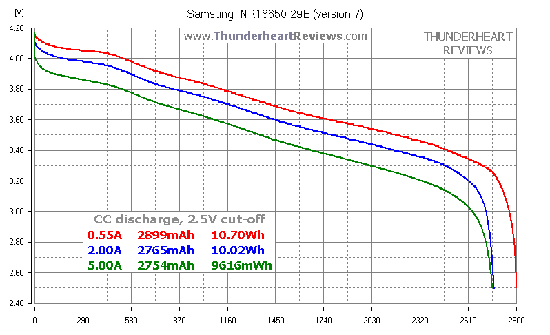

First i need to mention the beauty of curves and that they are as linear as possible! Even the 5A curve! The results are much like those of v.6 but a bit better, so let's compare them step by step.

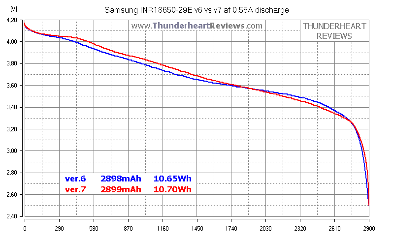

At 0.2C/0.55A discharge:
Only 1mAh difference in capacity and 0.05Wh in energy!!! But the curves are what's important - 29E7 curve looks more linear than that of 29E6 though they are very close.

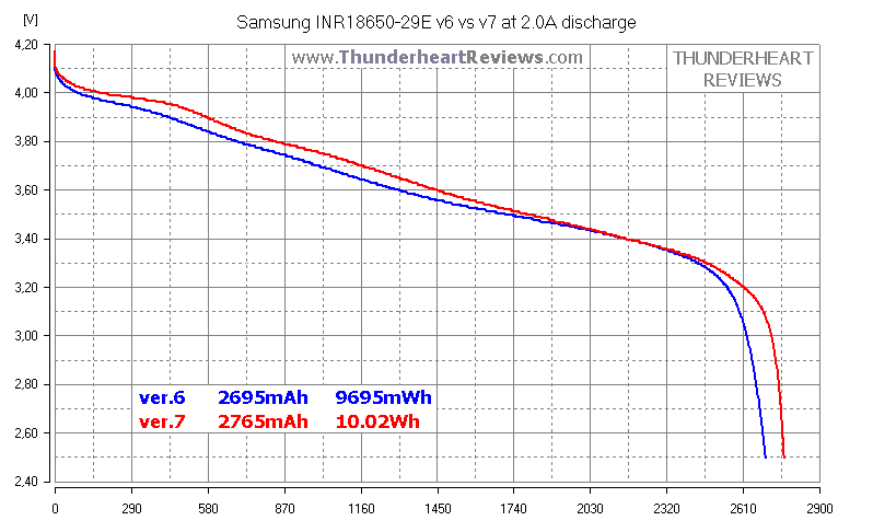

At 2A discharge:
The difference stars to rise and 29E7 shows 70mAh higher capacity and 325mWh in energy. Again, 29E6 curve doesn't look as linear as 29E7's.

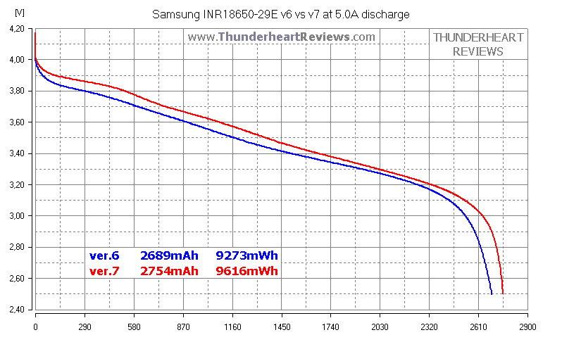

At 5A discharge:
29E7 proves that it's the better cell. 65mAh in capacity and 343mWh in energy is not a huge difference but it exists. Both curves look good and it's not easy to tell which one is better...

So, there was no big leap ahead but it's clear that Samsung 29E7 is a better cell than 29E6. Version 6 has slightly lower capacity and energy and nice curves, but version 7 has even nicer ones, almost ideal i'd say. If i had to choose between two versions i'd take v.7 of course.
