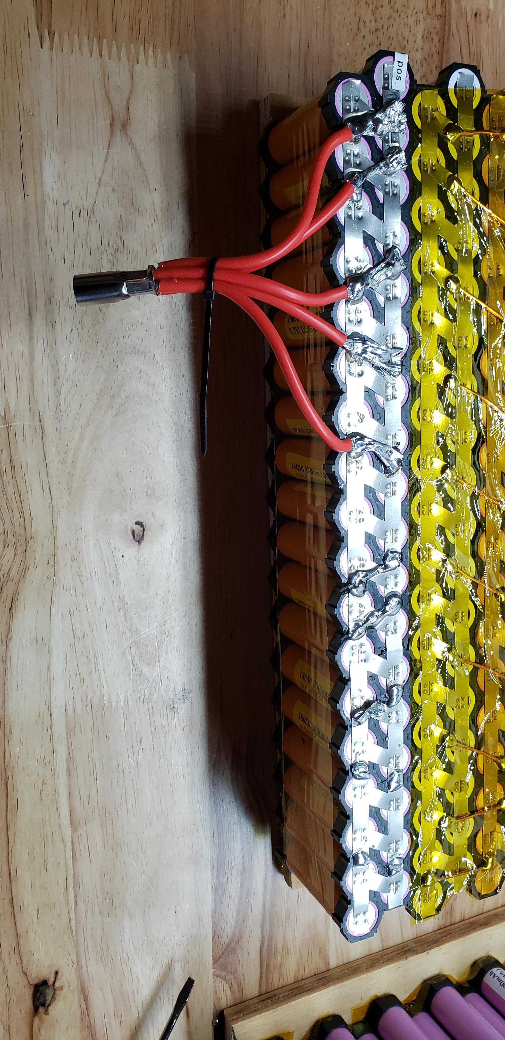

I had everything planned out and ran into some complications with the individual cell wiring during the build. The original plan was to wire each cell to a copper bus bar via 16AWG copper wire. Then, the series connections would consist of 5 short pieces of copper bus bar to bridge between the bars handling the parallel connections. Here's an example of the bus bars I cut and soldered - note that the copper wiring to connect each cell to the bar isn't shown. This is one bus bar assembly that connects the + side of a 36P string to the negative side of the adjacent 36P string.
The problem came up when I tried soldering copper wire onto the bus bar. The bars soak up too much heat, and I can't get them hot enough to melt the solder - even with my Weller 240W soldering gun. I soldered the bus bar assemblies with a torch, but obviously I can't do that on the pack itself!
Specifically, the problem is attaching these wires to the copper bus bar. In this photo, I tinned the copper bus bar outside with my torch thinking it would help the solder melt with my soldering gun, but when I went to solder the wires onto the tinned copper, copper just disperses heat faster than my soldering gun can warm it.

Hi David,
do you have a spot welder?
For 200A and 36P (in your case 18p x 2) it would be be sufficient using one big nickel strip with 0.15mm and i think even the one you have would be already enough (if it is pure nickel with 0.15mm).
The distance the current has to flow through those connections is so short that it will not add much to the total resistance of your battery (voltage sag) and you won't notice if you have 1% or 0.5% lower resistance.
On + and - side i would solder 13AWG (or 2.5mm) to the nickel strip beween very second cell or so, all with same length, so you would have 8 in parallel put together.
Using those large copper bars is totally overkill IMO and if you solder on the cells for too long time you might do nothing good and get other problems later.

Thanks madin88. I do have a spot welder (the cheap DIY one from Banggood), but I am planning to get a Kweld unit if the DIY one doesn't work out well.
The strips I have are in fact 0.15mm, but they were actually 4P strips that I cut in half for the visual example in the pictures I shared. I will have to acquire some 2P nickel strip to spot weld. I'd prefer to go with the thicker 0.2mm to support higher outputs in the future. Should I use solid nickel strip that is wide enough to cover the 2x18 row, or should I acquire honeycomb style strips with the cutouts that help make spot welding easier? I completely understand the difference in capacity capabilities and how the honeycomb style strips will have more choke points for current flow.
You make a good point about using multiple 13AWG wires. I see that 12 GA wire is good for up to 25A for short runs, 13 AWG is likely around 22-23A, and 8 of them would allow for up to (22 * 8 ) = >200A of current to flow across the series connections between the rows of + and - terminals.
I agree that the original copper bar idea is extreme - even laughable, now that I think of it! :lol: I just read spinningmagnets article and he suggests to never solder onto the negative terminal. Well, any damage is already done, so I'll have to either try spot welding onto the tinned solder pads, or removing the solder humps on the cells without heat. Luckily, I only soldered one side of one of the packs, so it's not a huge mistake.
Thanks for your input! Your idea seems obvious now that I'm looking back at it - I was so focused on the large amount of current from my load calculations and over-engineering the wiring.

One option might be to solder nickel tabs to the copper busbars and spot weld the tabs to the cell tops.
Gents, thanks so much for your feedback! I cleaned up the terminals on the side of the pack that I pre-soldered so I should be ready for spot welding nickel strips now. I was weary of using heat to remove the solder from the terminals, so I used my Dremel with a cutoff wheel to clean the terminals up.
I had trouble finding 2P honeycomb 0.2 x 19.5mm pure nickel strip, so I ordered some direct from a manufacturer in China. I'm waiting on that to arrive and then I'll be able to proceed with the build.

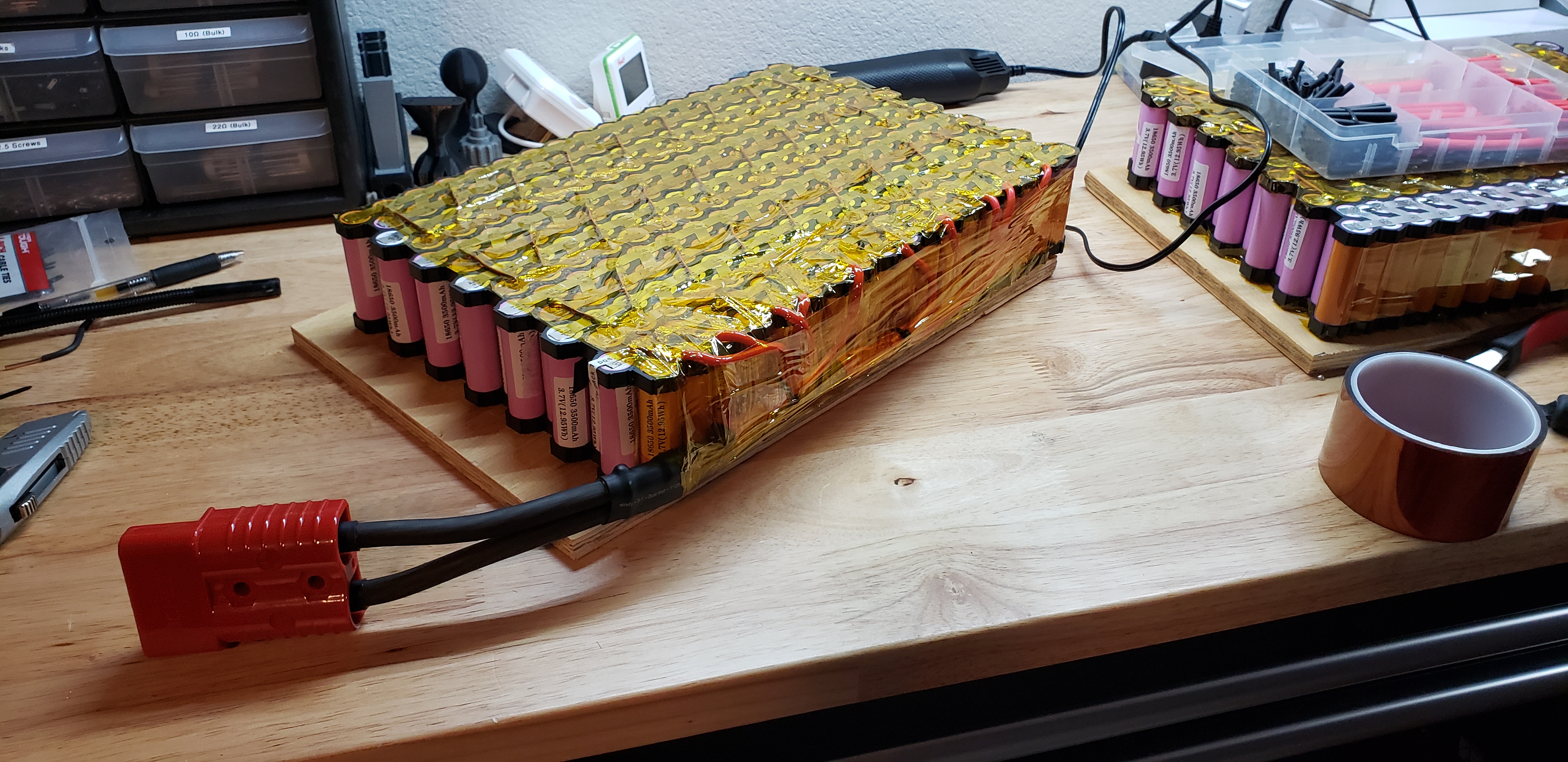

I wanted to follow up with progress of my build so that this thread can hopefully be of value to others in the future. I do want to preface this that I am an amateur and there are likely many areas where I could have done things better, and I welcome any and all feedback and criticism so I can improve my technique for a possible future build.
So, I received my 0.2mm nickel strip and went to try spot welding it... I was powering my cheap banggood spot welder using a brand new motorcycle-sized 12V lead acid battery but it just didn't have the juice. So, I just decided that I have way too much spot welding to do to *** around with cheap tools, and I ordered a K-Weld unit along with a 11.1V 3S 6Ah 80C battery pack from Amazon. This spot welder and battery combination worked wonderfully well, giving me between 1150-1250A of current in each spot weld for up to about 275 spot welds before its current output began to drop off. I was able to get about 10 spot welds in a row until the spot welder's leads and battery pack got too warm for comfort, so it was a slow process.
Without further adieu... here are some photos of the build progress. The entire album is here and contains some detail about each photo.

Awesome! you're doing about the same thing that i am going to do, but you are building your pack to be able to draw a bit more current than me. I am just going to take max 2,5kw (will use maybe 2kw) and you will as far as i understand it be using 3.2kw (120x30).
I will follow your build and post my own when it's time! I like your idea of copper rods/cable to connect the paralell packs, and especially at the positive output cable. i will need to concider that myself. i will need to draw around 50A per unit, so a little less than you, but still a very interesting idea!
cheers! =)
Wow! Very aesthetically pleasing workmanship. Great welds, soldering, crimping, attention to details.

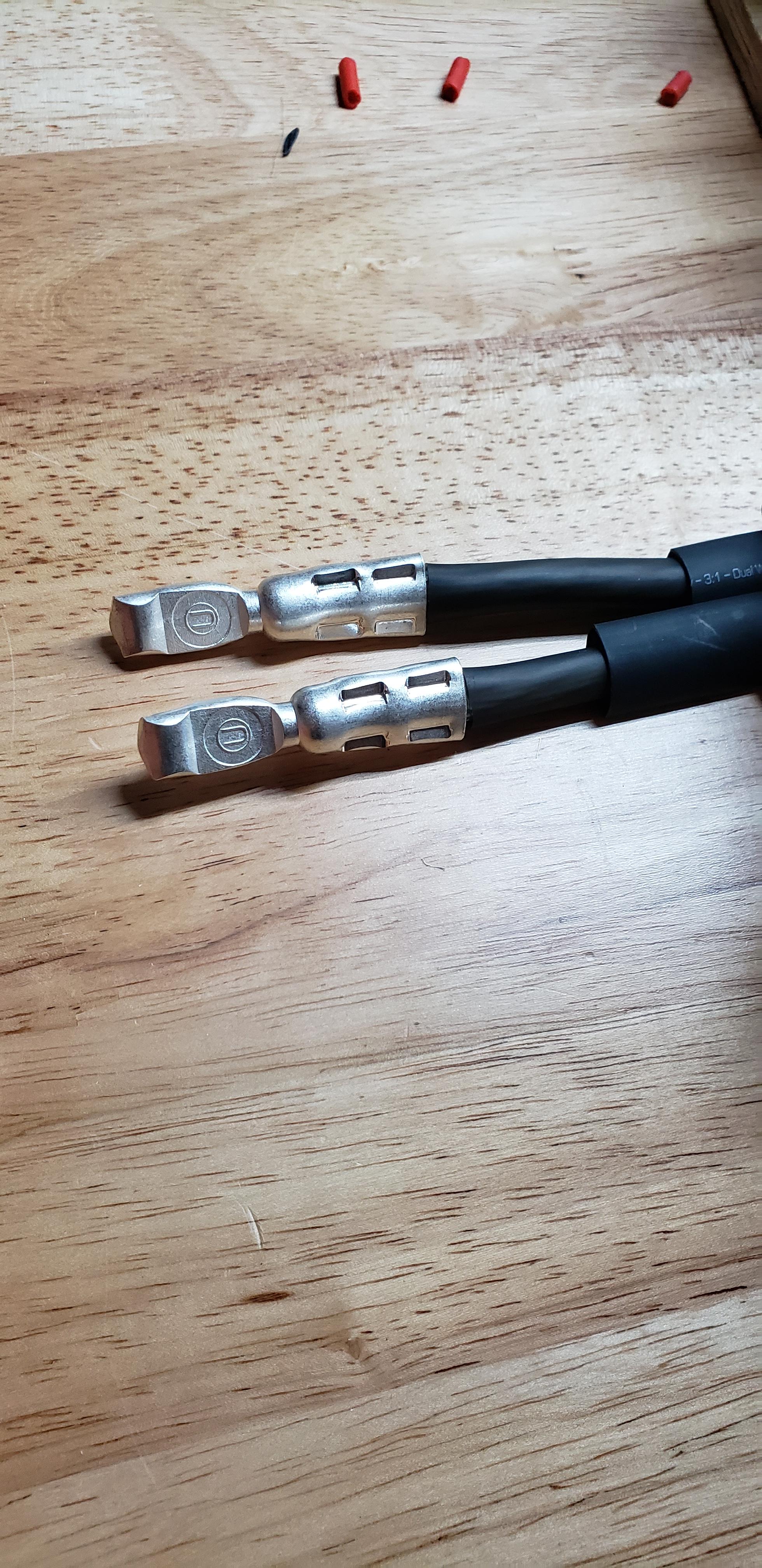

What crimper did you use for the Andersons? How does it compare to soldering them?

The crimper I used is a 10-ton hydraulic crimper with a set of hexagonal die. $50-60 bucks on Amazon and it actually works quite well. I preferred crimping the connectors on instead of soldering them because I wanted more mechanical strength from the joint. I've soldered 2/0 awg connectors in the past and it is much trickier, requiring a torch, a LOT of solder, and lots of caution. However, with this battery build project, I'm concerned about thermal expansion and contraction over the 7-10 years I predict the battery will last, so I wanted to eliminate any possibility of major connection points coming loose.
Cool -- $50-60 -- not great, but not terrible. I worry about my preferred eutectic solder on marginal current capacity terminals.
