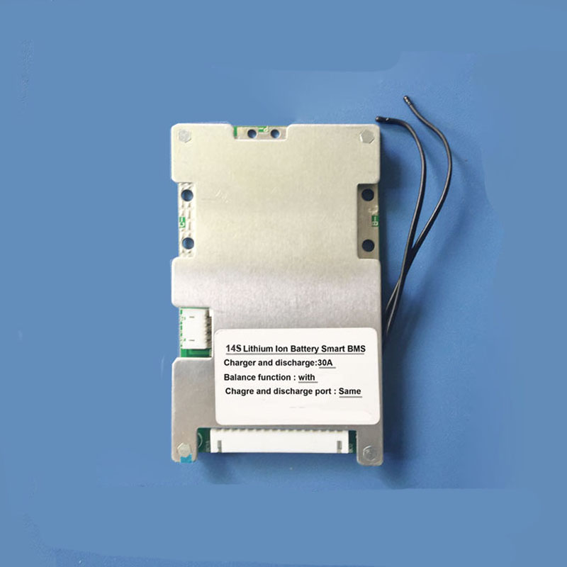

Hello there,
I just joined this forum because i though this would be the right place to talk about what happend to my Battery and BMS. Ive been reading alot here about the BMS ive got before i even used it. Now that i have used it and had it built into my system i have run in to a huge problem and i hope we can discuss about that here and maybe find a Solution.
I have bought the 12S SmartBMS from their AliExpress store and have been using it for many months now. At the beginnin everything seemd to be working perfectly. Charging, Discharging, Balancing were all fine. But now that the Corona Lockdown hit me, i were not able to use my device so it was standing unused in my room at about 44V Battery Voltage. After 3 Months of not using it i decided to start some work on it again and checked the Battery. I had to find out that the Battery was completely drained to 2.3V. So my 12S3P 10Ah Li-ion battery is now dead. I were really pissed because i thought a BMS should prevent exacty this....
Im Pretty sure i connected everthing the right way so the only thing that could drain the Battery could be the BMS itself. It is rated for a Sleep current 200uA which could never deplet the battery so much. I guess there was a problem with the BMS not entering Sleep more and therefore draining up to 20mA current.
Is there a specifiy way i should measure the BMS`s Idle current without a Battery? Maybe i could connect 44V from my Bench PSU to 12 Resistors in series to simulate the individual voltage cells.
Did anyone make some measurements of the BMS`s sleep current or has similar experiences with that BMS?
I think once the Lockdown ends and i will visit my local hackerspace again to Spotweld a new Battery. But before installing it i should have some safety mechanism to prevent the BMS from draining the Battery again. How would you go about that? Maybe just a Switch between the Batterys 0V and the B- Port of the BMS like in the Picture ?
Im not 100% sure if that would help since 0V it still conencted though the Balancing connector.
I tried contacting lithiumbatterypcb but atm they have the new years holidays in china so it will take some time for them to response.
I would be really happy if we can discuss about my case a little bit here.

Well, I am not familier with your BMS, but sorry to say your story is an old one around here. BMS's being connected to a battery for a long time and draining the battery has happened many-many times. As you surmise, disconnecting the BMS for battery storage is the way to go. Either by switch (make sure your switch can carry the amperage needed) or by an adequate connector. Although, and I may be wrong on this, but I believe you must also disconnect the positive or negative sense wire to make sure there is no circuit connection to the battery.
The other option is to have it connected to a charger all the time to keep it topped off, or possibly having a timer between the A/C outlet and the charger set to go on for something like 12 hours once a week.
Anyway sorry about your battery.
Just to be sure...is that 2.3v per cell?
Or 2.3v at the BMS discharge output?
Or 2.3v across the entire actual cell section of the battery pack, from main cell + to main cell - (not measuring at/across the BMS)?
I ask because it's common for people to check the BMS output voltage and find it's "dead", while the cells themselves are only down to about the regular LVC 2.8-3.xV, when measured directly rather than at the BMS discharge (or charge) port, and the BMS output reading is only because it has shutoff the output to protect the cells from overdischarge, and then shut itself off.
But sometimes the BMS doesn't *have* a shutdown mode, being a "dumb" BMS, and always has the same drain on the whole pack to power itself.
Sometimes the BMS balance channels don't fully shut off, ever, and it continues to drain all cells very slowly.
Sometimes one (or more) channels get stuck "on", and drain just the cells in that group (probably not what's happening here).

Across the whole Batterypack without measuring the BMS. So + of the Top cell and - of the bottom cell.
So Cell Voltages were about 0.2 Volt per Cell.
BMS Product Page
BMS Specification:
@amberwolf
about the BMS not having a sleep mode or channels not shutting of, well... i think that *should* not be the case with my BMS, like seen in the specification there is a sleep more with rated Current consumption. So i am still pretty sure it was a fault that the BMS somehow did not enter sleep mode.
Yowch. Yeah, that is a very toasted-dead battery pack. :( Can't even recharge the cells to revive it.
Could be it's software crashed and locked up the MCU, or some other hardware defect or software bug. The other guy's result means it shouldn't be a global issue with it...so you were just the unlucky recipient of the fried guineapig award. :/
