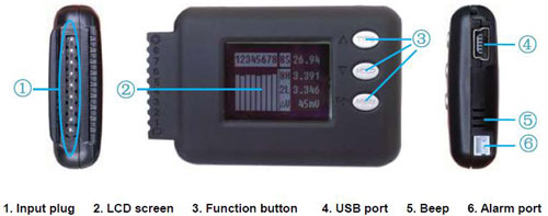

Great little device for monitoring cells.
Features include,
Bar graph display,
0.001V display,
Various configable alarms, including cell low voltage alarm,
Alarm port ( cutout for throttle or controller?),
and can log voltages for each cell.

Start up screens and tone.
What I have done here is disconnect the black lead , pin 1, from the pack and reconnect.
It should be possible to put a switch on the pin 1 lead and use it as a on/off switch.
I have got no way of measuring any current it might be drawing from the pack when off.

Example of the error tone and bar graph display.
I put a pot on one of the leads. This triggered the >500mV cell difference alarm.

For 8 cells, it would have to be a 9 pin connector, not a 7 pin but it looks like you can fit in a 7 pin connector. If so, you should be able to monitor any 2s through 8s battery.

The current is minimal - a DVM between gnd and pack gnd will reveal power levels consumed at various screen brightness... if you use a 3pst you can connect GND from each pack (or parallel of packs) and then toggle the switch on and off connect / disconnect the CellLog8 - this could also be fully automated. I will explain this later in more detailed instruction. The current drawn with the gnd pin interrupted is 0 a
Ideally... these would come on and off with the main ignition system so they were only in use and powered when the bike is being used... additionally they should come on when charger port is energized (still need a precharge resistor for these meanwells too.)

The CellLog is powered by the pack being monitored. It has been reported however that the power is is not shared equally by all of the balance leads which can lead to a cell inbalance if left connected for long durations between chargings. Junsi has recommended a specific modification remedy for those who it may affect. Here is an informative thread about the CellLog from the RCG forum:

I fried the middle CellLog that monitors cell#9 to 16. Before I plugged the monitor, my 22s pack is switched to 11s x 2 for split charging. Heard a spark and a message "err:cell volt" appeared on the screen. I tried connecting it to a 3s pack and it displays some false info - shows 4 cells, instead of 3 and low voltage on the 4th cell).
I think the CellLog cannot handle a little power spike, even though my 5p subpacks are protected by 1A resettable fuses in the balancing wires. This happened even when pin 1 is not connected - 3pdt switch is off. So I just do away with the split charging switch, have to rewire the power-on(+) wire of the CA to my Key switch so it won't be always on. Fortunately, I had a spare to replace the damage unit.
I guess the manufacturer assumes your using it for your R/C batt pack where the cells are already connected. Will my warranty cover it? I don't see any warning about this in the manual.
I have connected the CellLog8 both prior to series connections of 3x5S packs but also after and have not had any issues with voltage spikes.
Your length of wire running from the CellMon8 may be partial cause - more current, longer run.
