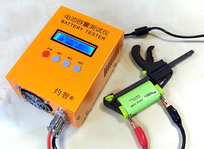

Hi guys! I've tested two high capacity 21700 cells - LG M50 (5000mAh) and Samsung 48G (4800mAh). The latter i had already tested before and the re-testing of another cell showed almost no difference with previous test results. The M50 is a new cell which is being sold as 10A one, but in its datasheet the maximum discharge current is mentioned as 7.28A. Nevertheless i've also discharged it at 10A to look at it's behavior.
The cells i've bought from Queen Battery.
As always, I've tested with ZKETECH EBC-A20 and a self-made battery holder. It's a PC-connected battery tester supporting 4-wire measuring and discharging at up to 20A.
I've followed all the prescriptions of the IEC61960-2003 standard concerning battery's capacity measurement. Before each discharging cycle each battery was charged at standard current mentioned in its datasheet to charge end voltage (4.2V) (cut-off at 0.1A, which is the lowest supported by EBC-A20). Before each discharging or charging i've held a 1-1.5hrs pause. The environment temperature was about 25°C.

Great results - 5104mAh/18.44Wh at 0.2C (0.97A) and almost 5000mAh at 5A! Even at 10A, which is way above the declared maximum (7.28A), the M50's curve looks very nice. I think it's a very capable cell and LG shouldn't limit the discharge current by 7,28A.

Both cells are surprising with their results, but i liked the M50 a bit more than the 48G. I don't understand why did LG limit the max discharge at 7.28A, because it handles 10A easily. Of course the cycle life won't be the same as at 7.28A, but nobody expects a great cycle life at max rates. There is also LG M50 Grade A cell, which was unavailable when i was making the order. Does anybody have any official info about the difference between Grade A and Grade B M50s?
