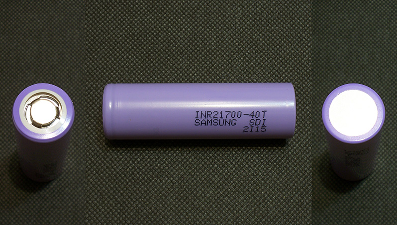

Samsung INR21700-40T
The cell is marked as INR21700-40T SAMSUNG SDI 2I15 which means that the production date is 05 Jan 2018.

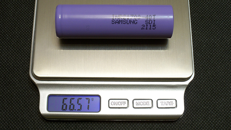

Measured weight of the tested cell was 66.57g
