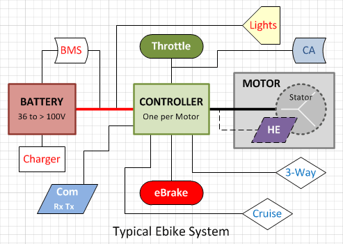

Block Diagrams
This is a block diagram of a typical ebike controller with standard features. The Hall-Effect sensors (HE) are optional or not present in R/C motors.
High-level block diagram of the proposed 3-Module design.
More diagrams will follow shortly as we flesh out the details.
EDIT: Images slightly updated on 2010-08-20.

PCB Module Common Interface
Still in discussion.
Briefly:
Briefly:
- One common interface connection to "rule them all"
- Sub-connections or circuit groupings in parallel are possible. Tenative considerations are:
- Common Power Connection, isolated
- Common Features/Signals such as Throttle, EBrake, etc.
- Motor Phase Signals (one to many; tbd)
- Future expansion (leave room to the right of the connectors)
- Connector will probably follow typical 0.100-inch double-row layout convension
- Connection between boards secured through hardware fasteners
- Shielding/plating tbd
- Shared Serial Interface
- +12V, 2/3A
- GND, phat!
- +5V (or 3.3?) for MCU
- System On: Bool, default (0) = Off
- Rev: Bool, default (0) = Forward
- Brake: Bool, default (0) = Off. Alternative: Analog feedback input instead of Bool mated with Throttle.
- Throttle, common (0-5V); When Brake = 1 then Throttle is progressive Brake/Regen.
- Alarm: Bool, default (0) = Off
- Cruise (tbd)
- 3-Way (tbd)
