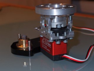

As for mechanics so far

Nice work!
But why the piece of pipe wrench and not machine the aluminum part smaller/direct fitting the hexagon nut?
No such machine park accessible for me, sadly
Exorbitant costś and delivery time of pro-shops for custom machined parts are the second reason.
I hope though, others will chime in and possibly provide their expertise and skills to improve where I fall short for one reason or another, so everybody will profit from what I'm just about to start from scratch
Again: why not have the machined part with the hexagon female hole fit directly to the male hexagon part? Why the piece of pipe wrench as adapter? Is the shiny (aluminum/SS?) part an "as is" bought part?

Ah, now I understand. Sorry
You may have missed the link given above:
https://www.robotshop.com/uk/actobotics ... unt-e.html
So yes, the rectangular off the shelf aluminium part was turned down to roughly 25mm outer diameter to fit.
As the outer diameter is not any critical, one could even simply sand it down.
No big deal and easy to do especially if you also order :
https://www.robotshop.com/uk/actobotics ... b-1-2.html
and a set of those imperial screws that drive you crazy when used to metric system.
https://www.robotshop.com/uk/12-6-32-so ... -25pk.html
https://www.robotshop.com/uk/38-6-32-so ... -25pk.html
That I found that the imperial hexagon female part exactly fits the outer shape of the metric 8mm tube wrench was pure luck.
All this parts from the Robotshop follow the same system and easily fit together, which on the other hand is nice and handy.
