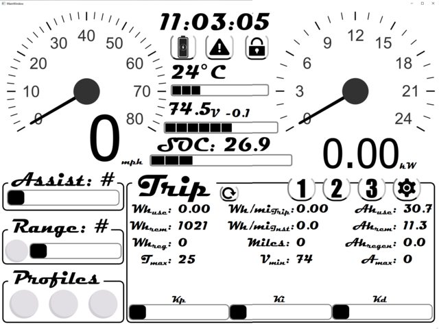

The problem: Generic displays like Kingmeter/Bafang don't display all the info I want. The amazing CycleAnalyst could replicate every function I want except for on-the-fly retuning of whole controller profiles, and would require an external shunt. This is my endgame zero-compromise bike, so, that's not quite good enough :lol: I really want to retune profiles... I have to be able to quickly change field weakening and phase current, if I want to have max power quickly available yet not sacrifice efficiency all the rest of the time when I don't need it. Currently there is no convenient way to do this for ASI but the capability is there. I also want trip functions so I can quickly ballpark my range and self-regulate, and have a trip limiter to guarantee I arrive at my next charge. I want all features fed by ASI's serial interface so I can use its internal shunt, and all associated sensors. It even has accelerometers that could be used to detect a crash and commit a dashcam recording!
Hardware: Raspberry Pi4 with a build of piCore, a fork of tinyCore linux that is exceptionally minimalist and runs entirely in memory for fast boot times, zero risk of SD corruption from abrupt power loss, and plenty of remaining overhead for development of other functions like a dashcam logger with auto-backup through local wifi, a lowjack tied into the controller antitheft and and a horn/alarm, etc. The Raspberry Pi Zero W is more than powerful enough for display functions only, but I'll be testing on a Pi4. For sunlight readability I've chosen a 7.8 inch 1872x1404 Waveshare e-ink display and capacitive touch overlay.
With the PyQT5 gui, the simple GUI app QT Designer can be used to arrange or style widgets as desired. Then, the command-line tool pyuic5 converts that .ui configuration to python that can be interpreted by the app. I will eventually make a few other .ui's configs for smaller displays, if there is interest.
The gui test;
Base GUI widgets:
  • Time of day
  • Battery SOC (by comparing pack voltage to Li-NMC SOC:voltage curve, not ASI's linear approximation)
  • Peak voltage drop over x seconds
  • Controller fault codes
  • Instantaneous wh/mi
  • Trip average wh/mi
  • Trip total wh or ah
  • Trip distance
  • Estimated range
  • Speed (mph default, analog gauge + text)
  • Power (kW, analog gauge + text)
  • Trip range slider (limit peak power to ensure a minimum range)
  • Profile selector (retune any number of controller variables, between three profiles. For example, to enable/disable field weakening or adjust phase current from a reasonable thermal limit, down to saturation limit, to optimize either efficiency or max power)
  • Digital assist level selector (If using torque sensor or PAS, allows you to control the digital assist level from the display)

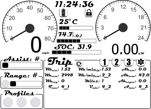

Now that the MODBUS issues are sorted development is actually moving again. Polling rate is 6x faster than BacDoor datalogging (16ms). New git commit has most of the features that anyone who wants a smaller display could use. Still playing with the design, now monochromed for e-ink. I do still have to implement PID control for the minimum range function and will do some code cleaning before mapping the last few trip labels, and implementing permanent storage of trip statistics... but this part is nearly done. Hoping to get it running on the Pi before new years. :mrgreen:
The state-of-charge is reset after charging with the battery icon under the clock, by mapping the battery voltage to a cubic spline fit from the experimentally derived voltage/state-of-charge curves for the 30Q cell from lygte.com, the fit is generated from a replaceable 'socmap.csv' with many voltage:soc points so it can be easily swapped for different chemistries, just as the parameter dictionary can be swapped for future ASI firmware. This is much more accurate than the linear approximation of the controller itself, but for best accuracy should be reset a few minutes after charging/discharging. Once set, the SOC is calculated from the battery Amp-hours.
I was originally adding a new integrand of Amp-hours/Watt-hours to the trip/lifetime counters every 16ms read interval, but after comparing 3 hours runtime with low (~1 amp) current, found that floating point rounding errors even for long-double floats (128-bit) resulted in 0.8% underestimation of charge/energy due to the very very small values. This was corrected by integrating only when the display is refreshed, the accuracy is now within 0.03% with a 250ms update interval!
When fault codes are detected on the controller, an extra check-controller button appears between the battery and lock buttons under the clock, that when pressed creates a popup listing the fault codes with the option to ignore or clear faults.
I implemented a trip selector to change the statistics displayed in the trip widget. I won't really need it for my gigantic display, which will fit every trip statistic I am interested in seeing while riding except lifetime stats and diagnostics e.g. hall and input voltages, but it would be handy if you want a smaller but full-featured trip stats widget for smaller displays.
To avoid loss of stored trip and lifetime data in the unlikely but possible case that power is cut during the few milliseconds it takes to write them to the SD, I'm first pickling the MD5 hash and date-time that the save begins to the SD, and saving to a rolling rotation of several files. When retrieving data on start, only the data corresponding to the pickle with the latest time and valid hash is parsed. This way it will simply avoid a corrupted file and fall back to the trip/lifetime stats from several seconds earlier.

Latest work log update-- software is golden, the next step is to setup PiCore with all the appropriate dependencies, libraries, drivers, etc and create a shareable image. I can officially say I've moved into the Beta phase-- all features implemented and optimized, no apparent bugs. With a bit of luck I'll be posting an IRL demo of probably the most obsessively precise and versatile ebike display anywhere within a few weeks! Highlights;
1. Improved remaining Watt-hours prediction formula, now it is dynamically integrated from the entire voltage:charge curve of the cell instead of simply scaling according to SOC like is usually done. Actual watt-hours will still depend on how much power you're using and this prediction will mirror 'rated' pack Watt-hours. Unlike Amp-hours which measure charge, Watt-hours of energy produced actually depends on how much power you're drawing so it's impossible to perfectly predict, but this is as good as it gets and should help with accurate range prediction and with the minimum-range power limiter PID function.
2. Improved accuracy of vehicle speed reading; I realized that reading the speed from the controller is considerably less precise than reading the RPM, integrating that into revolutions, and calculating distance from revolutions based on wheel diameter.
3. Implemented an SQLite database for logging and recovery of all trip, lifetime vehicle, and setup options e.g. last selected profile, assist level. SQL is transactional so there is a 0% chance of corrupting data even when power is suddenly cut ("atomicity, consistency, isolation, durability" e.g. ACID compliant). The lifetime vehicle stats are setup so that it records a bunch of parameters for each cycle, as you continue discharging the row is updated, then when it detects that you have charged it flags the row for permanent storage and creates another. So this enables all kinds of interesting statistics, e.g. the depth of discharge, distance traveled, regen stats, and date of every pack cycle while remaining a very small database... for 20,000 cycles it would be ~1 megabyte, all other records limited to ~800kb max. Changing a single value of the window class (iter_attribute_slicer) enables complete logging of all data to the trip statistics SQL table, at 6x as frequency of the ASI BacDoor apps (16ms vs. 100ms)-- otherwise, certain data not needed after incrementing the trip counters or generating averages for certain displayed stats is overwritten in a rolling 5-minute interval.
4. Setup keyword arguments for certain vehicle-specific parameters that it needs to function properly. With the revolution-based speed reading and all the functions depending on the high-resolution state of charge map, these now include; battery series groups, battery parallel groups, battery amp-hours, and wheel circumference. There is also a flag -speedparse that assumes v6.++ parameter addresses that saves some CPU time by reducing lookups although, with many other optimizations to speed I've made since profiling it this is not really necessary. Just want to see if it affects running temp of the Pi. The purpose of these arguments is so that different users can set these parameters easily by changing one line from the startup.ini on the pi without having to touch the code, e.g. 'python main.py -battseries 21 -battparallel 14 -battah 42.0 -wheel 1972.3 (mm).
5. Since the range power limiter PID function will depend on numerous vehicle-specific features, I set up a second UI file that can be used to manually tune the foldback. Back when I had an Adaptto controller I LOVED the range limiter feature, but was frustrated that it would allow me to exceed the range-permissible power and would often overshoot for seconds, then undershoot for about the same, time, before eventually stabilizing. With the exceptionally precise speed and power calculations and ~30ms cycle time with the range limiter engaged, this should be able to taper power down without exceeding the appropriate Wh/mi even if you setup a fast torque rise time (I'm using 100ms on my controller)
6. The very latest ASI firmware (6.015+) adds some new features that allow pullup resistors to be enabled on the PFS/Cruise inputs. So now it's possible to enable antitheft directly via serial, instead of having to wire in an extra GPIO and 3.3v->5v level shifter to one of these inputs. Once I get the new firmware I'll be testing this out.
7. I've configured the "analog" speed and power gauges so the solid border visible in previous photos is drawn only to the current needle position, serving as an additional value indicator. If you use a color display you can set color gradient ranges as well, e.g. green 0-40mph, yellow 40-60mph, red 60-80mph...
The recently released firmware adds some other features that I am excited about too, like a Features3 bit that forces the throttle input to disregard Assist level limits, so I can have e.g. 24kW at the throttle and only 3kW from the torque sensor simultaneously. So the modest 'Assist' levels will limit the torque sensor, and the vehicle-wide 'Profiles' I've setup will limit the much greater throttle power.

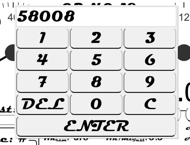

The options pane has a button to brute-force unlock the access level codes of your controller, displaying them as they're unlocked and writing them to the controller and saving them to an 'access-codes.txt' file. Took about 90 minutes on my controller, max theoretical time is ~8 hours. I also added more tuning sliders, now you can scale % field weakening, % rated battery current, % rated motor current, enable/disable Engine Braking, Walk Mode, Throttle Bypass Assist Levels, and setup the rangelimiter (on/off, distance, PID tuning). The diagnostics poller is now setup and displays voltages of all analog inputs, and lists states of all digital inputs, 'ebike flags', warnings, etc. for troubleshooting and debugging.
